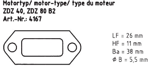

Friend of mine told me that exhaust header forZDZ 4O RE is the same as PTE36R except dimension HF (see picture)
Dimensions HF of PTE36R is 15 mm.
Header :
I think it's easier to machine it.
http://www.troybuiltmodels.com/items...HEADER-25.html

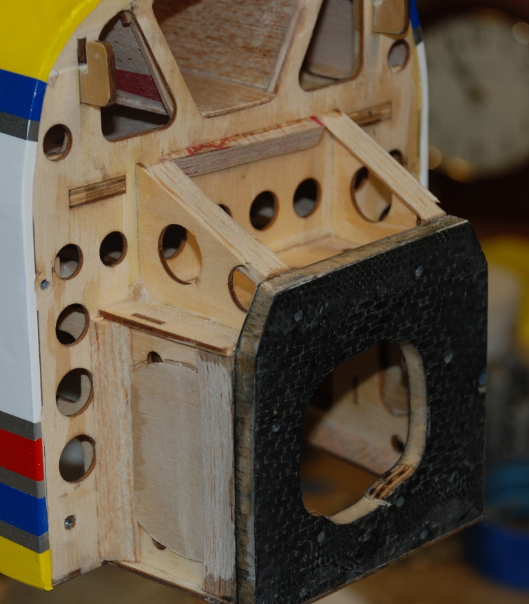

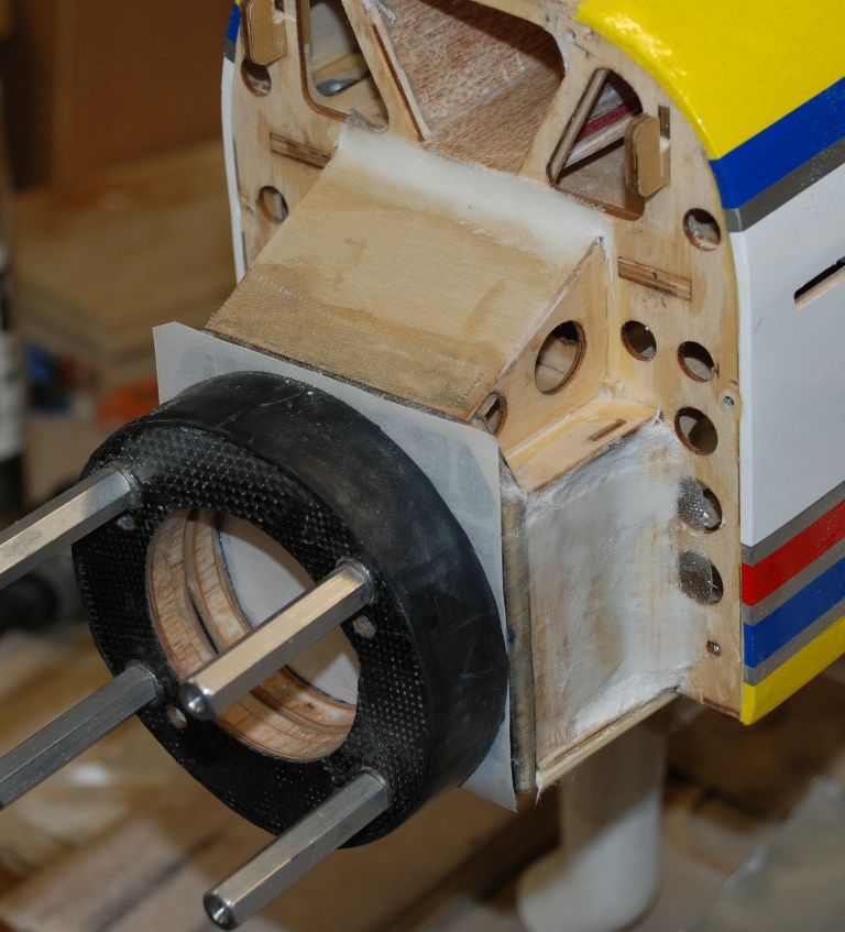

Here are a few more photos of the structural conversion. Triangle stock placed in strategic places. Then 1 layer of 4 oz glass epoxied around the firewall and the box sides, as shown.
The added lite ply top with cross members will keep the top side from flexing too much
All holes in the front of the fuse will be covered over with paper to better channel hot air away from inside the fuse

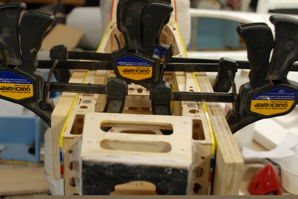

Decided to also add doublers just aft of the landing gear box. This areaonly had a 1mm plywood perimeter as shown in one of the photos.It may not really need any other reinforcement but I felt that with the balsa sheeting only 3mm thick in this area, a bit more balsa is likely warranted.
Added 3mm doublers as shown, recessing the edgesto sit flush againstthe 1mm plywood perimeter frame. Recessing was simple with a sanding block. I probably used more gorilla glue than necessary as shownby the foamed glue around the edges of the doubler

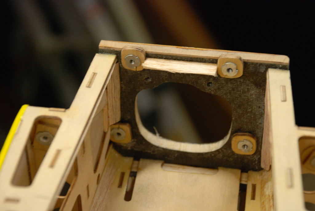

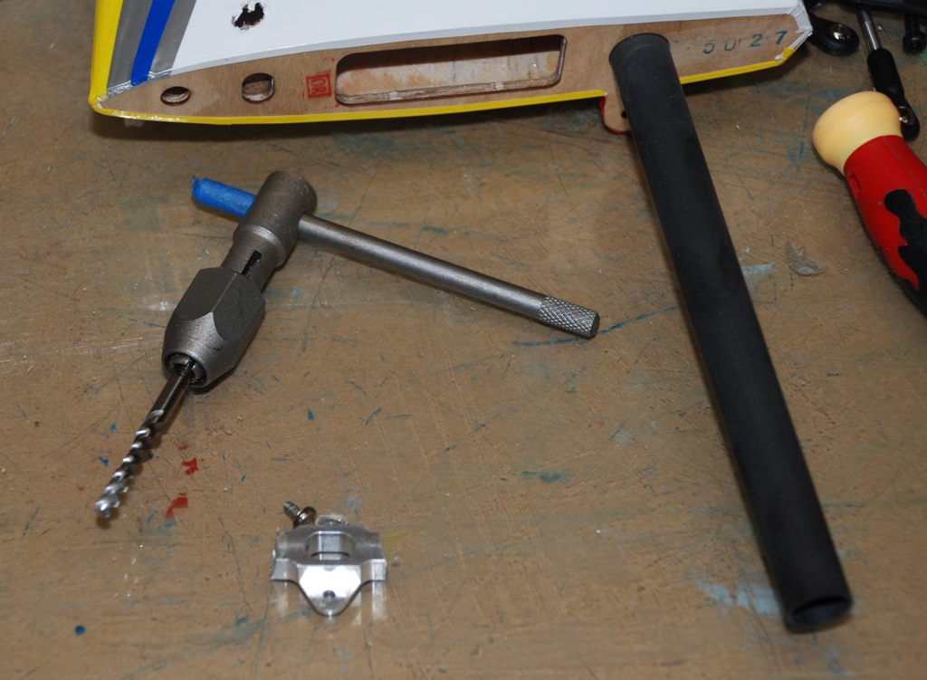

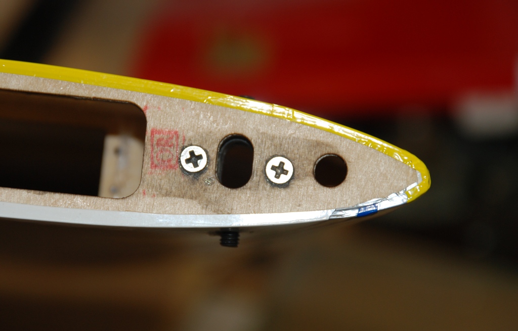

Back to the topic at hand.....During the fitting of the stab I encountered a problem that any of you guys contemplating the Vanquish as your next ride should know about. The set-screws used for stab adjustment would not go in easily so I chased the threads with an M4 tap, The adjustment block inside the stab is aluminum so you don't want to cross thread anything here.
Well, the first side worked fine. Chasing threads is a simple task and should be done where ever one encounters resistance in existing threads, cleaning them up rather than X-threading them
The second side was a different issue..... the aluminum block came off inside the stab. Easy enough to take out and inspect the part. One small screw was allit was held by, plus some adhesive, possibly ca. It just wasn't enough to hold the torque of the tap and popped off.
No big deal and actually I'm kinda glad it happened on my bench. The aluminum block has two mounting holes so I am tapping these for some 4-40 screws and reinstalling the part with a pair of flat heads through the root ply rib. I'll take a few photos and show you what I did

Here's what I did... Tapped the aluminum block. The ears are about 2mm thick so there are enough threads to hold things together. The 4-40 flat heads make for a neat install. Also some JB-weld will hold things together long term

ORIGINAL: cmoulder
Another glow-motor artifact bites the dust.
Thanks for the correction. I should have referred to the photos I have of the model in your original thread.
Bob,
I guess that some e-fuses allow nose access only from the front? That would be a better, stronger and lighter arrangement for an e-fuse. Also, a firewall (if you can call it that) wouldn't needmuch beef to work properly if it was glued as a ring around the whole nose. Makes good engineering sense to me
