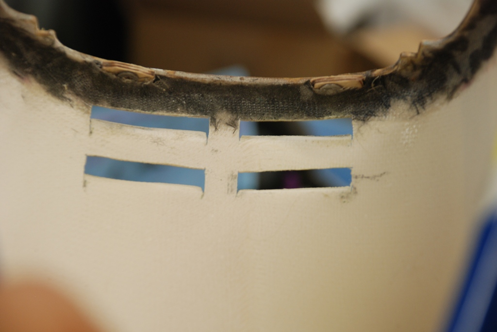

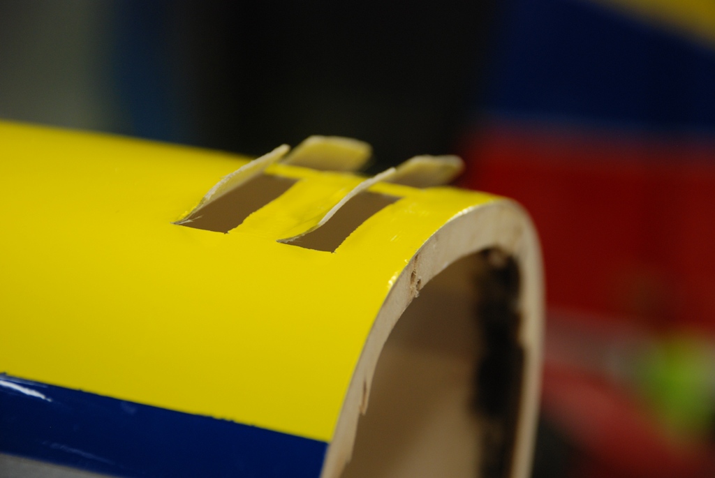

The front holes needed covering. A layer of medium silkspan works fine and adds practically no weight. The side hole is there for the ignition wire
The exhaust louvers on the bottom of the cowl are easy to cut and shape with some help from a monokote iron. Simply heat and bend. That should be all that's needed to get engine heat out of the cowl. A slight negative will be created by the raised flaps thuspulling the air out. A large amount of exiting area is not required; with this type of treatment the old 3:1 rule of thumb for exit to entry area is not necessary.
Talking of cutting, I re-discovered X-Acto saw blades. These make hinge slotting really simple. They are the same width and thickness as a #11 blade, just perfect for Radio South and other ca hinges. Of course they have other uses</p>

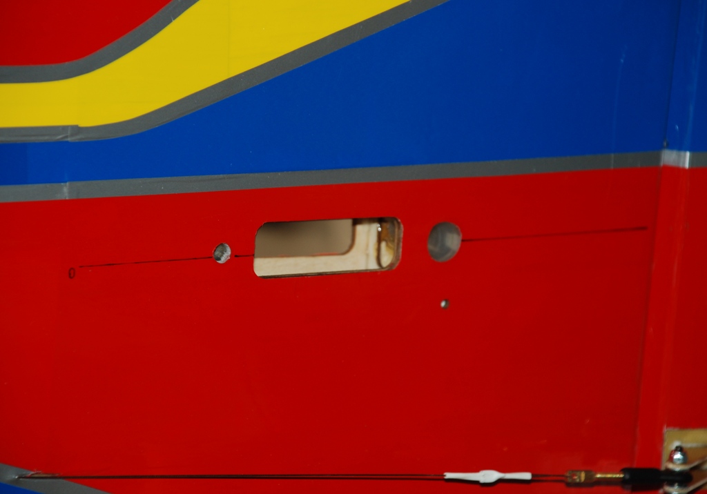

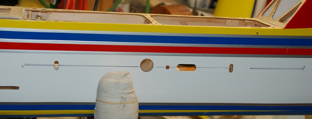

Once the lines are drawn on the fuse side marking both wing and stab incidences, a layer of clear mylar is ironed on to protect the lines. Magic marker doesn't survive the sun long term so I hope to have the thing fully wrung out by the time they fade away. With firewall at 90 degrees (no downthrust), the tail needed to be raised 1/16" from my bench, hence the misalignment on the front stab locator. No biggie......

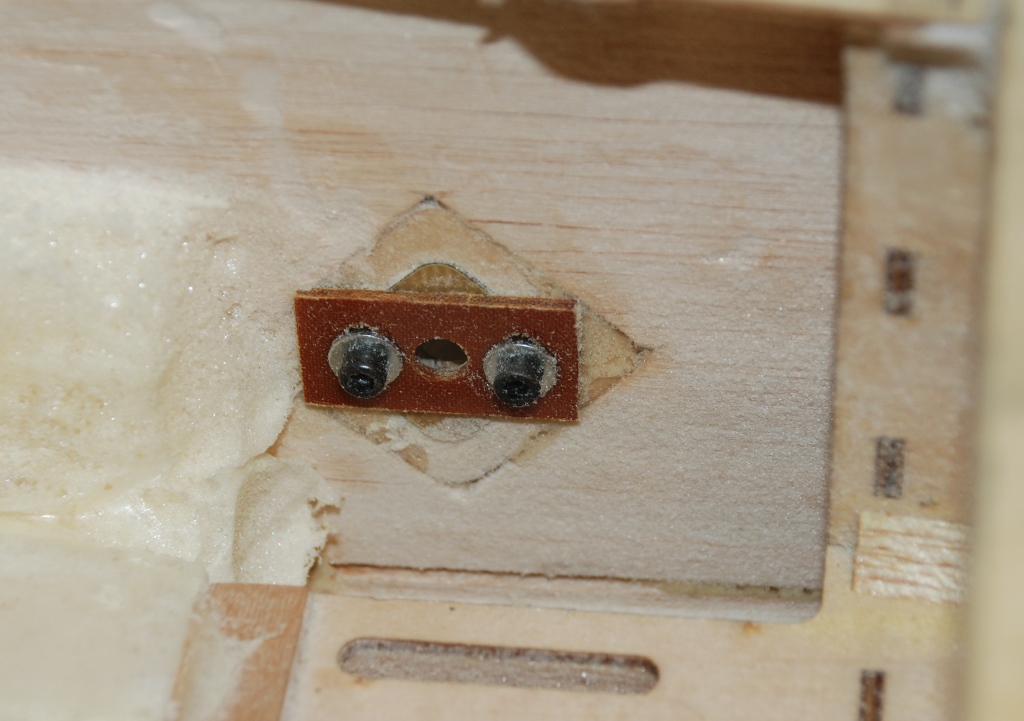

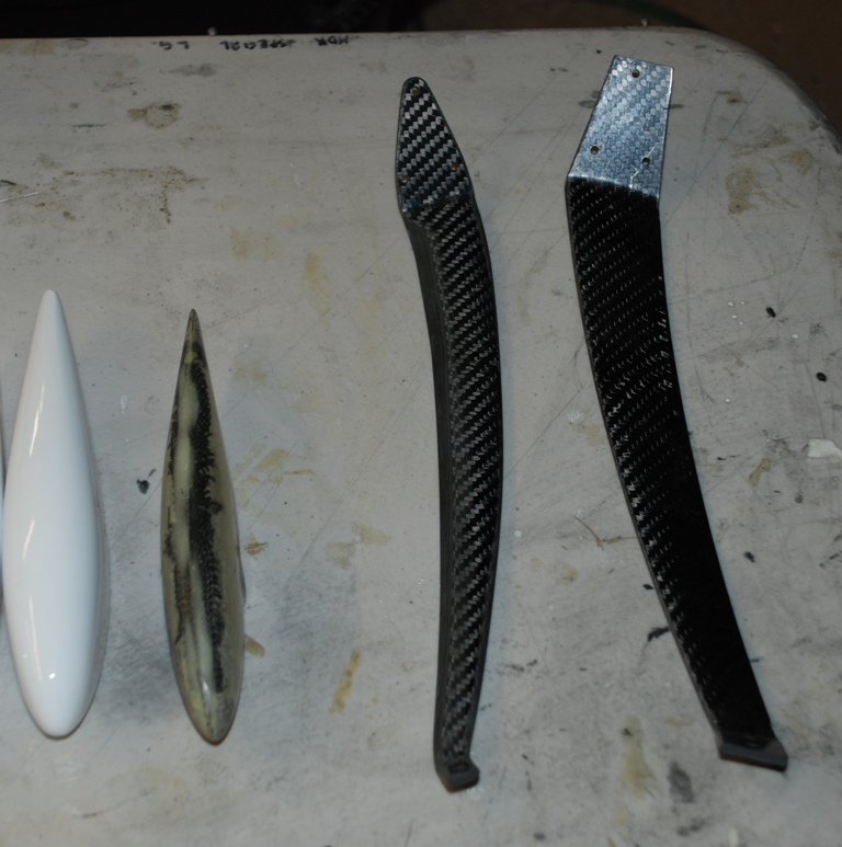

Front and rear phenolic adjusters
Reshaped the gear legs as shown; right was the original shape and left is the reshaped leg. Shaved 1/3 the weight, down to 42 grams. The gear is very strong at 42 grams and overall shape and rear rake are attractive too, so I am making a new mold for these.
The original white pants an left are a bit on the heavy side at 26 grams each. The narrower pants on the right come out of my mold with hard points built in. Alignment is in the mold; weight is a tidy 14 grams ready for paint. Throw in the aluminum axles I've developed for the pant hard points and the weight savings really add up.....
BTW- don't you just hate wheel rattle after a few dozen flights? It seems no matter what you do, you just can't quiet the beasties. Well, I may have discovered a solution. Need a bunch more flights on the wheel set-up to make sure but it's looking good so far

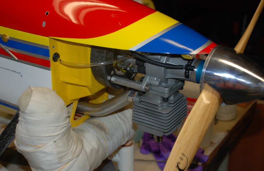

The pipe tunnel and new engine mount box are painted, Klass Kote epoxy. Good stuff
The spark plug cap fits inside the cowl just right with about 1/8" clearance. Like it was made for the smaller gassies

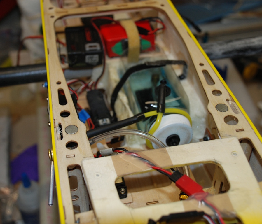

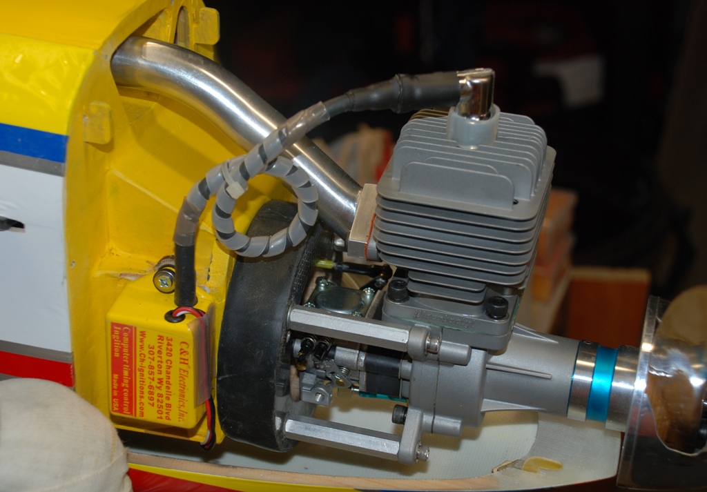

Default RE: Let's gasify a Vanquish

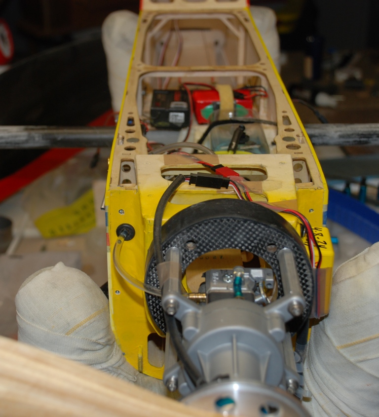

Some of the last photos of the conversion....
The white coloration on the wing tube is microballoons/epoxy to achieve the right fit in the wing sockets. Original fit was juuuust too loose for my liking....
I added a set of screws to hold the canopy down and keep it from vibrating too badly. Canopies make a racket when they are bouncing all over the place.....
The ally stand offs on the mount are McMaster Carr issue, 2" long for 8-32 bolts. I go smaller on the mounting bolts than is typical for these gassies because the soft mount allows that.
The tank is only 8 ozs. It holds enough gas for about 10 minutes. The yellow loop around the tank cap is plastic tubing that's easily formed with some heat from a monokote heat gun. It's a convenient place to locate the vent control which keeps gas from spilling on the plane. Tank and fittings are things I sell along with the PolyU fuel line. Weight savings on the tank set-up is considerable over other types.......
The spinner is too large for this plane but I had the holes drilled already and didn't feel like screwing around with the stock VQ spinner.............
The engine close up at the spark plug shows how I treat the plug caps to keep them from coming off. I lose the spring clip in favor of a thin walled silicone tube. It's been working great.
A relief loop on the plug cable is a good idea if you have the room. It worked nicely in this plane..............
Note the mounting tabs on the CH ignition module. Simple, effective gromets already built in..........
I think the little platform that EF puts into the VQ right over the wingtube makes a perfect spot for the RX and battery. I have to have access to the battery because it is lipo and I don't charge lipos in the plane. I velcroRX and battery in and add a second strip of velcro around the battery. All in all, a nice and tidy set-up, don't you agree?
Final weight came in at a porky 10# 5ozs.</p>
