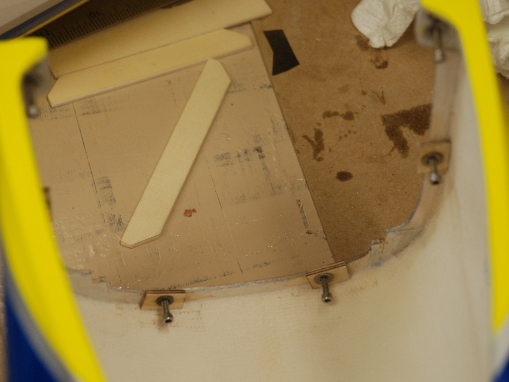

I'll post some photos tonight on how I've captured the cowl. Much more secure than the original. Both the cowl and canopy are heavier than I want or is needed. But I probably won't build new molds for those parts unless the plane comes out too heavy.
The biggest issue is the prop drive hub....it is larger than the crankcase so the nose ring will be designed as a two piece unit.....

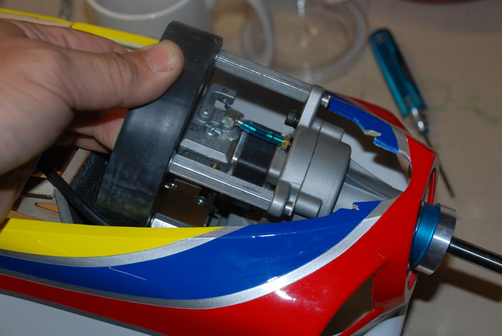

Lets do a show and tell. Stand offs are 2 inches long. Total length to the back of mount is 6 11/16"
Firewall is 1/4" X grained balsa carbon sandwich. This is trulyelementary to make is you have a Food Saver vacuum packer or similar set-up. I have one for food and one for toy airplane stuff.

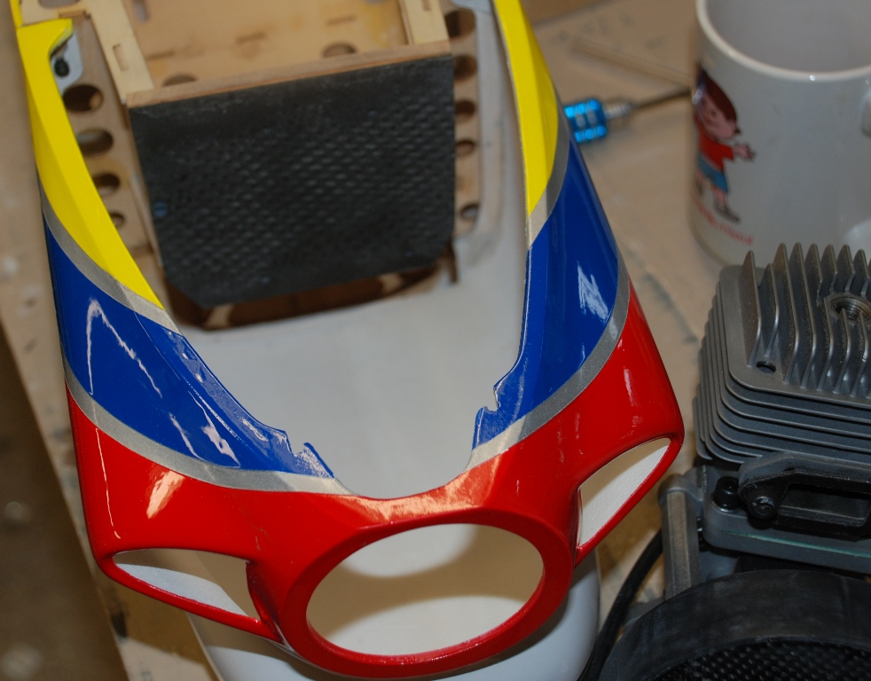

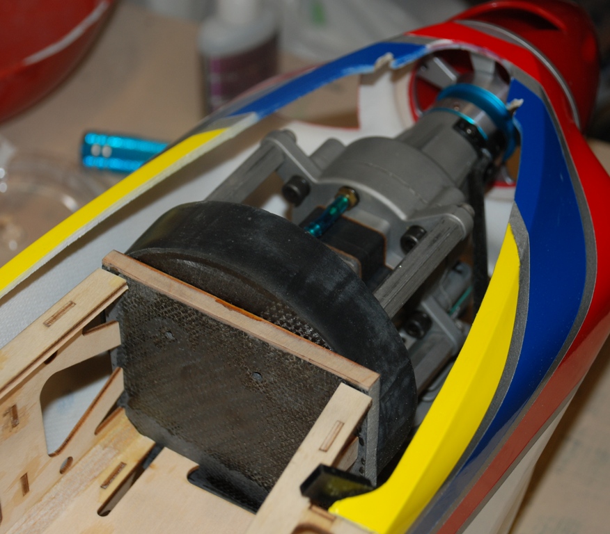

Some more; The front end of the VQ has lots of room to install the engine ready placed on its soft mount from thetop. Made fitting and locating simple

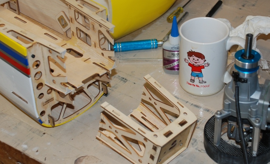

More; Once happy with the location, the tack glued FW is knocked off and set up withhard points and blind nuts. Also, the center area is removed shaving some more weight. Basically, the front firewall bulkheadsection I removed from the nose weighed 60 grams. The new FW and reinforcements weighed 30 grams....I'll take it
Edit I made a pipe tunnel yesterday...weighs35 grams. Removing the front end and replacing for gasoline, including the pipe tunnel, was essentially a wash. I'll post some pics as I conclude the sections. The tunnel was straight forward glass tube with appropriately located reinforcements to maintain shape and take the pipe mount
Canopy clears nicely

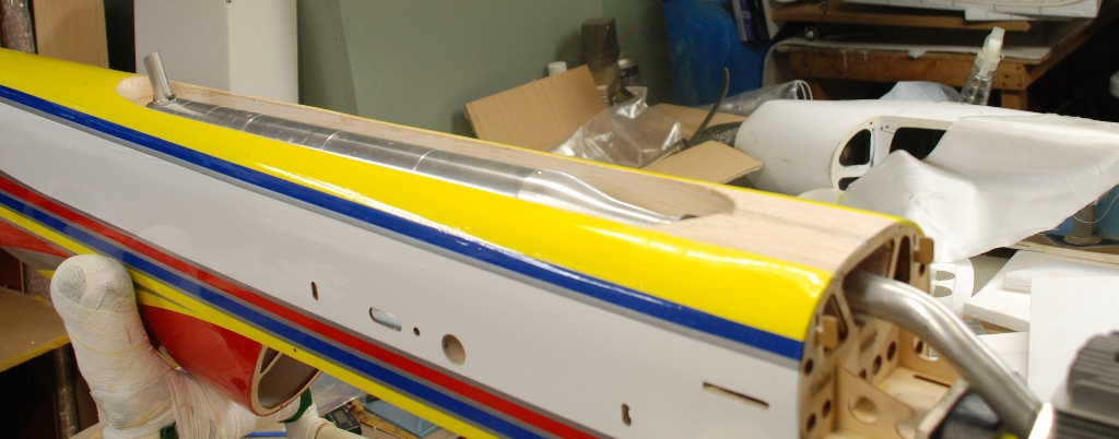

Okie dokie,,, I used one and half sheets of 1/32 medium balsa. The stringers are 3/32 spruce. I'll be glassing and painting the tunnel tomorrow.
The battery floor was carved up as shown. An 8-10 oz tank doesn't need all that structure to stay put. Yes an 8 oz tank for this size engine flies the crate for about 13 minutes, almost long enough for 2 Masters schedules
The aluminum pipe is from Mintor. It's compact and light at less than 5 ozs. The ESComposites works also, but it's longer than the Mintor and the tunnel would have needed more surgery. Mintor pipe is about half the price of the ESC pipe so, IF YOUCAN FIND ONE, scarf it up. OR let me know because I want a few more of them

Hello Matt
How did you install the balsa tunnel ?
Is it possible to install this composite tube shown in picture (diameter 50 mm, lenght 900 mm) ?
Claude

ORIGINAL: papaone
Hello Matt
Claude
Claude,
I opened the belly and built the tunnel in place. The tunnel is rectangular. I used CA for the gluing.
I also built a cylindrical glass tube first.But once I tried putting it in and played with the pipe and header a little to figure out how it would work,it occurred to me that pipe installation to the header might be a problem. So I decided to scrub the glass for the balsa.
The way I have it now I can assemble the pipe and header first, off the plane, and install itfully assembled
Old 10-13-2012 | 09:23 AM
