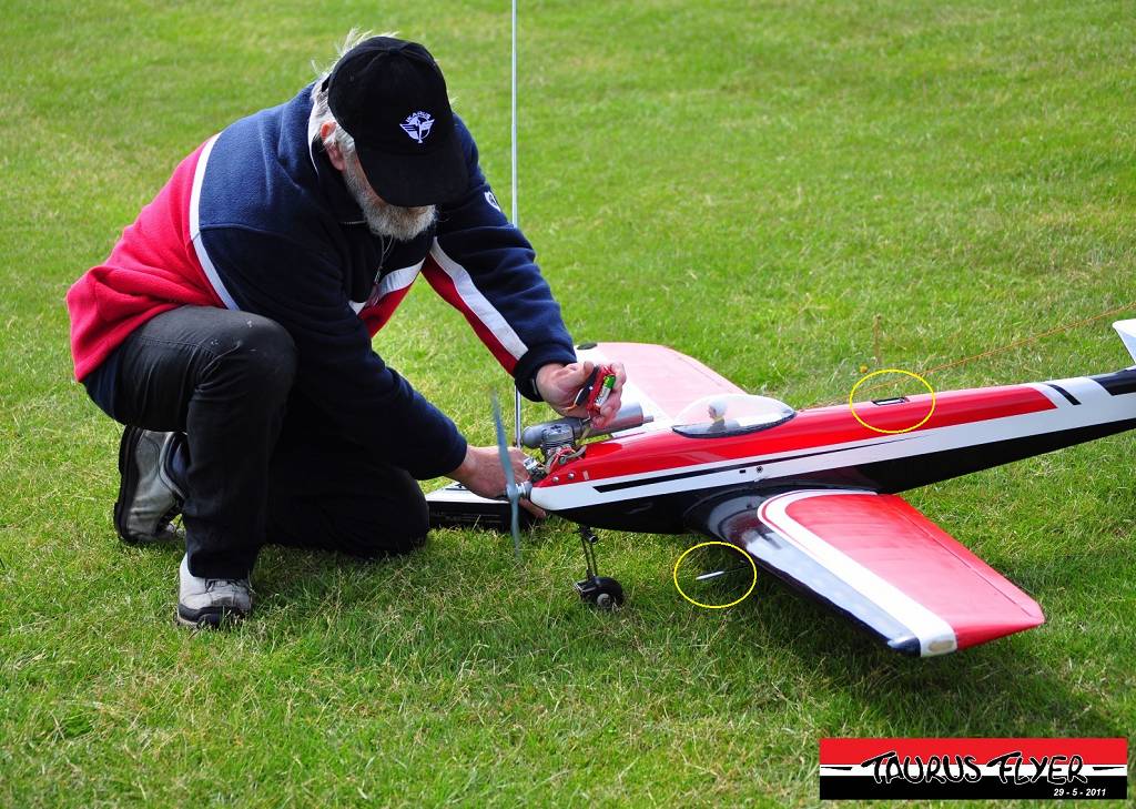

Look out for Old School, ! Ed Kazmirski was there more than 50 years ago but development of the Taurus wasn't stopped after that!
(see the yellow circles)
Cees

Gents, for who is interested,
For a brief description of my Taurus, see my post of 2009 in the thread "post some pictures of your pattern plane!!"
http://www.rcuniverse.com/forum/fb.asp?m=8848961
Cees
