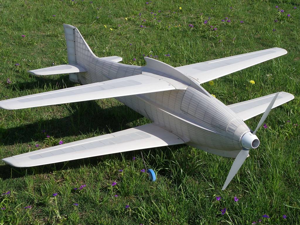

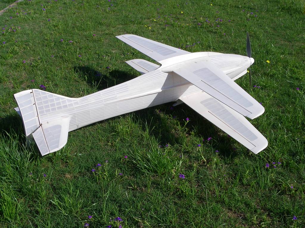

Maiden Day!
ID:	1874880   Click image for larger version

OMG, best plane I have ever flown, no mixes, probably illegal and will be banned from competition.
Chuck

OK... for the real flight report.
Liftoff was totally uneventful, needed some up trim and a little aileron trim, touch of rudder trim.
Winds were about 10 mph and slightly crosswind.
I set the timer for 5 mins and being this is a prototype I am focused on getting the airplane to trim to the best possible and I dont want to test the struture of the plane till then.
So... couple of passes... time for KINFE EDGE flight.
There was no noticeable roll coupling but I did have a pull the canopy.
Stall turns.. fantastic, downlines are straight with a little roll but I think that may be due to some twist in a wing or stab, or y wings my be off a little since there are FOUR different wings with individual adjusters and adjusters on the stabs.
So, I am very very pleased with the initital results and its on to more trimming. I will keep you posted.
Thanks for all your positive comments and encouragement.
Chuck

Chuck, I see no wing struts, will the plane survive a snap without it? You may have already covered this in an earlier thread but not sure i read that part, hence the question
Old 04-21-2013 | 12:38 PM
  #112
RC_Pattern_Flyer's Avatar
Joined: Aug 2004
Posts: 1,119
From: San Antonio, TX
Default RE: Insight RC Remora F3a bipe
I hope, wing tubes in top and bottom wing.

What are the initial incidences? All 0-0-0?
Regards,
Dean Pappas
Old 04-26-2013 | 02:33 PM
  #116
Joined: Aug 2004
Posts: 1,119
Well, intended to be 0 thrust, 1 deg right thrust .
Wings all set to .5
Stab 0
Ended up with wings at 1 before I figured out we have 1 up thrust.
I'm going to return wings to .5 and remove up thrust and this should remove most of the canopy pull.
