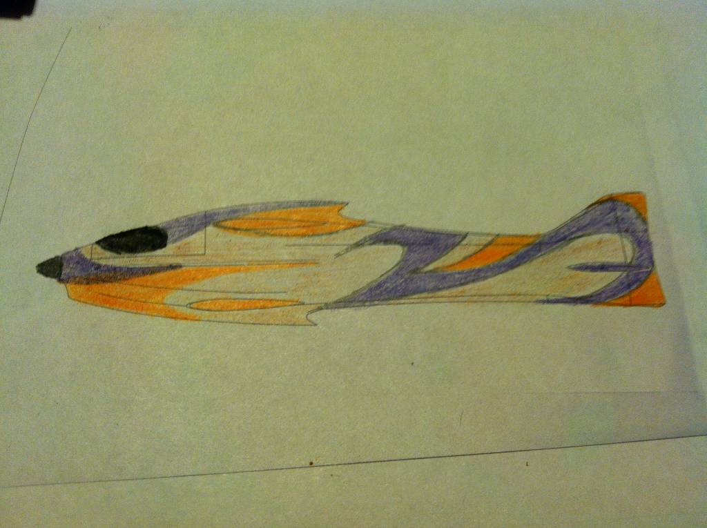

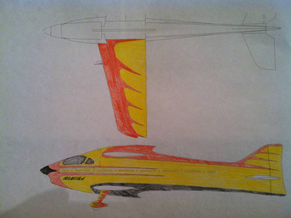

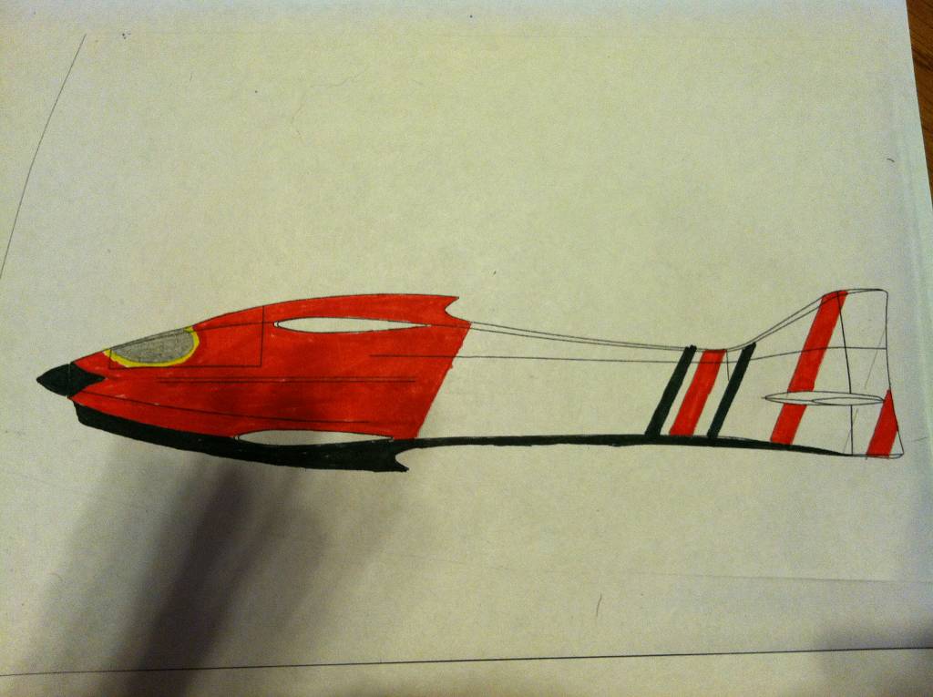

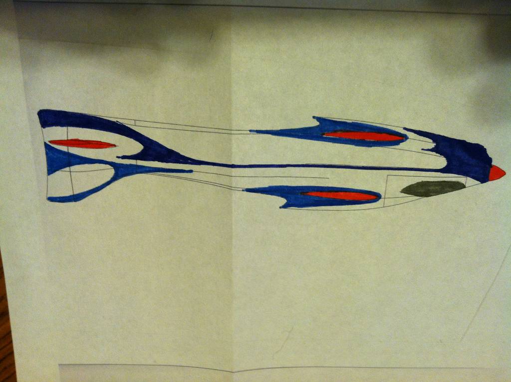

Old 03-12-2013 | 12:33 AM
  #57
papaone's Avatar
Joined: Mar 2005
Posts: 1,414
Received 137 Likes on 74 Posts
From: Salon, FRANCE
Default RE: Insight RC Remora F3a bipe
Hello
Great job.
I vote for this schema
Old 03-12-2013 | 05:06 AM
  #58
My Feedback: (45)
Joined: Oct 2003
Posts: 2,861
From: Great Mills, MD
Gotta agree with papone on the color scheme. Nice choice of colors as well. Lol.
Arch
Old 03-12-2013 | 08:25 AM
  #59
Anthony-RCU's Avatar
Posts: 630
From: Ossining, NY
ORIGINAL: papaone
Hello
Great job.
+1
Very Jules Verne!
Should we start calling Chuck Nemo?
Old 03-12-2013 | 10:34 AM
  #60
Posts: 559
From: Seguin, TX
Boy, I just can't win The red/white and black is the only scheme that does not make the plane look like a fish
Chuck, call me if you need more wood from the balsa forest
Ed
Old 03-12-2013 | 11:22 AM
  #61
Joined: Jan 2004
Posts: 338
From: South Plainfield, NJ
Hello Chuck and Mark!
I love it.
I would be willing to bet, though that two layers of silkspan clear-doped then shot with analine dye in dope thinners will be stiffer lighter and soooooo cool looking.
the very BEST regards,
Dean Pappas

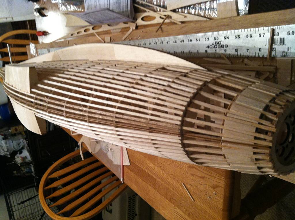

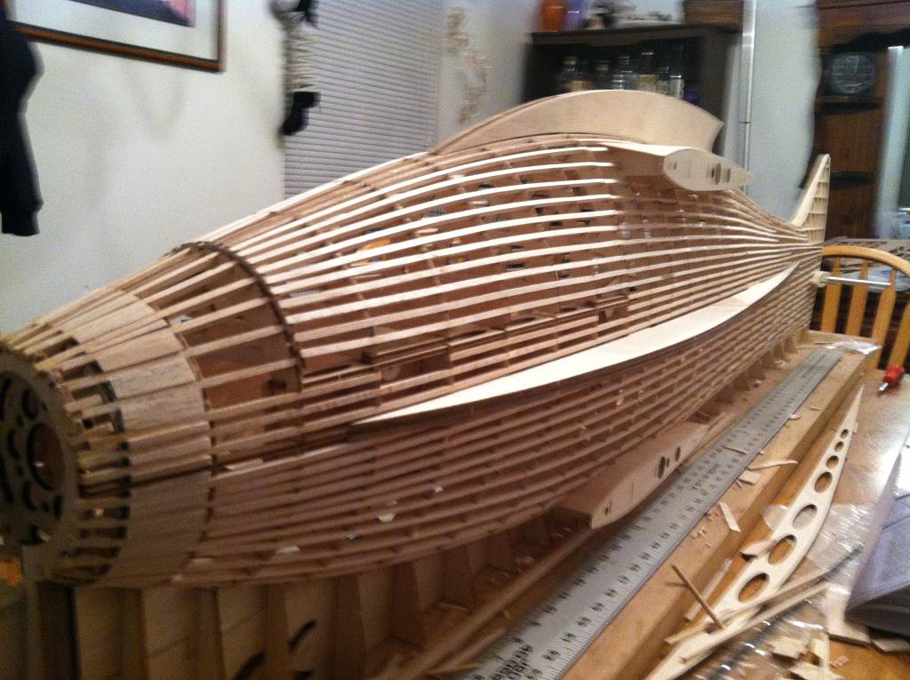

Old 03-12-2013 | 05:47 PM
  #69
My Feedback: (12)
Joined: Feb 2003
Posts: 638
From: Madison, AL
Chuck,
Are you going to try to fill the weave before paint, or leave a textured surface?
Never seen so many stringers in my life!
Jon

Old 03-12-2013 | 06:30 PM
  #71
RC_Pattern_Flyer's Avatar
Joined: Aug 2004
Posts: 1,119
From: San Antonio, TX
If the kit is made available, it will be all laser cut except for stringers.
Sheeting is laser cut as well, we arew making notes as to mistakes or changes in construction.
I do not plan to fill the weave at all, it was my intention to give this bipe a lot of character and I think the weave is part of that.
Chuck

Wery impressive build and design, just wonder how many kilometers off stringers have been used!!

ORIGINAL: RC_Pattern_Flyer
BTW, I am covering this plane with Balsa USA solarspan, antique.
It is awesome to work with, goes around curves with ease, tighens up nicely and it adheres nicely to the structure.
Chuck
I wish you guys luck with all those balsa stringers. Carbon tubing might have helped keep wood stringer breaks to minimum and helped remove some of the structure
Don't know the weight of solarspan. Sounds like it has the adhesive built in.
Polyspan lite adhered with balsalock might be lighter. Balsalock is water based and can be sprayed or brushed. I also have some other great water based spray on adhesives that are heat activated when dry. Contact me direct....
Many Free-flighters do what Dean suggested, 2 layers silkspan. Some free-flighters change the technique and apply lite polyspan first and then come over the top with coloerd tissue such as Plyspan Esaki. Builds into a very light but stiff-strong structure that is puncture resistant. Polyspan must be preshrunk with heat before the esaki. Look in any Free-Flight websites for supplies
