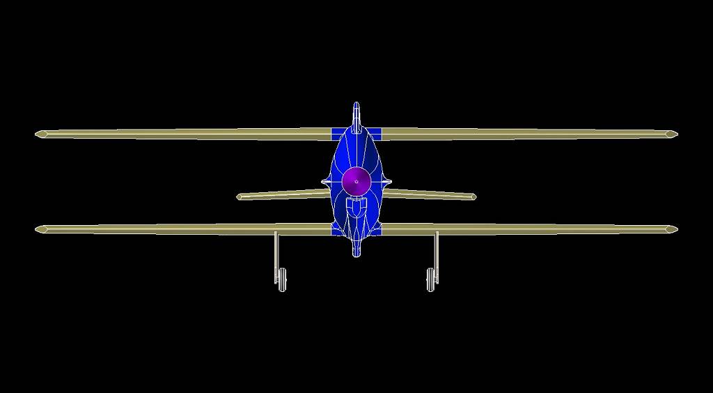

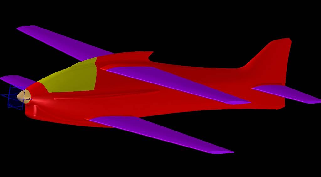

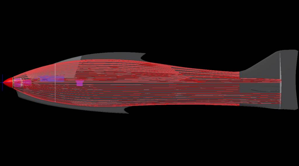

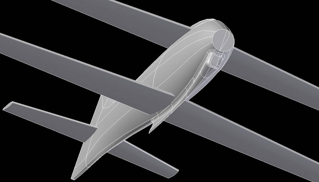

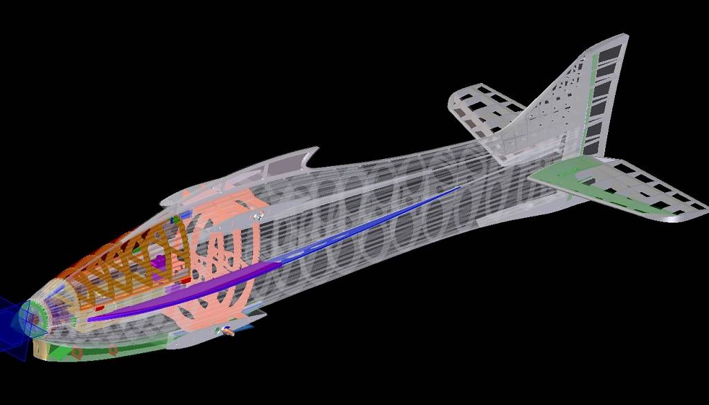

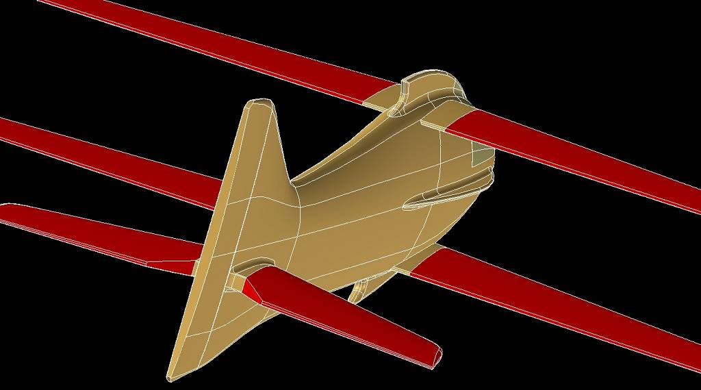

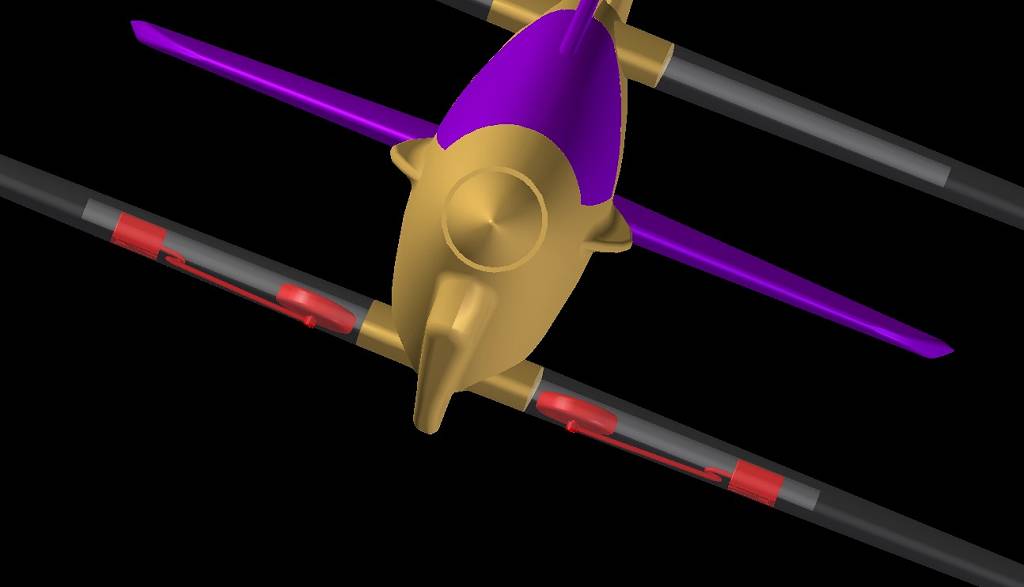

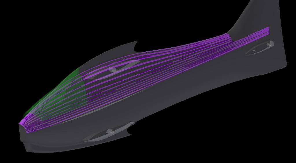

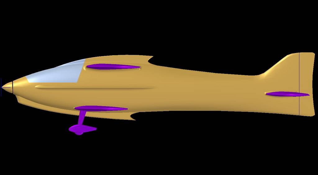

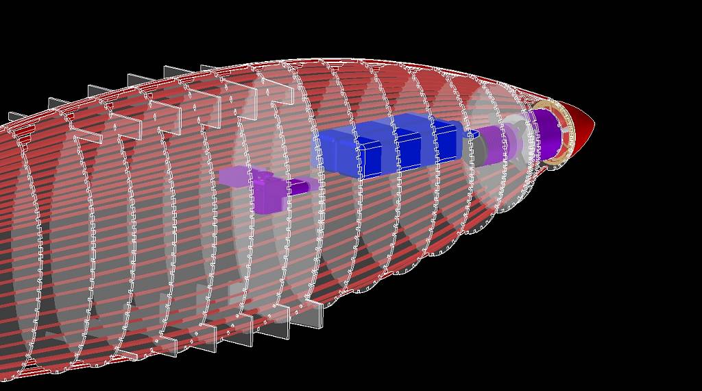

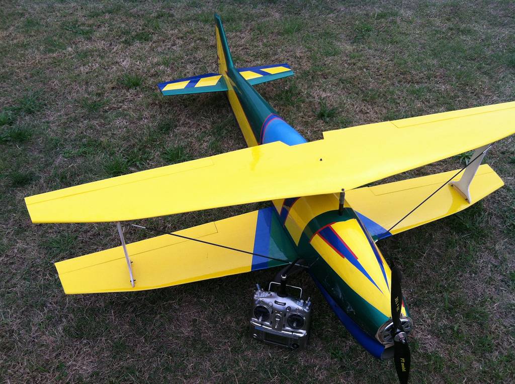

This is the newest design coming from a combined effort of Chuck Hochhalter (concept) and Mark Hunt (designer/Engineer)
With this design through past experience we had noticed that it was troublesome to sometimes get the CG where we wanted without having the batteries right up to the back of the motor.
In order to correct this, we decided to flip the position of the top wing to a rear Stagger.
We also ran into a few instances where the amount of work to adjust the incidence in the wings was cumbersome and often required a ridiculous amount of work to accomplish.
Chucks experience with bipes comes from owning an OXAi Shark and also building one of the Harmony I prototypes. Chuck has also flown the Sun Ray classic bent wing pattern plane from the 70's and noticed the potential held with in and with Marks the project was born.
Following is a years worth of drawings and design implementation to produce a laser kit which will be arriving any day now.
You may also follow us on Facebook, Insightrc remora. Please like our page!
Chuck and Mark

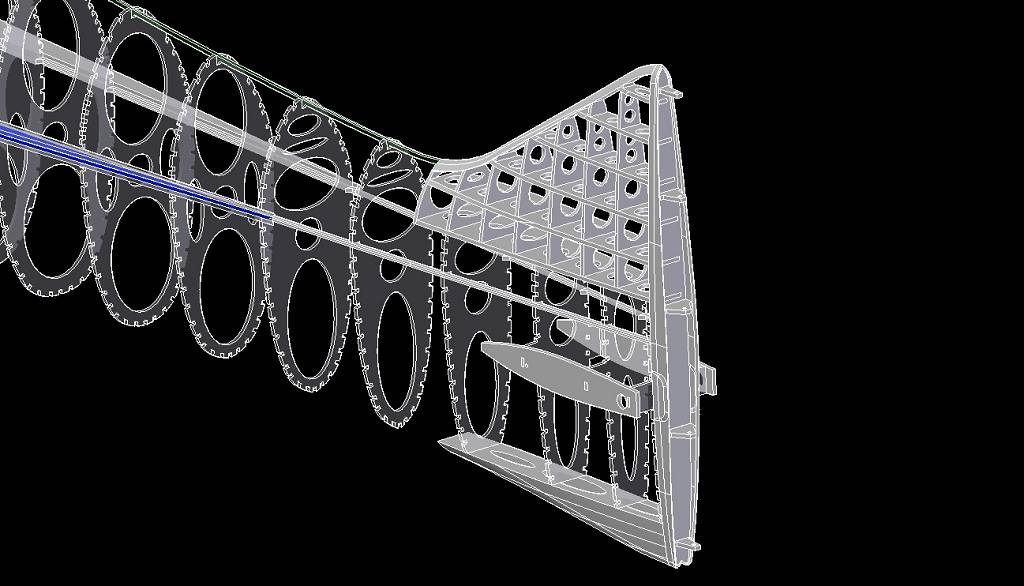

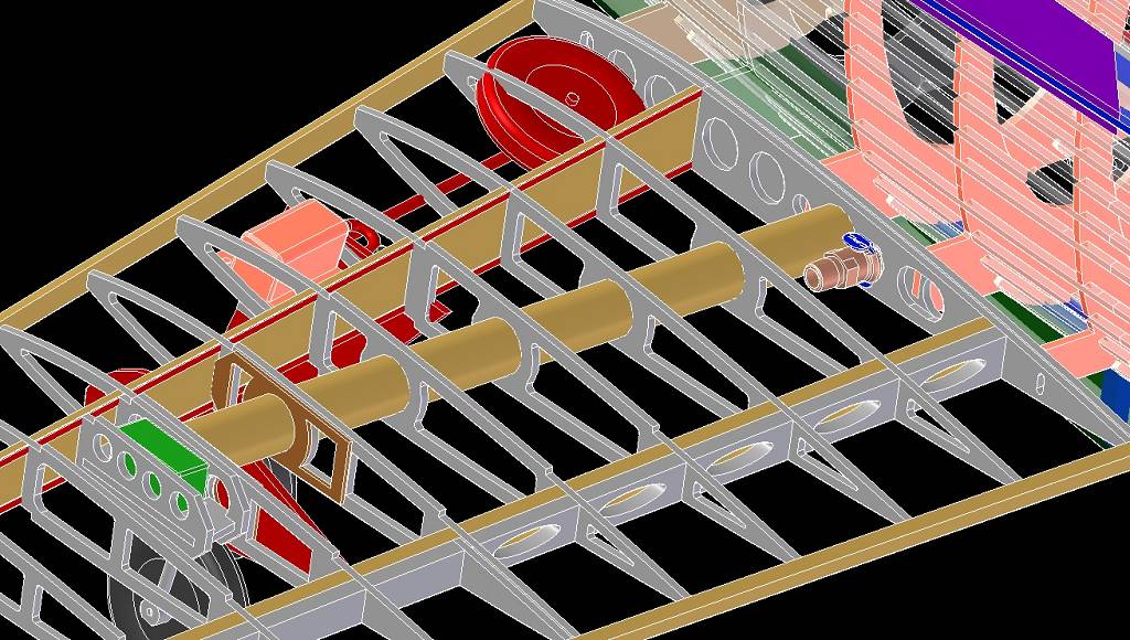

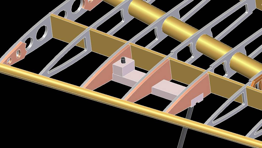

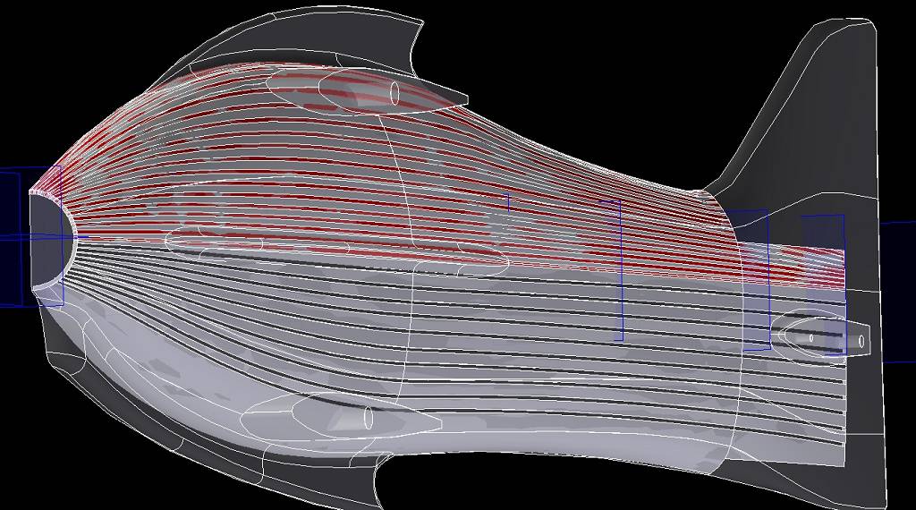

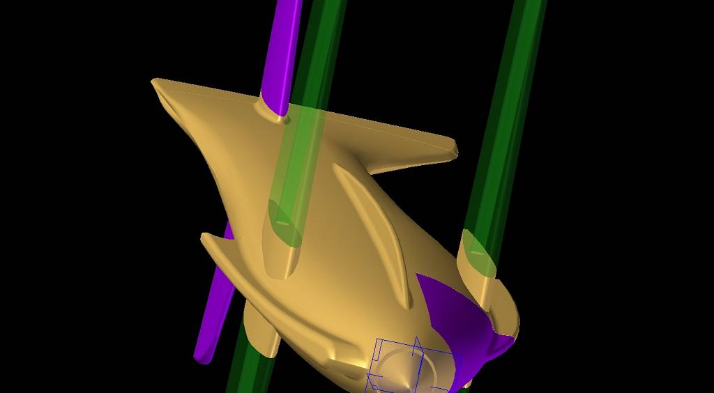

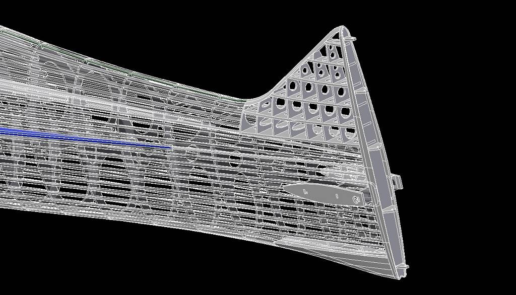

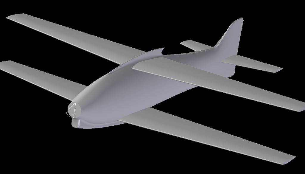

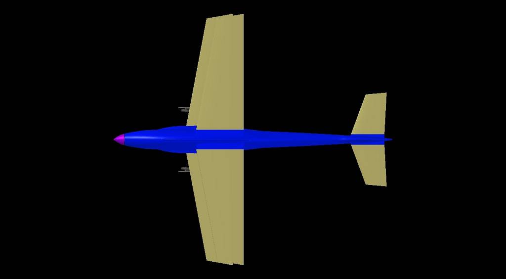

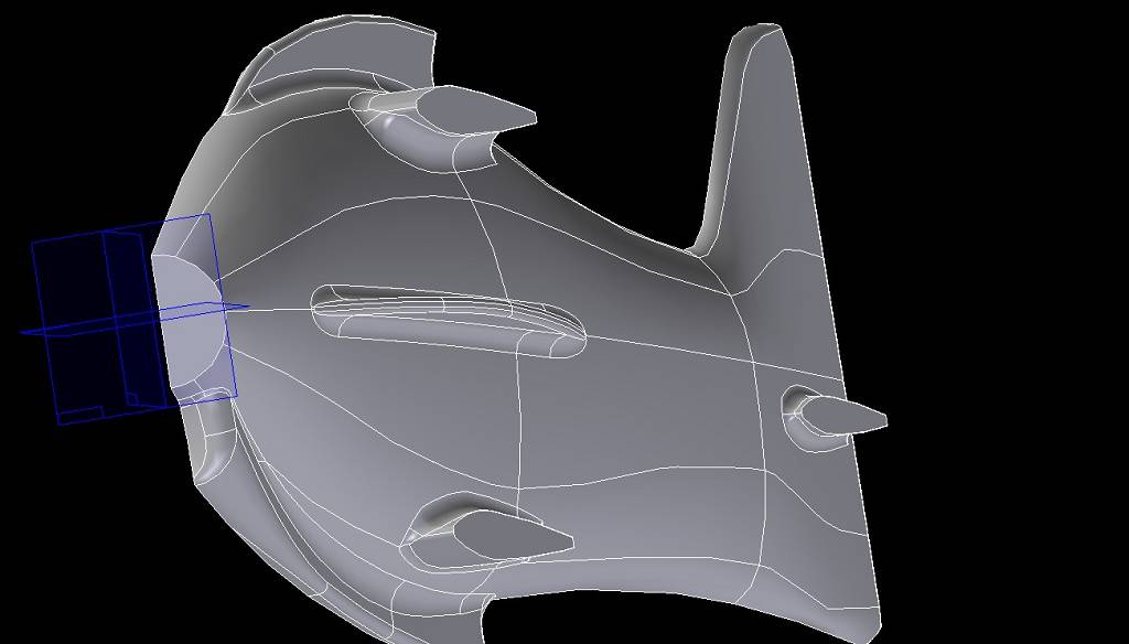

First drawings
RCU strikes again, nothing uploaded.

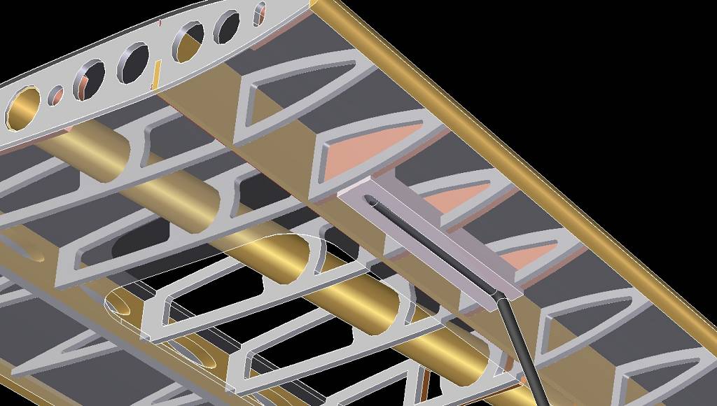

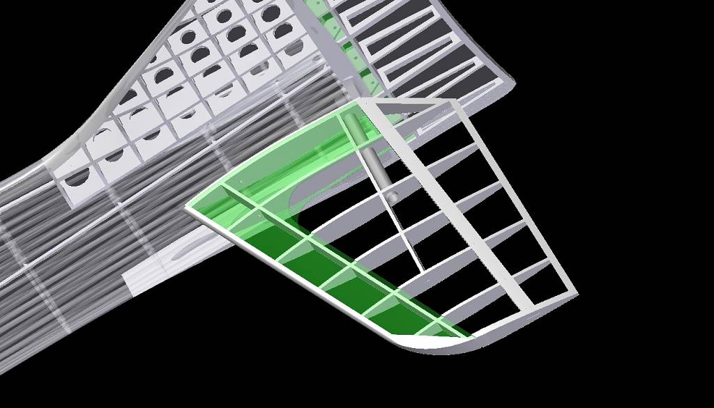

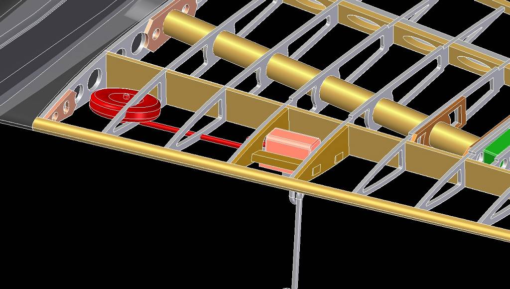

Hi Chuck,
So it's going to have independent incidence adjustment for each wing panel?
Cheers,
Jason.

Jason,
Yes, there are adjusters on each wing panel and stab.
There are also no wing struts in the design.
Chuck

Any plans on gel coating this one? It would be "Bad ***** looking gel-coated,..PPG white.
bholsten
Old 03-04-2013 | 10:56 PM
My Feedback: (34)
Posts: 3,821
Received 11 Likes on 8 Posts
From: San Diego, CA
Default RE: Insight RC Remora F3a bipe
It's an all-wood airplane. Looking forward to seeing how this flies.
Old 03-05-2013 | 01:10 PM
AmericanSpectre505's Avatar
Joined: Mar 2007
Posts: 1,238
From: Fayetteville, NC

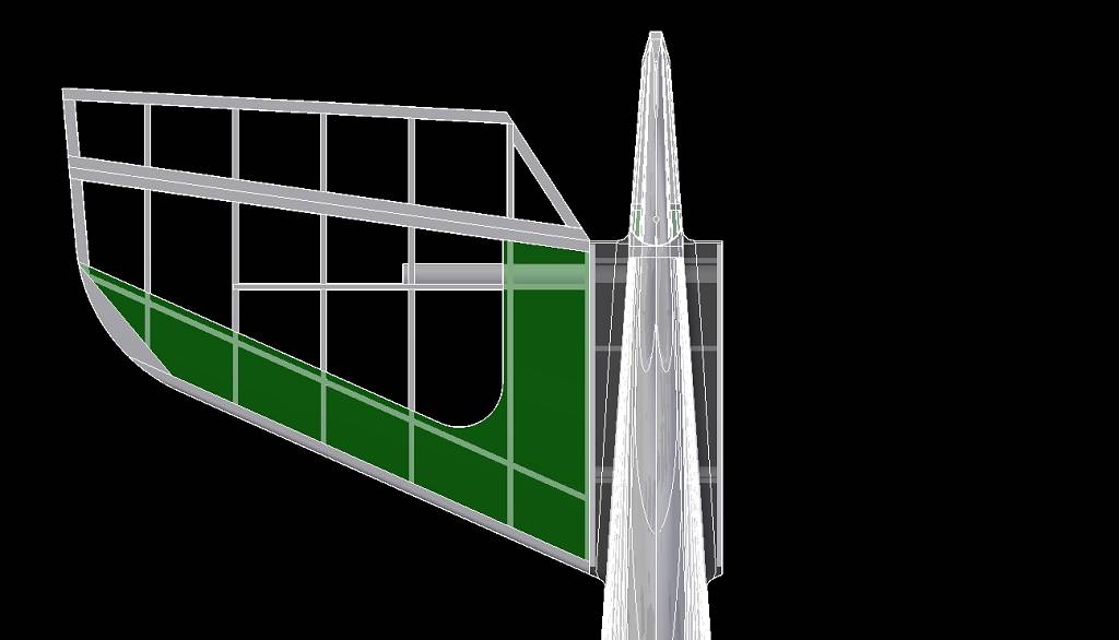

Is that a touch of Dihederal in the horizontals or an optical illusion?
Bill
Old 03-05-2013 | 01:50 PM
RC_Pattern_Flyer's Avatar
Joined: Aug 2004
Posts: 1,119
From: San Antonio, TX
optical illusion.
