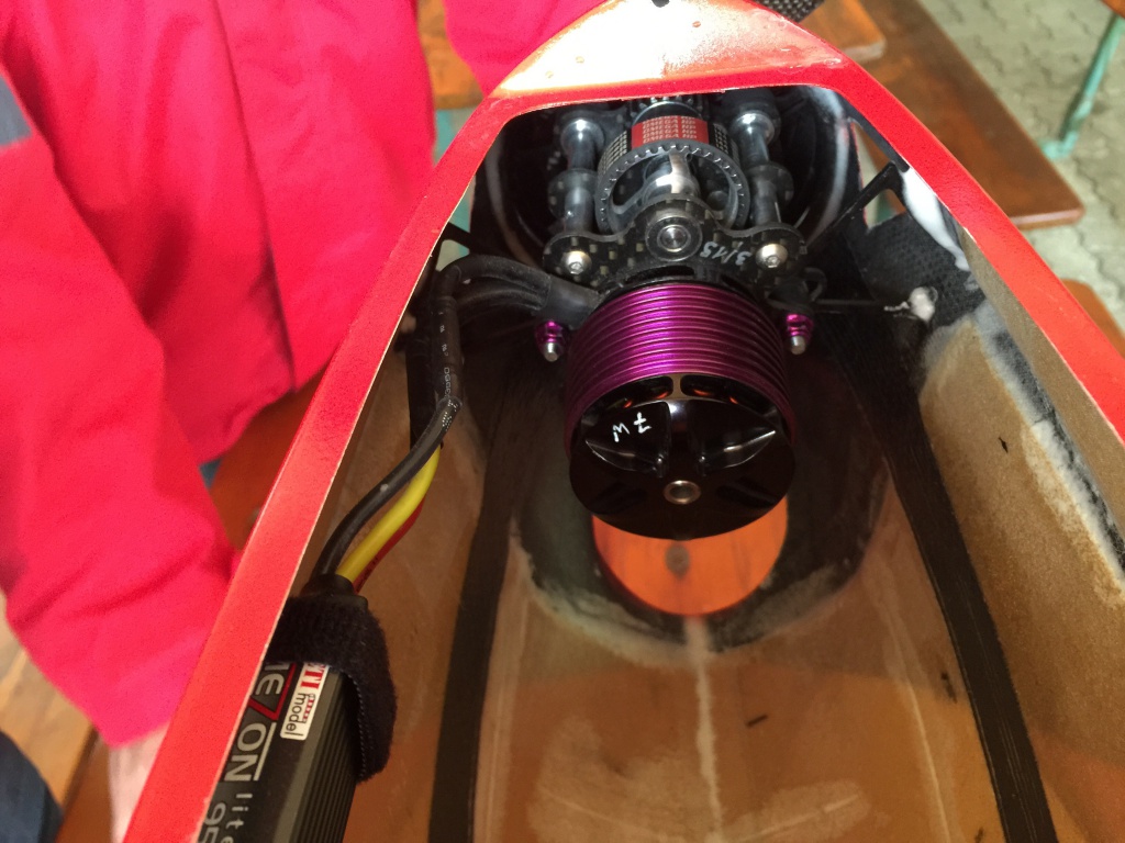

Hi,
I've been beaten to it !
Gernot Bruckmann's new model.
A revisit to the Sensation c/w new wings and all moving tail.
At AUW less than 4Kg !!!!!!!
I wonder is he using one of the new contras with a 6S to 8S heli motor ??
Brian

Did you fly yours yet?
#87
Hi Matt,
The original Sensation was indeed quite small, area wise.
This looks a little bigger, but not much.
No Matt, I had to park it for a collection of reasons. Amongst them, it had got too far into the last season and I needed some stick time.
Also I just wasn't happy with the weight build up using talc.
I got some sink stearate but it was not behaving properly - I hadn't a clue how to use it.
I have just recently got some good guidance.
Mostly though I got into real difficulty with my back - both upper and lower - a long story - old war wounds and all that.
We have had other 'life' stuff going on as well - mostly good though.
Getting back to it this week - Alex and Isaac are inspiring me some.
Brian
