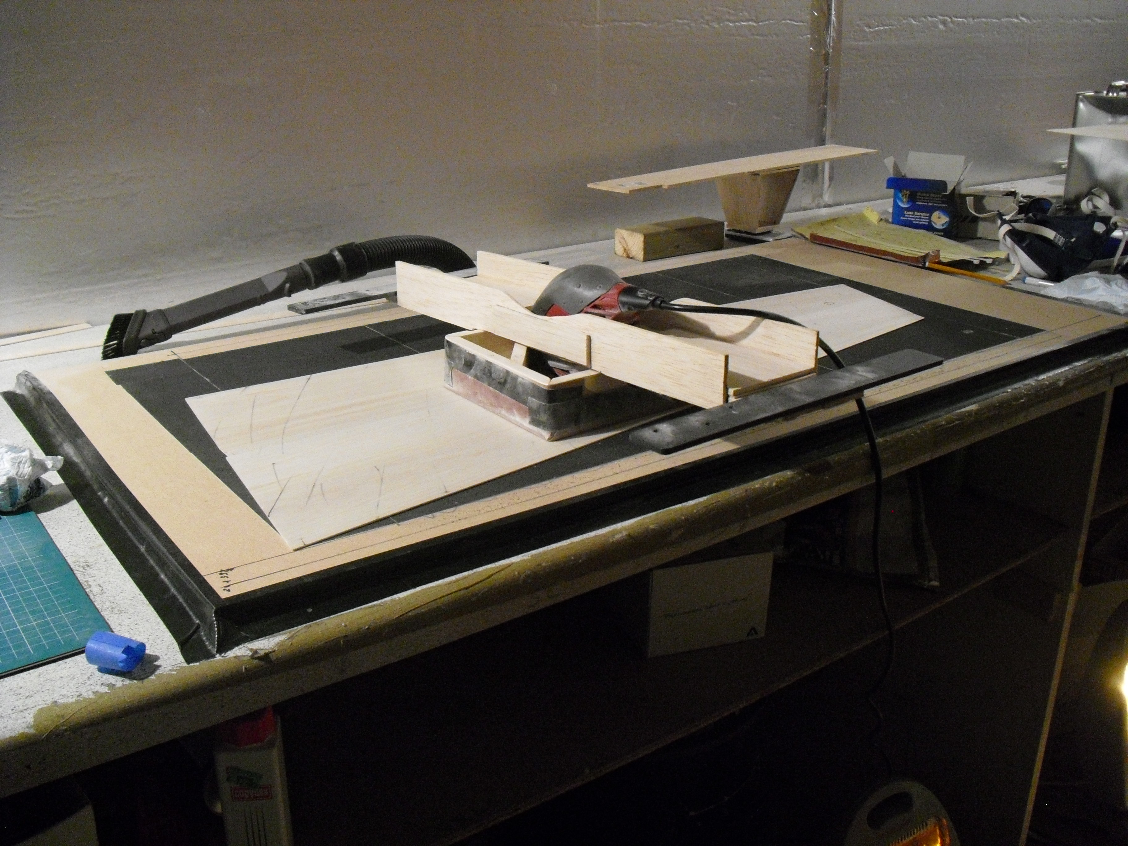

Hi,
Have finally made a start.
The actual cores are coming out at 32.5g.
Also have the skins down to 22.5g before applying the inside carbon veil. There will be a little more sanding to do after the skins are applied.
Also have decided to seal them by spraying the first coats of dope - I got a new toy - a HVLP gun which works good for this - hard to believe how little air this needs to spray well.

Looks good Brian! Only comment I would make is that last time I honeycombed wings (on a Summit 120) I left the lands much thinner than you have done and the result was entirely satisfactory finish and strength wise over the couple of hundred flights I had with the model before I sold it. That was with filmed covered wings and a YS120 up front!
Oh and I used hairspray to seal the cores.
Malcolm
Malcolm

Hi Malcolm,
I think the camera angle is tricking the view a little.
The lands are 10mm on the template giving a 9mm land on top and 8 to 9mm on bottom (due to pull/push on the wire - one template only).
My scale is not good enough to measure the weight of two sealing coats of dope - it seems to have added nothing at all ??
Brian

Hi,
Just a little more detail.
Top and bottom wing core weights were 65g and 70g prior to honeycombing.
They are now at 27.5g and 32.5g respectively.
The wing skins were 30g prior to sanding and they are now at 26g with 0.2oz carbon veil applied - to the inside.
Brian

Hi Matt,
Will do.
I have worked out a glueing method, using PU, that will use 5g to 7 g per skin.
It's just that I have not done it this way before with veil between the wood and the core.
I will do some testing today and examine the results.
On honeycombed large mono wings I used thinned PVA put on the wall caps in a bead with a syringe. The PVA was thinned by 30% and a little food dye added.
10cc was more than enough per skin but when dry this left only 2g to 3g of dried PVA. So I was skinning a large mono wing panel for way less than 10g.
This required that the foam cores be pre sanded to a fine surface finish and the panels had to be put in a cold dark room for a few days to dry out when they were removed from the press.
More later.
Brian
