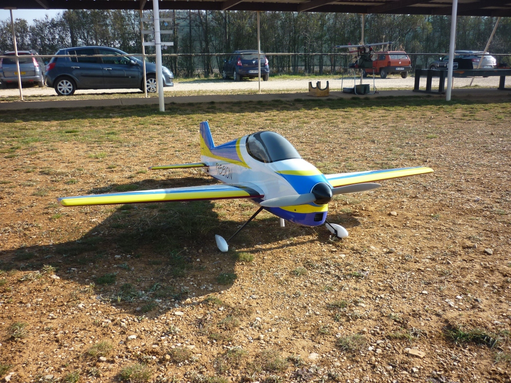

Hello
Engine is PTE 36 R so there is no problems without tuned pipe, just a little noisy with muffler.
http://www.troybuiltmodels.com/items/PTE36R.html

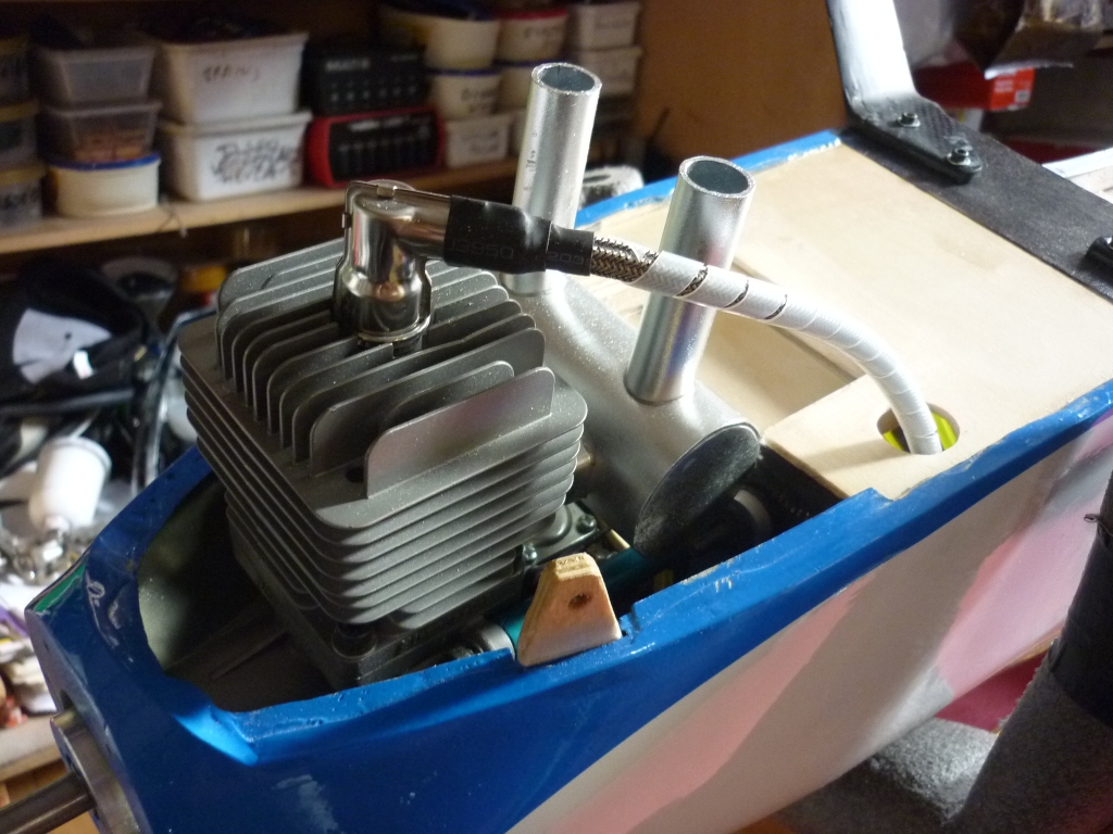

just a little more info on the soft mount. Whilst we pretty much followed Matt's method on the soft mount construction we couldn't find an inner tube of suitable diameter so instead simply overlapped a single layer of rubber using a belt sander to create a nice clean angled join using Loctite Black Max rubberised CA adhesive. No signs of any deterioration on this joint so far.

I don't think the tuned pipe would be essential. Even though I don't think we have the tuning optimised yet I haven't found it to be overly sensitive, its pretty light and keeps the noise down (nowhere near as quiet as Scott's YS though!)
You could certainly buy a genuine Hyde mount and I did talk to Merle about getting one but unfortunately the size wouldn't fit in the space we had to work with and the price didn't fit into my budget. I cant compare the one we made to the genuine Hyde but it does seem to be working ok so far and made a noticeable difference compared to hard mounting.
Alternatively you could look at something like the isolation mounts shown in Claude's post on the previous page, we will probably try one of those setups in the future but had trouble sourcing the bushes during this build, I believe now the ones we were looking at are back in production.

Let me suggest you cut yourself some slack. Hyde has been custom building rubber iso mounts for 25+ years. I'd veture a guess and say he's built 20,000 over the years (making him a millionaire which is great for him). The one you built was number 1. Just like I've done, you will learn new ways to make then, making them lighter and stronger, and balance them for best performance.
In regard to noise, let me suggest that you soft mount the pipe also. I use a single Lord type mount for the soft mount base. I've posted how that's done on the various threads I've contributed to.
In my latest design, Delta, I've lined the chin with some soft foam and surrounded the engine intake with soft foam to further suppress noise. It all helps and it just depends on your threshold for how far you want to take noise suppression. Delta is exceedingly quiet, at least on par with any 2 or 4 stroke of similar size flying pattern today. About as quiet as most electrics in reality. Practically anything else flying drowns me out
