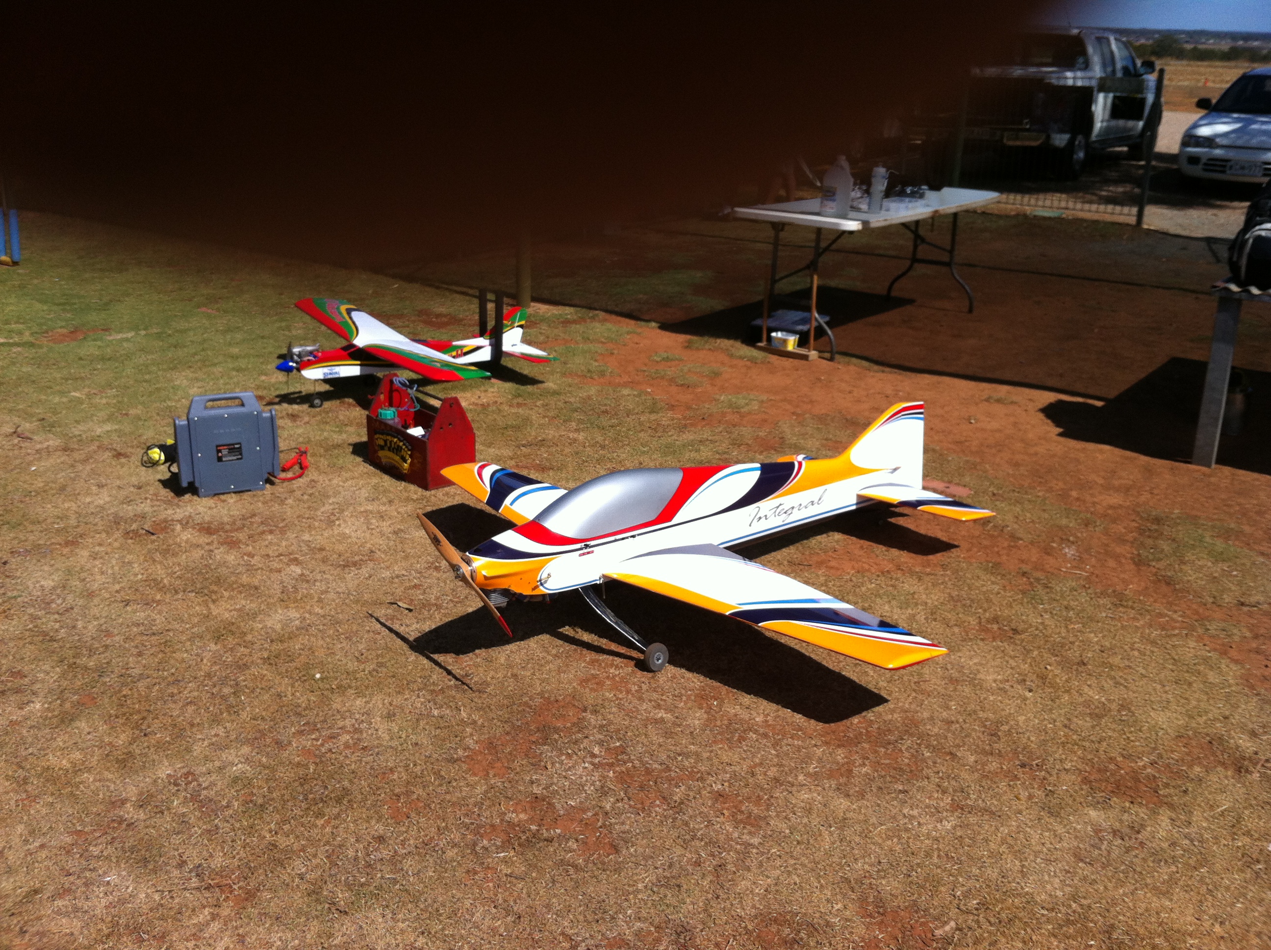

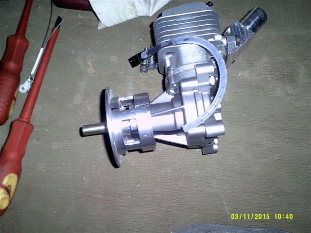

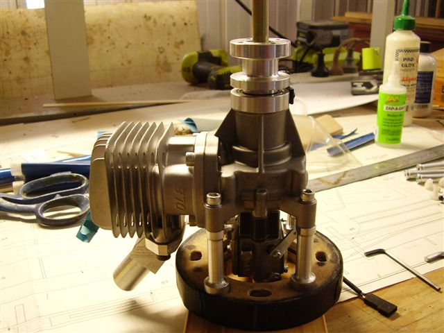

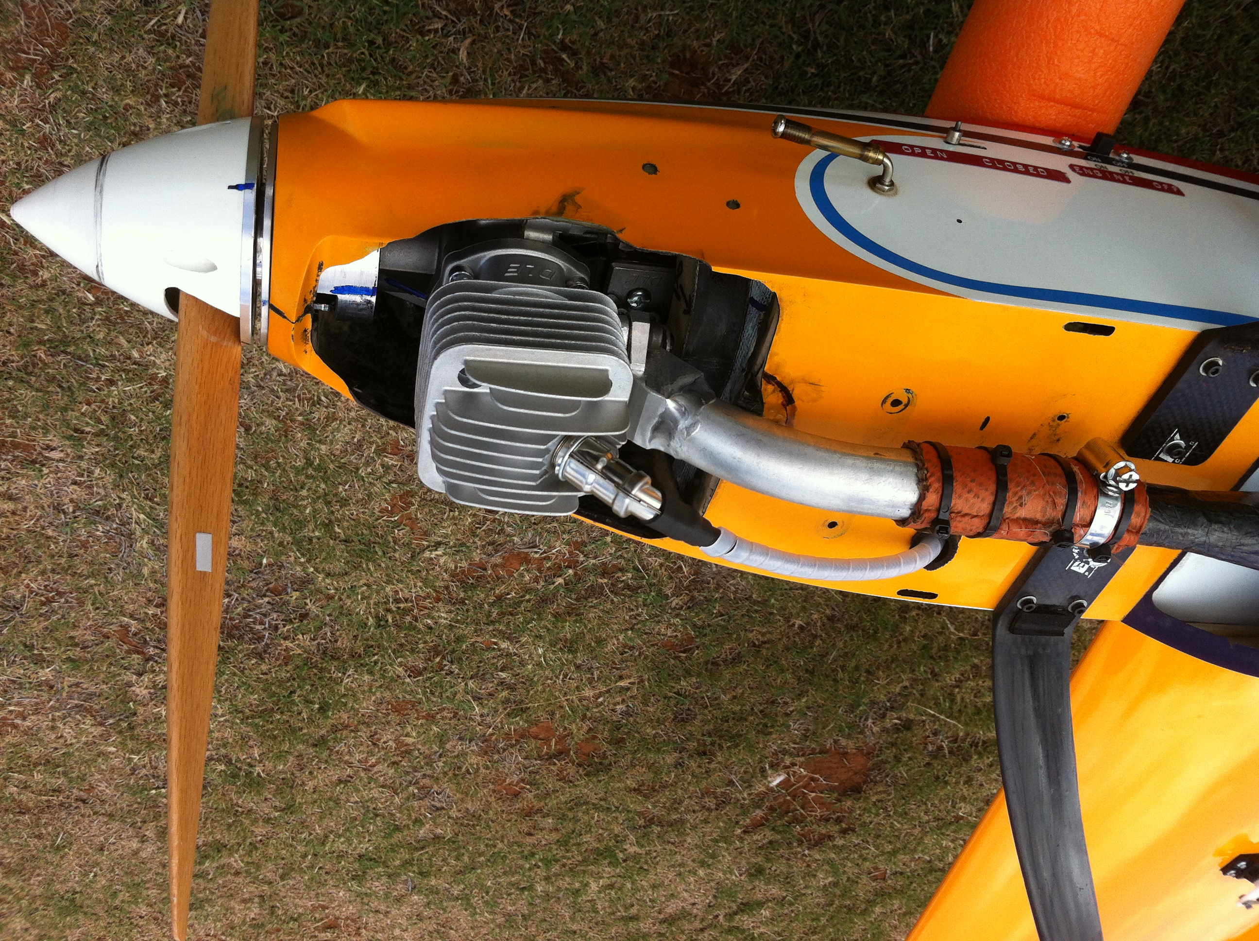

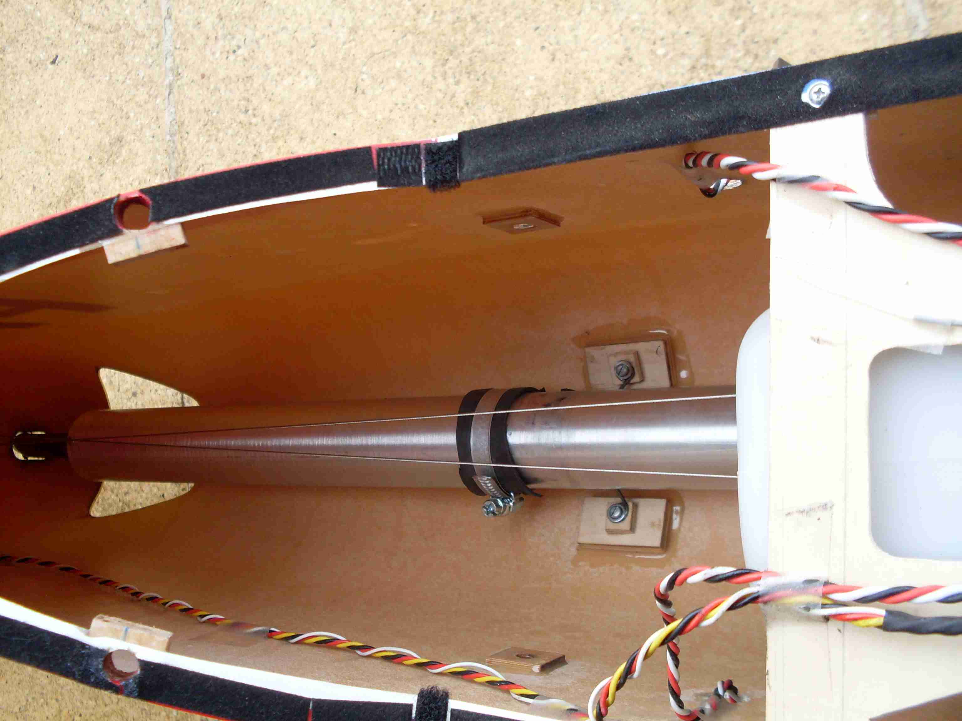

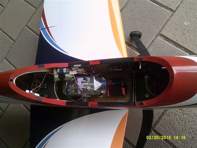

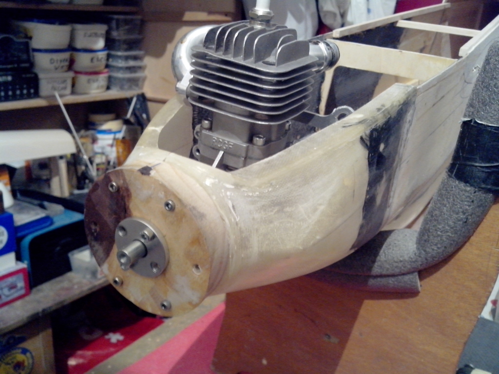

Hi All,
after finishing off our first season of pattern last year flying a 48" Vanquish we decided to step up to something bigger.
We obtained a Comp ARF Integral from one of the local competitors (we are in Adelaide, South Australia) and inspired in part by MTK's posts on gas engines in pattern planes and keen to try out our first petrol plane we decided to pair it with the DLE35RA, mostly due to thinking it would be easier to work with the rear exit exhaust.
we got an Aeroslave carbon pipe with the plane and hooked that up with a custom manifold. We followed MTK's guide on the diy soft mount which seems to be doing the job so far (after two attempts to build it right ). Also made an exhaust joiner similar to MTK's after blowing through a couple of silicon hoses again this looks to be holding up well, couldn't find the ceramic sleeve so instead used exhaust header wrap with the permatex ultra copper silicone.
currently we are running a 19x10 Sail prop (think this might be the same as a Xoar). RPM on the ground is about 6900 but according to the telemetry this is heading up to 9000 in the air (not sure how accurate this is, seems a big jump to me). Not sure if this is a bit high and if a prop change is needed and is quiet at low revs but gets a bit noisy at the high end. Its probably only had around 3 litres through it so far though I think we are getting close on the needle settings.
Its a bit overweight at the moment at 5.5kgs but we have over-engineered a bit as there are a number of 'first times' for us on this plane plus the telemetry gear so I think theres potential to make weight. At this point given that we fly sportsman and (in Australia) the weight limit does not apply we haven't worried about it so far.
So far its meeting my design goal of allowing us to get in longer flights for more practice time with two sportsman sequences done with less than half a tank of fuel (500cc again bigger than needed). Now I just need to get a heap of time on the sticks and prove the move up was worth it!

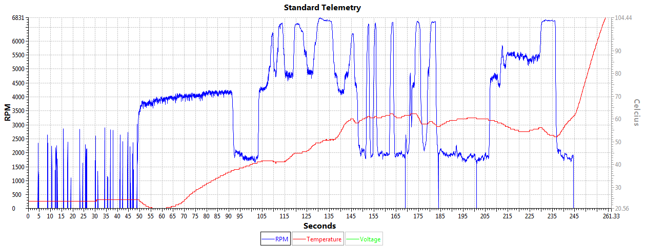

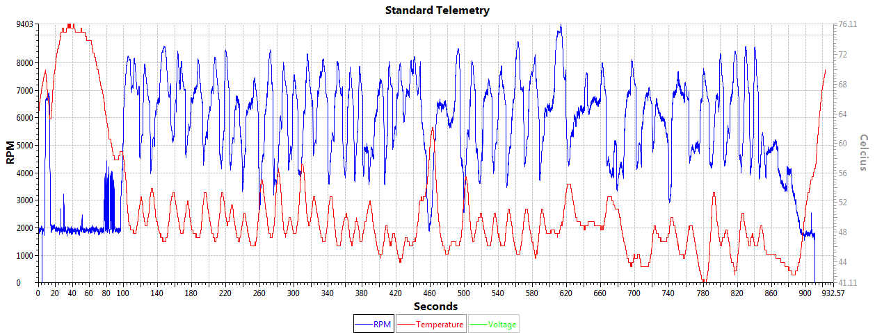

a couple of the telemetry charts 1. ground running 2. flight

I also used a 19x10 laminated woodie on my DLE35R. I used an ESComposites 40G pipe on mine and set the length to 27" from center of head to the reflector inside the pipe, following the curved header. The AEROslaves pipe was for glow engines with the baffle set 3" shorter than the ESComposites gas pipes. That just means that a 3" longer header pipe is needed. The Integral may not have the pipe length necessary.
Point being in the air unloaded, the 9K rpm with the short pipe sounds about right. Let me suggest that you lengthen a couple inches to reduce the jump and the sensitivity. Powerwise it has more than enough for a 12 lb airplane.

Had our second comp with the plane last weekend and all went well. Weather conditions were near perfect and I managed to get my second promotion point, one more to go!
Have attached some more telemetry files, I was trying to work on my throttle control as the day progressed i was using less revs, think there is more improvement in that area to come though. Also having trouble getting the idle to come down for landing so need to investigate that further.

That's a common ailment for slightly lean low end. Fatten it up slightly, less than 1/8 turn on the LS needle only. It should settle in quickly. Another way to tell if your low end is slightly lean is a slight hesitation when gunning the throttle. In fact, if LS needle is set too lean, the engine will not transition and die.
There should be no hesitation. Remember the carb adjustments are a bit different than glow.
Yet another way to tell is to look at the spark plug. If the element is grayish white, it's lean. Tan and dry is what you are after. Dark brown and a bit wet, too fat

Update on the soft mount and exhaust joiner as well is that we are about 35 flights in and no signs yet of any damage or wear so we are happy with that.

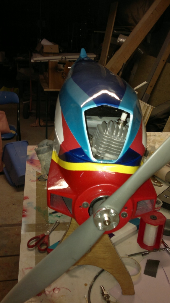

Hello
With 2 blades we use only 2 bolt as shown on pictures.

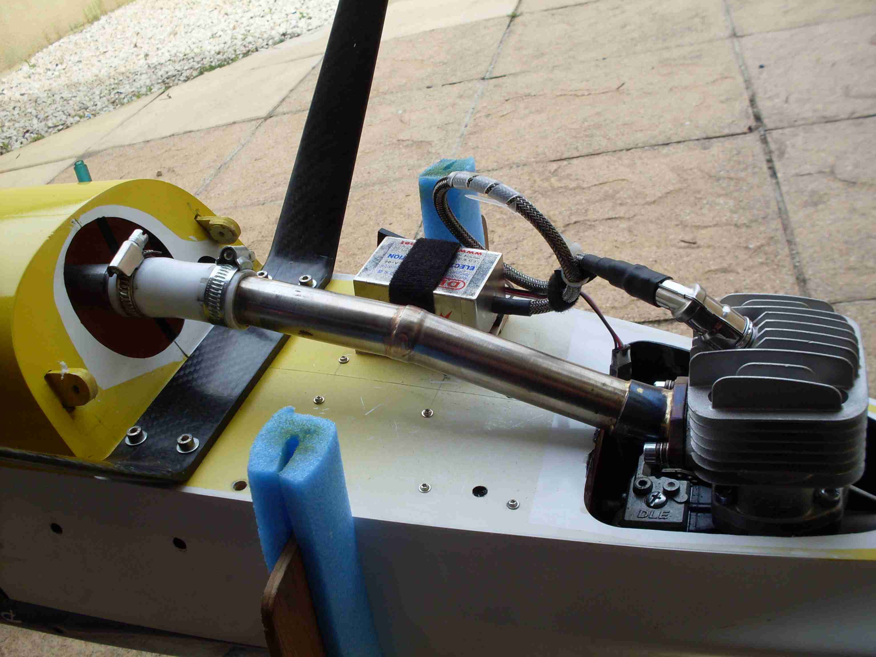

Header is HPAL-ZDZ 40 RE - 25.
He bought in topmodel-cz shop
. It is cheap about 30 Euro delivery at home.
http://www.topmodelcz.cz/index.php?&set_lang_client=2
Tuned pipe is
http://www.topmodel.fr/product-detai...l-mvvs-35-40cc
Propeller is 18x12 APC. I think it is too little.
Claude
