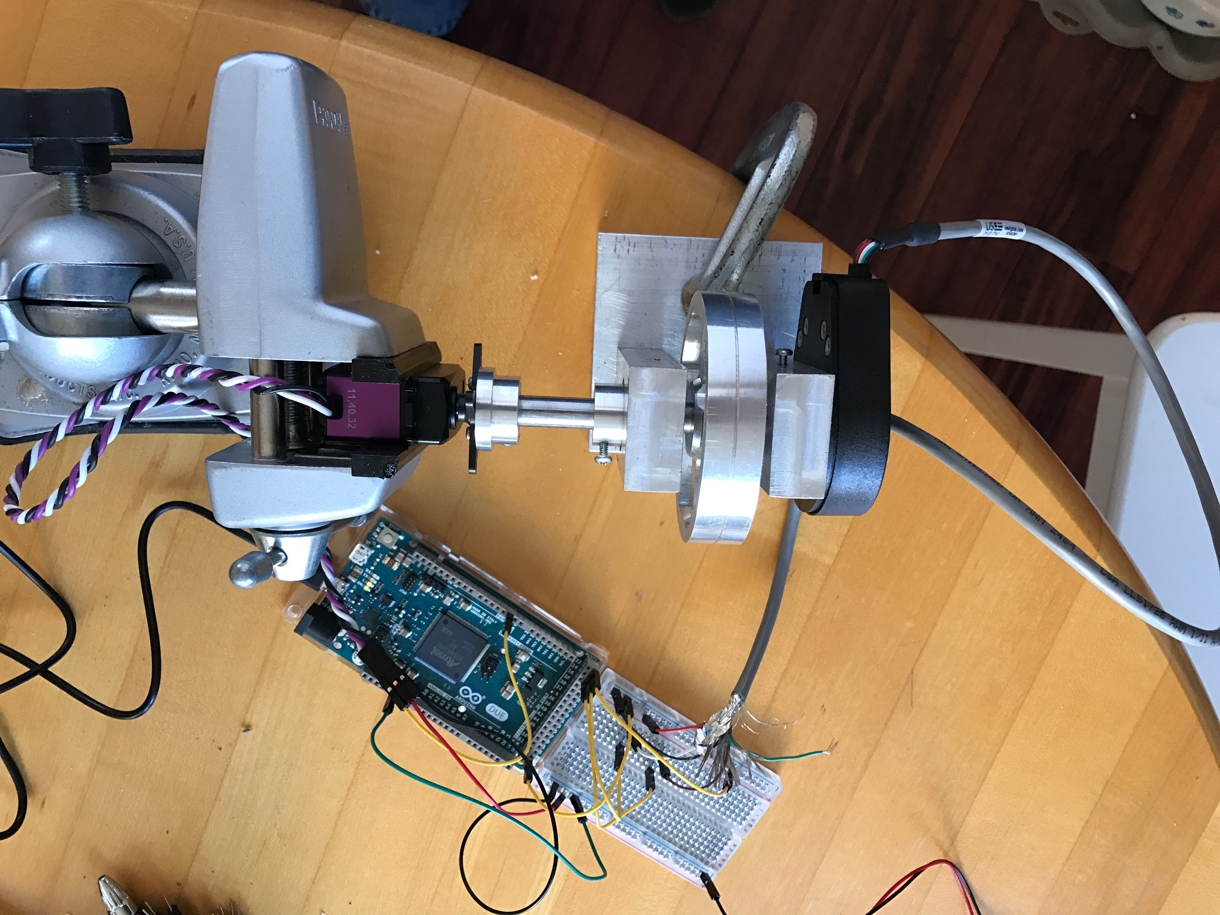

Quite frankly, all the innovation here scared me a bit. So I wanted a way to truly measure the performance of these servos. So I did some research and worked with my buddy with a full machine shop in his garage to build a servo test jig that would be repeatable. The result is shown here:
Starting from the left side of the photograph, you see a high resolution optical encoder from US Digital, it’s a quadrature encoder that tracks 7200 counts per revolution (28,000 pulses per revolution) for a 0.05-degree accuracy if I simply use the count. In theory, I could get 4x higher resolution if I instead track pulses but 0.05 degrees is more than enough accuracy for my purposes at the moment. If we apply our understanding of significant figures, it means that I can report numbers to 0.1-degree accuracy. The encoder is mounted to a 6mm shaft which is bearing supported through two aluminum pillars mounted to a base which can be clamped to the test bench (in the picture above, “test bench” == kitchen table J). The pillars and shaft support a 3” diameter wheel with a groove to guide a pull-pull cable to which I can attach any amount of weight desired to apply a measured torque load (each ounce of weight on the pull-pull cable imposes 1.5 oz-in of torque). You’ll notice one side of the wheel deliberately extends past the aluminum base to make it easy to apply the load with no interference. Finally, on the other end of the shaft we have the shaft flattened a bit and an aluminum end cap that secures to the shaft via a set screw and has holes drilled and tapped to center mount any servo horn.
Mate the servo under test to the horn and lock it into place – I played with many potential means of holding the servo securely before realizing that my Panavise was literally perfect for the job. Makes positioning the servo and locking it down quite easy.
Finally, moving toward the bottom of the picture you see the electronic data collection setup. I’m running an Arduino Due with an 84MHz processor which, with the use of the Arduino fastDigitalRead routines, can keep up with the 192KHz interrupt rate imposed by the encoder pulses coming from a servo with 0.05s/60 degrees speed without dropping any pulses – this is critical to the accuracy of the setup. The encoder has 5 wires, the green one is the index wire, but I don’t need the index pulse, so I skip that one. Two wires for +5v and ground, one for the A pulse and one for the B pulse of the quadrature (so we can tell from the pulse positions whether we are rotating clockwise or counterclockwise). The bottom side of the breadboard is used for a separate power bus to supply power > 5v to the servo without frying the encoder or the Arduino. The servo is driven by the Arduino as well, keeping variances in receivers and radios out of the test loop, so the signal line for the servo comes from one of the Arduino’s analog ports.
My first goal was to measure the centering accuracy of the servos, and, to have a control/baseline of comparison, I also tested some JR Servos I had available: the venerable JR DS390HV which has been very popular in the pattern world for mounting in the horizontal stab, the JR NX3425 which JR advertises as the natural successor to some of the JR WV servos I loved, and the JR DS8411 which has often been used for rudder control. I wrote a relatively simple Arduino sketch to center the servo and initialize the encoder count, then run 20 iterations of a simple test: hold at center (1500 microseconds) and measure the count, deflect all the way in one direction, hold for 1 second, return to center, hold for 2 seconds, measure the count difference from the encoder, deflect all the way in the other direction, hold for 1 second, return to center and hold again, measuring the deflection from the original center count. For each test, I report the average of the two center count differences from the starting center and across ALL tests I run a cumulative difference from the originally measured center.
For the JR servos, the results were as follows:
The JR DS390HV put in a very impressive performance, with a maximum drift from starting center of 10 counts (.5 degrees) and a cumulative difference across all 20 tests of 5.4 counts = 0.27 degrees!
The JR NX3425 did worse with a maximum difference of over 40 counts (2 degrees!) and a cumulative difference of 30.5 counts, 1.5 degrees.
The JR DS8411, unsurprisingly, did MUCH worse, with an average difference from center across all tests of 110 counts (5.5 degrees average) and a cumulative difference of 90.8 counts, 4.5 degrees.
Now, granted, by the time these differences reach the control surface in question, the difference should be much smaller, because typically we use a short servo horn and a longer control horn. If the length ratio between servo horn and control horn is 1:2 the servos drift from center is halved when measured at the control surface (meaning the DS390HV would cause at most a 0.25-degree deflection of the elevator). If the ratio is 1:3, the drift is cut by 1/3, etc.
So how did the Ditex servos perform? I was, blown away!
For the TD1609S (standard size servo with 229 oz.-in of torque at 8.4v) the max drift was 6 counts (0.3 degrees) and the cumulative drift was less than 1 count, 0.02 degrees! This means that after 20 tests the center point was not measurably different from the original center! I should mention that I had the servo set to “competition” mode, for a dead band of 0.19 and a slowing of the motor as the servo approaches the target position for best accuracy.
For the TD0806MD servo (mid-size servo with 106 oz.-in of torque and 0.05s 60 degree travel) which should work nicely (at 8.4v) for ailerons and elevator (though I’m more likely to go with the mini size TD0606M servo with 82oz-in of torque for elevator to save 1.22 oz. in the tail), I ran into a limitation which Hacker assures me will be resolved soon that the programmer did not allow me to take it into competition mode I got a still very impressive result: Maximum drift from center of 4 counts (0.2 degrees) and cumulative drift of (3.5 counts, 0.175 degrees)!
Jumping up to the big servo, the 2612P (Standard size, 368 oz-in of torque at 8.4v, which is, quite frankly, overkill for our rudders (I’d be more likely to use the TD1609S)), again set to competition mode. The results degraded a bit the max difference from center was 5.5 counts (0.27 degrees) with the cumulative difference coming out at 11 counts (0.55 degrees).
Testing under load I ran into some issues with my “test bench” (AKA kitchen table) in that jerking 36 ounces of weight for 54 oz-in of applied torque a few inches in 0.05 to 0.12s was causing quite a bit of vibration in the table, which, in turn, induced measuring errors in the high-resolution encoder. So, under-load test results must wait until I clear my garage bench and can run further tests.
In summary, these servos are amazing on paper, I’ve never seen servos that compare simply from a torque per gram of weight perspective, when you layer in their revolutionary electronics and programmability, in-air telemetry to warn you if you are running into stall situations in flight, they are stunning. But we’ve all seen servo stats that look amazing only to be disappointed with real-world performance when installed in an airplane. From the results of this centering test, I can say with high confidence that you won’t be disappointed with the Hacker servo in your pattern ship!
