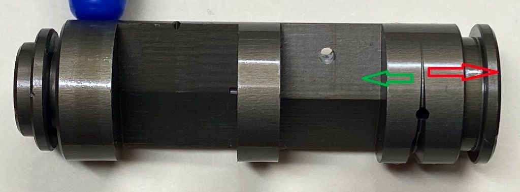

So towards the end of two weeks leave from work I decided to put that new throttle body on the 200cdi and give it a run as I haven't flown the Aries 07 for a long time. So I did the carb swap, took it to the field and it was a bit cranky to start but after I got it going and messed with the needle a bit I let 1/2 tank run though it and though I'd give it a flight. During that ground fiddling I noticed the needle valve getting a bit wet and a bit of pink (now running Klotz KL-198 oil) fluid forming drops off a few parts. I put up two tanks through it in that air just general flying as the engine really is still "new" and each time had to wipe out a pool of raw fuel in the bellypan. Day one partly successful, engine worked ok but something's not right?
Morning of day two, pull the engine and go over everything checking for leaks, double check the usual suspects and generally waste another few hours spinning spanners on this piece of fecal matter. Wash it thoroughly in methanol and dry it off so it's completely "dry" outside, remount it, fuel it up and run it for about 5 seconds and check if anything is getting wet. Well yes wet it was getting. Just the tiniest bit of reflective glare coming off from where the needle vale body bolts on to the cab body. Quick wipe, a 15-20 second motor run and it's dripping fuel again but at least I know that fuel is not coming from anywhere else.
So I block the injector line and pressurise the fuel supply to the throttle body and fuel starts running out from around the carb barrel. A brand new throttle body I bough 18 months ago to replace the one I had been bodgying up trying to get it working right. The video is just air and a bit of soapy water but you get the idea. The seal can't be perfect but it shouldn't be leaking fuel either.
I've had bad YS parts right out of the box including a cdi sensor that worked at hand crank speed but not at starter speed(???) but my luck with this DZ200cdi is something special. Now it's been run, I have to pull this engine again and flush it for proper storage. I've got a sweaty body part that YS can apply some vacuum to with their mouth right about now....
Edit: Sometimes it's good to vent. Replaced the o-ring on the barrel and no more leaking,,,,to the outside at least. The cynic in me is guessing it's leaking that fuel into the motor on the non-o-ring side now. Weather is bad today and club has an ANZAC day event on Friday so Saturday afternoon might be the earliest I can give it a proper run. Fingers Crossed!!

I was just going to say I reckon it's the O ring, there's nothing else it can be. As an aside, I very, very rarely replace that O ring. Just every now and then if I think of it and can be bothered taking the barrel out 🙄 Never had a leak there though.
Not sure what you mean by leaking into the engine on the non O ring side?
The only barrel issues I've had is an incorrectly machined one. It wouldn't throttle up at all, was very rough in the mid range and wouldn't throttle through.
Oh and the pesky bottom right carb housing mounting lug breaking, which has only happened on my 200's, no other engines. Over stressed maybe 🤔 I've had half a dozen break, but I've got that sorted now 😬
Back plates used to be problematic as well. The wire would break at the hard joint. I had a few of those in the early days, but have that sorted as well. Haven't replaced a back plate in around 8 years now.
A couple of things:
Sounds like a too rich problem.
Is the break in needle open?
Breaking in doesn't need to be prolonged. I run 3 tanks (330cc) through on the test stand at rich settings, then gradually lean it during the 4th ending up at the tune for normal flying.
Put it in the plane and fine tune as required.
Looking forward to hearing how you go. More than happy to take a look if it's still not right 🙂

In a world of perfect clearance, all the fuel should stay in that tapered slot, then follow the deep groove around to the outlet on the other side which goes up to the injector. I figure if there's enough clearance so that fuel is happy to leak out of that slot in the direction of the red arrow only to be stopped by an o-ring (not fitted in the picture), then it would be equally happy to leak out of the slot in the direction of the green arrow into the crankcase.

I think it's fair to assume there is some fuel going inwards along the direction of the green arrow, but it would just end up going up the intake tube and into the cylinder. I doubt it's much and any effect it may have, would be taken care of by tuning.

Agree re sloppy barrel/throttle body fits and I followed previous posts and your own by fitting O rings to the barrel.
Seemingly you've abandoned that system - ??
