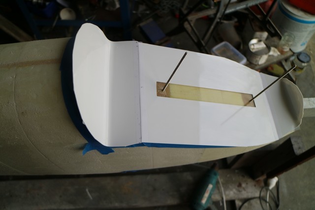

Got the chin cowl spacer done. Took a bit of head scratching to work out how to do it with only 2 hands. Doing the release agent now. I use Chemtrend Chemlease 75. Quick and easy to use.
ID:	2258675   Click image for larger version
Old 03-09-2018 | 07:29 PM
  #30
RodneyFord's Avatar
Joined: Apr 2015
Posts: 424
From: Lower Hutt New zealand
Got the chin cowl on. The threaded rod works well to hold things together. Now I can glass the fuselage.

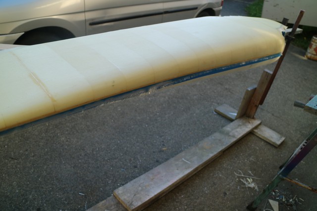

The cowl popped off nicely and I have made some adjustments and given it a light sand (if you can call 40 grit light). It really needs the upper nose air intake which will go on after the glass which is today's job.

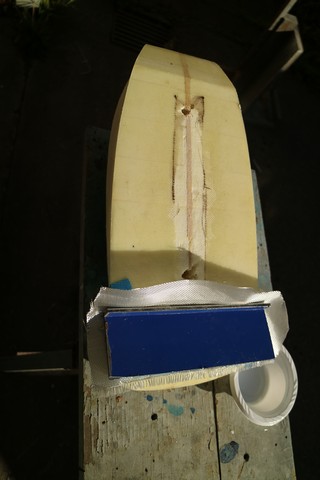

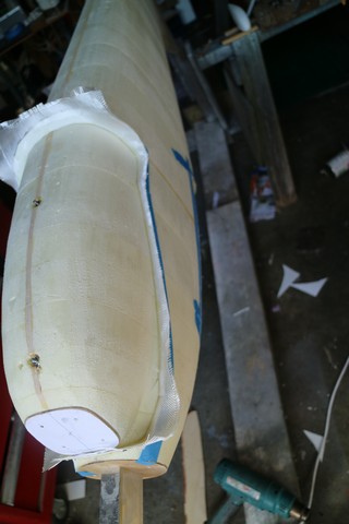

Got the glass down on the first side.The seam will be over the balsa on the center line. There is no way of sanding out joins over foam. I got it down nicely but had to keep working it with a roller and heat gun during the cure. I had forgotten the cut out in the chin cowl for the UC so got that done.

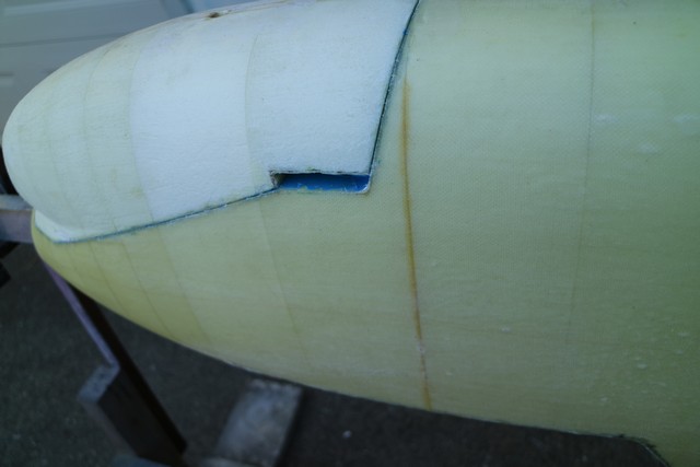

Cutout in chin cowl for UC leg. I way prefer this method of mounting the UC. Easier lighter stronger.

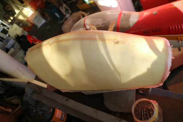

Sanded off the high spots with 40 grit. Added a layer of lighter 100gm glass.

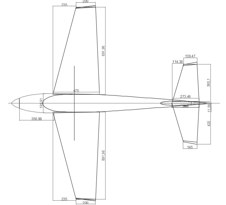

Old 03-12-2018 | 03:29 PM
  #35
RodneyFord's Avatar
Joined: Apr 2015
Posts: 424
Finishing the plug requires quite a bit of watching paint dry. So I'm going to get on with the flying surfaces. The wing is reasonably big at 69.15 sq dm (1071 sq in) as I want it to weigh 5kg. Foils are SD 8035 12% root 10% tip. Stab will be 25% wing area and SD 8020 10%. I don't know the wing position yet. I'm going to build the model and then install the wing so the CG is just aft of the neutral point. The Stab is going to have big elevators so I can keep it as far back as possible. Servos will be at the front.

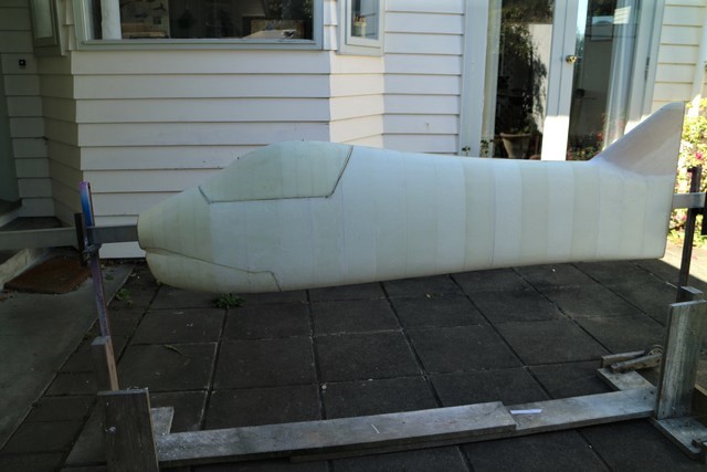

Got all the glass on and gave it a rough sand. Put on some undercoat to see what I was up for. No big issues there so it won't take too long to get it into shape. The undercoat has helped to pull the look together, just need to get the upper nose air intake on now.

Big Bosch orbital sander makes short work of the sanding task.
