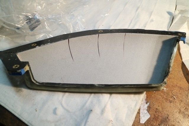

Old 04-25-2018 | 06:04 PM
  #88
RodneyFord's Avatar
Joined: Apr 2015
Posts: 424
From: Lower Hutt New zealand
Aramid scissors
In the bag. High elongation vacuum film.

Gone to one part at a time. Lowered the complexity level and raised the quality. I am using PVA release agent for this part now. After some research I tried spraying 3 coats of water/detergent mix into the mold first to lower the surface tension and allow the PVA to flow. PVA is thinned 25% water 25% alcohol. Seems to work. Layup is 50gm glass 2mm rohacell core 26gm glass on the inside, a bead of microspheres and a tow of 24K carbon in edges of the flange. Deresined the 50 gm before inserting the rohacell. The 26gm inner surface is a separate operation which makes it easier and cleaner. Electric blanket to cure the resin.

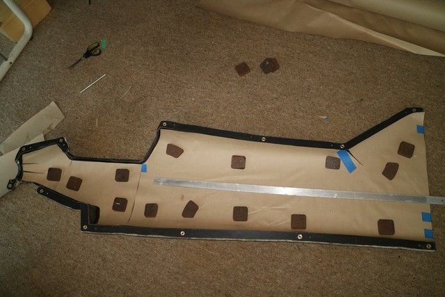

Nearly ready to lay up a fuselage (finally). I'm going to have 50gm glass/rohacel/26gm glass from the tail to the canopy and 26gm glass/34gm kevlar/rohacel(1.5mm)/26gm glass from rear of canopy forward also local carbon reinforcement for the wing UC and motor mounts.
Rohacel heat forms easily with a heat gun and a hot glove.
Heavy brown paper patterns for the Rohacel and fabric.
