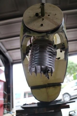

I've taken the head off the DA50 to lighten it. DA says they take off 4 oz but I doubt whether I can.
Lathe work done next it will go on the mill.
I had to make a fixture to hold the cylinder for machining.

In the rotary chuck.
83 gms difference.
Old 05-29-2018 | 05:08 PM
  #144
RodneyFord's Avatar
Joined: Apr 2015
Posts: 424
From: Lower Hutt New zealand
Quite a different look.

Cheers Jim. Working on the engine mount.
Mock up of engine mount to see if it works.
Tilting the engine 10 degrees for exhaust clearance. There is lots of room in there though.
