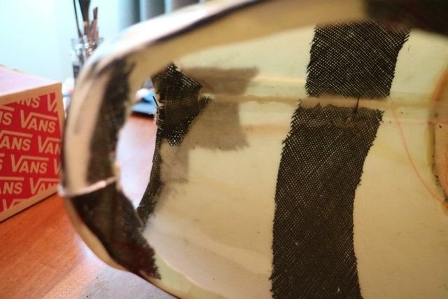

The front end is 1oz kevlar over 3/4oz glass. The corners have carbon rovings and epoxy/microballoon mix in them.

Kevlar reinforcement for the tail wheel and I may put in a ballast box to tune the CG.

These flat sections also had a rohacel core.
Old 05-21-2018 | 02:51 AM
  #114
RodneyFord's Avatar
Joined: Apr 2015
Posts: 424
From: Lower Hutt New zealand
Not sure where the wing tube will go. That will depend on the balance. The rear end used 75gm glass instead of my original plan to use 50gm. It is much more ding resistant and not a big weight penalty. The entire fuselage is cored with 1.5mm rohacel, it is very stiff.
