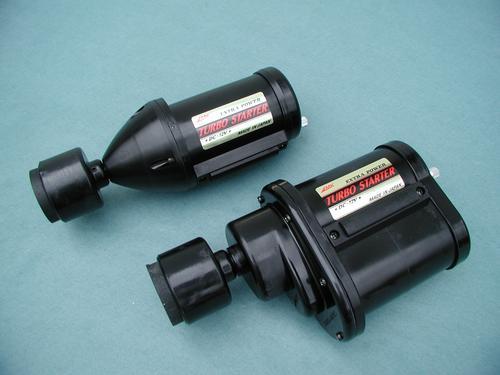

Hi
This engine needs a powerfull starter.
I start it with twin turbostarter Kato and a batterie 12V. And I apply this procedure :
Open gaz throttle (without glow connect it's very important) and run engine with starter until fuel come in engine then I close gaz throttle.
Put glow plug and connect to batterie 2V, but I connect just a wire on batterie + or -.
I run engine with starter and put the other wire. It's easy with a friend who connects wires.
I did a lot of start (above 150 ) with this procedure without any problem.

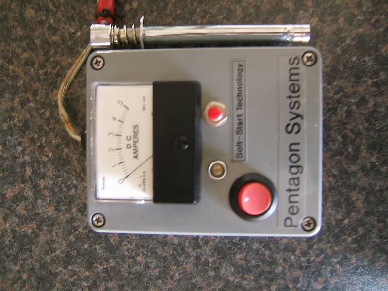

I have designed my own "soft start technology" glow driver which works an absolute treat for DZ engines. I would say it is almost a must and you can go flying on your own.
You can use it as a conventional glow driver by using the ON/OFF switch or you can simply press the RED button which turns the driver OFF from anywhere between 1-10 seconds by adjusting a pot. It uses switching regulator technology which is more efficient and can deliver up to 5 amps which will burn of excess fuel in any flooded engine.
The analogue meter is also a must because it tells you exactly how wet the glow plug is. For example when I prime the engine I expect the meter to sit at 4-5 amps until the fuel has burnt off and then it should settle at just over 3 amps when he plug is dry. I know if it isnt drawing 4-5 amps after a prime then I know that no fuel has got to the engine.
I have built a number of these for friends and they are most impressed. I have no plans to manufature but I could be tempted if there is enough interest.

Peter-- That sounds like the solution for us two handed non-juggler types. I would be interested. If you don't feel like making one (or more) do you have a schematic. I am pretty good with a soldering iron.

I still want the "soft start" driver from Down Under.
