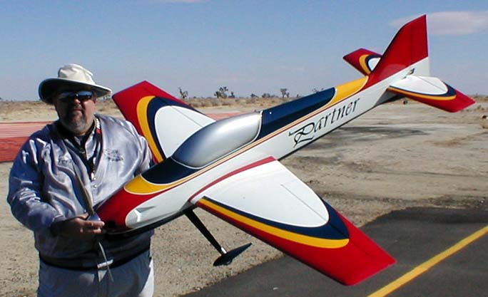

Well, I started this model on December 22, and I finished it last night. After flying it last Sunday, I tore it down and started painting on Monday. The clear was sprayed on Thursday, and I geared it up, as I said, last night. Boy, it's hard to beat the basecoat paints! The paint job added 4.5 ounces, which is pretty good for a fuse as big as this. Right now, the total weight with the 10s4p pack is 11.4 pounds. Over by 7 ounces or so. But I think I can save that weight by replacing a few things and lighteneing here and there. I bought one of the UBEC's to replace the onboard RC battery. I will install it into my Funtana that has a Hacker system in it just to test the concept. If it works I'll install a pair into the Partner. That alone will save 4-5 ounces. An aluminum adapter nut for the spinner will save another 3/4 ounce. I'm looking at JR 3421SA servos for the elevator instead of the 9411SA's I have in now, and that will save a bit.
But of course, a 10s3P pack like Jason used will lose 12 ounces, and that will put it very comfortably into the weight limit. Almost too light, really. And the next generation cells I'm sure will come down in weight.
This has been a really fun project. I've enjoyed everything about it. Now if the wind will just lie down out here I can get some more flights on it!
Here's one pic, I'll post more detailed pics when I take them.
Thanks!

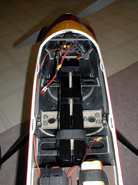

Here are a few more pics of the Partner. These two show the equipment and battery installation.

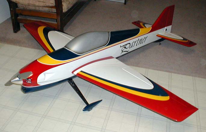

And here are two more of the color scheme.
So far, with only 6 flights on it, most in really poor wind conditions, I can't yet say if the thrust angle is absolutely correct. But I certainly have not yet seen a need for more then the stock amount. I'll get a better idea when I can really do some fine trimming on the model.
FLYERSG,
I suspect the model that you electrified may have had the incorrect thrust angle in the design. Had you ever flown one of those in the original glow version? It's very possible the glow had insufficient right thrust to start with. That is a common design flaw in many models.
