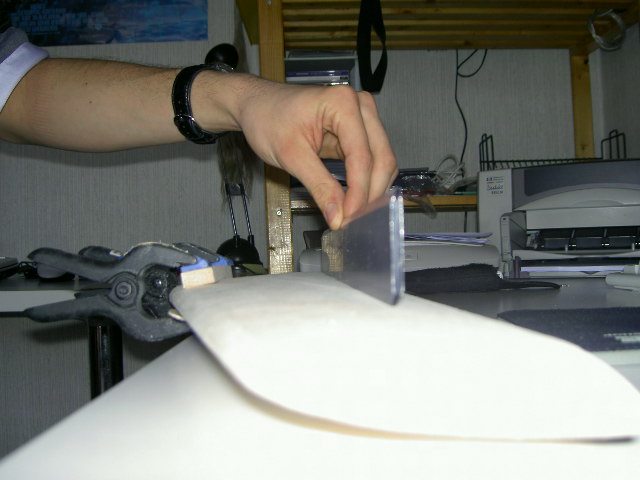

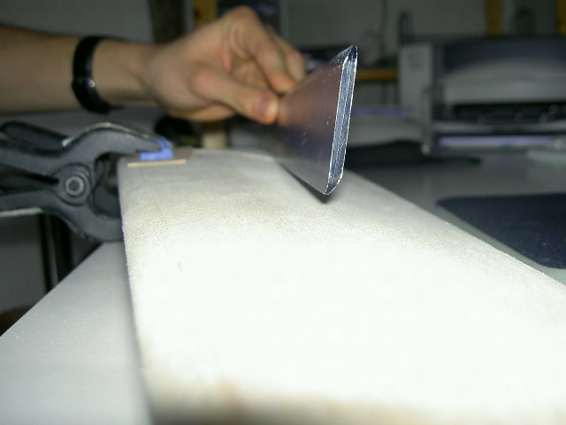

Sorry to dig out an older thread, but I'm concerned about a possible mistake I made while building my Eclipse.
My question: does your stab have a dihedral built into it? Mine looks like probably it has, as the upper side is flush and the under side has a small but noticeable dihedral. No notice of this was found in the instruction sheet provided, so I ask. If it is so, I built the stab upside down... []
Could someone please check that for me? Thank you in advance.

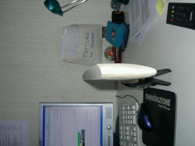

thanks for replying. I'll add pictures for clarity. I'd be glad if you could check that one out, before I start cutting the bevel on the trailing edge of the stab...
-Fabrizio

Fabrizio,
I would mark the centerline of the trailing edge of both stab halves. Then install the stab halves in a short tube so that the stab roots join together. I visually sight the TE centerlines with a straingt edge to check the dihedral. Another way is to install a short tube in the stab halves and mount them in the stab bottom side cores. You can then measure the height of the stab to the centerline marks. This should tell you how much dihedral you have. If the difference is less than 1.0smm than I would use the stabs.
I usually check my dihedrals (visually) on my stabs before I install the stab tube sockets. By the way, I just now checked for you one of my stabs from an old Eclipses. It has no dihedral in it.
Hope this helps.
Steve

Steve,
thank you very very much. Height difference appears to be about 1.5mm on either side measured from the centre line at the trailing edge of both stab halves. I'm probably going to cut the balsa bevel I previously sanded and replace it with some balsa in order to sand it on the other side. Luckily I didn't install plywood reinforcements on the under side (now upper side), so it won't be a big problem, just more sanding... Luckily also that the moving parts are almost equal, so little work to adapt it to the "wrong" half but no cutting and sanding there.
This doesn't yet solve the problem: where is my "dihedral" coming from? I don't think that the folks at CA changed the way the halves are built, so I guess one (or both) of my stab halves has some sort of error. I will make more tests with my stab and search for the root of the problem. I don't think it is a big issue, but I'm interested in knowing what went wrong and where.
Thanks again for your help, thanks!
-Fabrizio

Steve, UAL
thanks for your concern. The pictures from a couple of posts ago were taken with the supplied stab tube installed and fully inserted, so that the root of one half touched against the root of the other half. I did so hoping to sand them in parallel, to ensure that both had the same height and length. So the dihedral seen in the pictures is the dihedral that is built into the stab, no more and no less*. Bending the aluminium tube is not a good idea, since the phenolic inside the fuselage would not be very happy about that... So I probably will cut both bevels away and re-install 10mm light balsa sheet and sand the bevel on the other side. Thanks for the information, I'll let you know if this unwanted dihedral is of any help, I might as well want to build another stab so to have a backup in case this one doesn't work at all. I still believe the concern is minor, but flight tests will eventually prove me wrong (I hope not!).
I'm hoping for first flight on land in mid-may and on water for our international F3A-H (hydro) competition in september. I'll keep you updated, I like this plane very much and hope it'll fly accordingly!
Regards,
-Fabrizio
EDIT: *what struck me was that the upper side was exactly flat (see photo #2), like a wing. This is why I asked in the first place...
