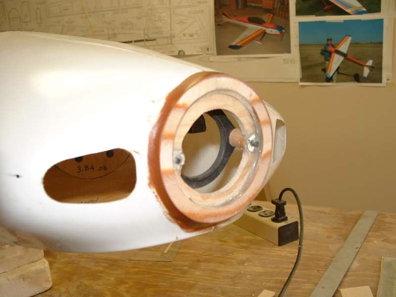

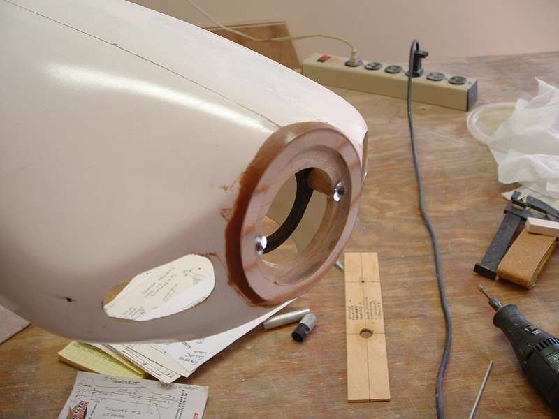

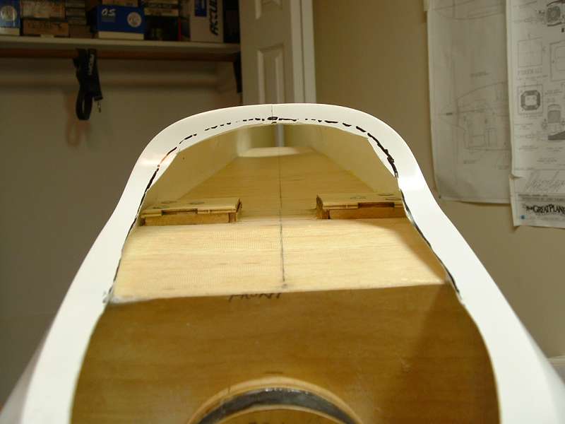

In a sister thread, we have two camps on the quality of the Eclipse. This thread is intended to exchange building tips on the Eclipse or Fantasy. Here are some modifications I am making to my #2 Eclipse. These modifications follow the same building techniques I have used on my Smaragd-z. I hope to achieve the same flight performance as a Smaragd. My #1 Eclipse flys well, but these modifications to the set-up dimensions are intended to achieve the following:
1) Better balance for CG
2) Better dowlines
3) Reduced roll couple with rudder

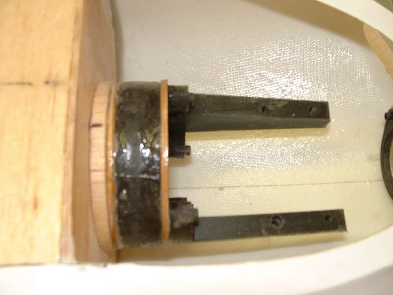

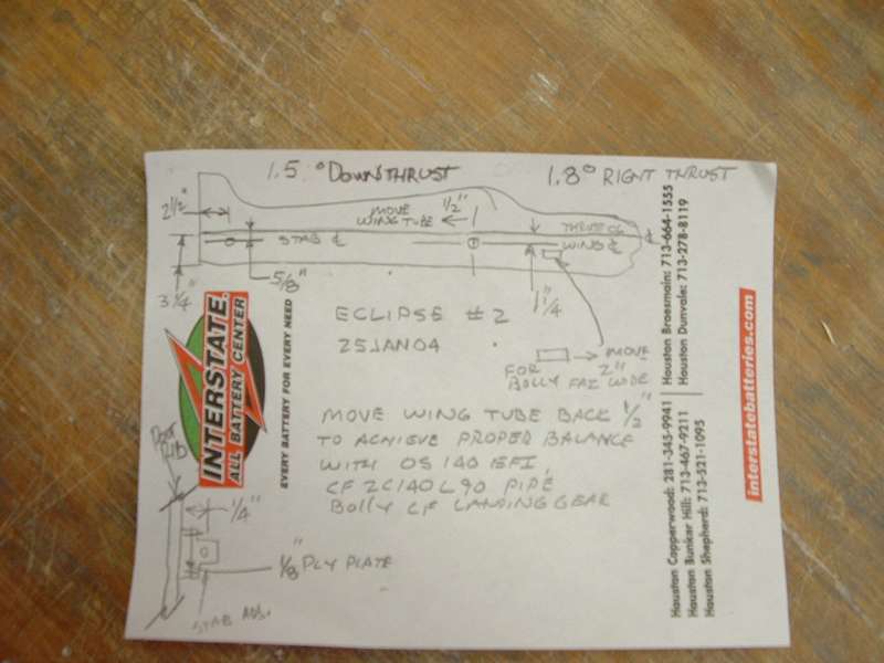

Please review my pictures and advise your comments. I believe an objective discussion will help the building of all pattern planes.
picture #1 shows the mounting blocks for the Bolly landing gear
picture #2 shows the location of my mounting blocks for the Bolly FAI wide landing gear (swept back gear)
picture #3 shows the set up modifications I have made (moments closer to my Smaragd)
picture #4 shows my thrust alignment nose ring to reduce the down thrust to 1.7 deg and the side thrust to 1.8 deg

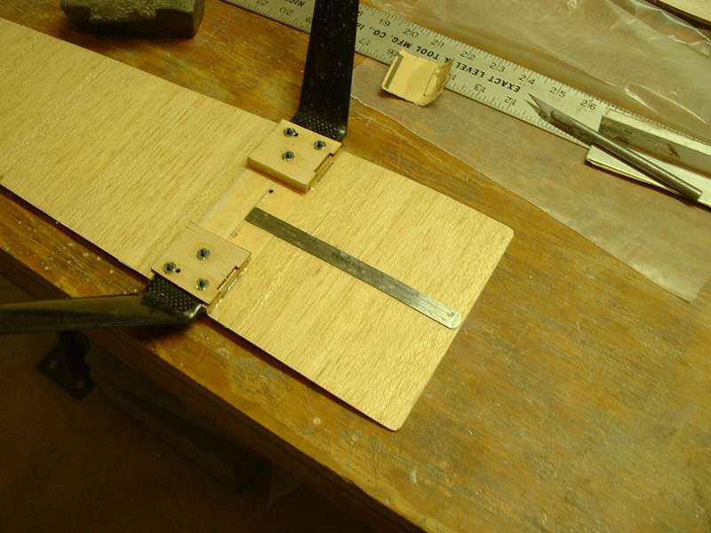

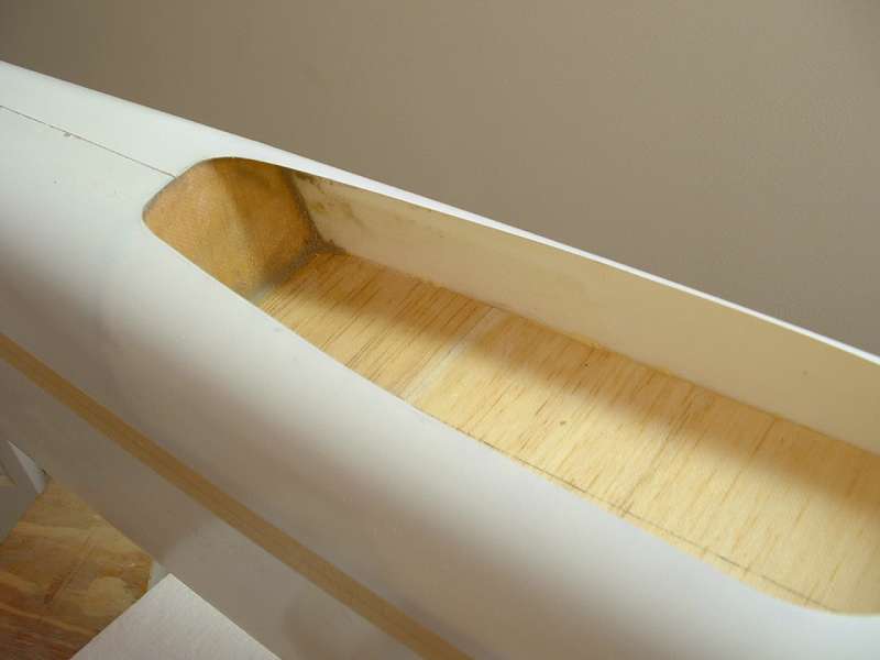

Here are some more building photos:

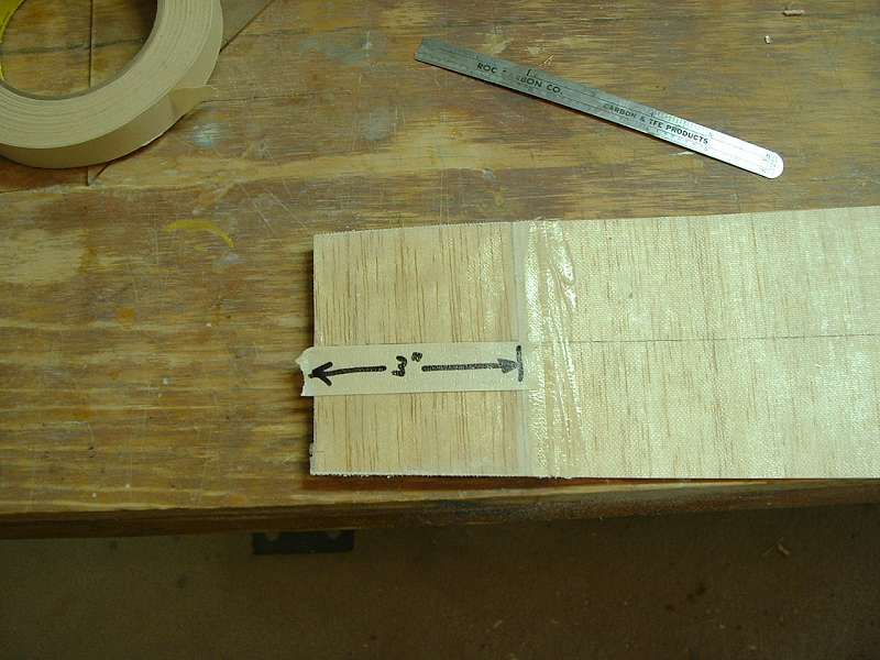

Picture #1 shows the floor pan extension needed with using full pipe to baffle length of an OS140 and a ES2C140L90 pipe
Picture #2 shows the floor pan extension and fuse cut-out for the ES2C140L90 pipe
Picture #3 shows the horizontal stab bulkhead
Picture #4 shows the Bolly FAI wide landing gear being fit-up

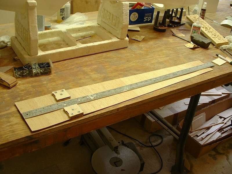

Here are some more building pictures:
Picture #1 shows the mounting blocks after installation
Picture #2 shows the extended floor pan before installation
Picture #3 shows the landing gear plate reinforcement with the fuse. Note the 1/4" balsa triangle stock used to help adhere the floor pan with the fuse. This adds very little weight when using ProBond
Picture #4 shows a typical elevator pull-pull servo mounting

Default RE: CA Model Eclipse building tips
Please keep the info and pics coming! I'm starting my Eclipse this week.
These are the changes I see you doing. Are there more?
1. change dn and rt thrust
2. move wing tube 1/2" back
3. move stab c/l down 5/8"
4. Bolly cf gear
5. Elev servo in fuse for cg

What is the thrust angle that was molded in your fuse?? The instructions on the CA Model web site say
" It gives aproximately 1/2 grade of negativity and 1.5 the right trhust."
I assume that means 1/2 degree dn and 1.5 degree rt. are already molded in.
Old 02-13-2004 | 07:38 AM
Joined: Sep 2003
Posts: 62
From: Houston, TX
My Eclipses had between 2.1 deg and 2.3 deg down thrust molded in.

Before you add a shim, you may want to block up the plane and set the 0 - 0 degree on the engine thrust centerline reference. After I set the plane to the 0 - 0 reference, I then measure the down thrust molded in the fuse. In my case, I have a digital level, so I can get to within 0.1 degree accuracy. I then use a draftsman right triangle and put one side on the vertical molded in nose area. I then put the level on the horizontal side of the right triangle. Then I add shims to the triangle to set the required down thrust. In my case the shim turned out to be around 1/16" thick. Good luck.
Steve

Here are some more building photos.
Photo #1 - shim for setting proper wing tube alignment with the elevator
Photo #2 - shim for the wings to set proper alignment with the fuse
Photo #3 - installed rudder servo tray, Gator RC black tube for elevator servo leads, Sullivan gold-n-rod red tube for the receiver antenna wire
Photo #4 - front fuse spinner nose ring and the engine retainer ring installed

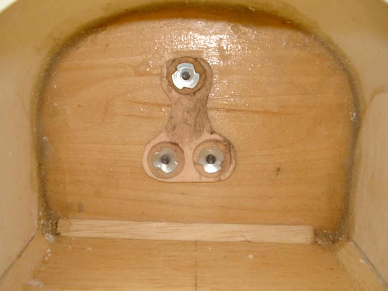

Here are some more photos.
Photo #1 - PBG carbon fiber wing tube socket installed
Photo #2 - typical engine mount blind nuts "dog bone". A "dog bone" is used to allow repositioning of the hyde type mount
Photo #3 - typical home made hyde type mount. This mount is my set-up mount. I will fabricate another for the final engine installation
Photo #4 - shows the engine retainer installed from the engine bay

Thanks for the pics Steve. Are you concerned about being tail heavy with elev servos in the tail and an OS 140 up front?
Did your first Eclipse come out ok balance wise?
Also, is the std OS header the right one for this plane??
Old 02-15-2004 | 02:25 PM
swk550's Avatar
My Feedback: (76)
Joined: Apr 2003
Posts: 501
Received 10 Likes on 9 Posts
From: Houston, TX
On this Eclipse, I have moved the wing tube back 1/2" to achieve proper balance when using individual elevator servos. On my first Eclipse with the pull-pull cable on elevator and the wing tube at the standard location, I came in very tail heavy. I had to put the battery on the fire wall and still had to add 3oz of lead in the nose. Moving the wing tube 3/8" would have solved my problems. My 1/2" move allows for the extra weight of individual elevator servos. I do keep the weight down by using the BPG CF wing tube and the bolly FAI landing gear. These two changes saves 4 to 5 oz in weight. All in all, I project the weight of the plane to come in between 10# - 0oz and 10# - 2oz.
Steve

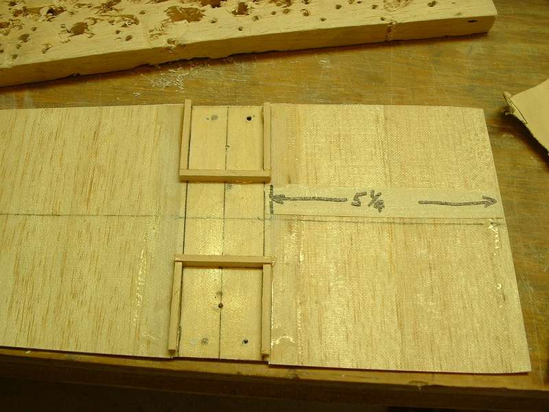

When you are using wing bolts to hold the wings in place, only one wing adjuster per side is needed, I do use two wing bolts per side. One in front and one behind the wing tube.
Picture #1 - Is an installed wing adjuster in my Fantasy. I use the slotted plywood plate and screw on the wing adjuster. After I rough align the wings, I epoxy the wing adjuster plywood plate to the fuse.
Picture #2 - This is an inside view of the wing bolts and wing adjusters from my Panacea. This shows the relative location of everything to the fuel tank and wing tube.
Picture #3 - This is a picture of the wing bolt and nylon wing nuts I use.
Picture #4 - This is the locating dimensions I used on my Panacea. I use the same locating dimensions from the wing tube centerline on my Eclipse.

Last weekend I got another five flights on my #1 Eclipse. The plane is not trimmed. I'm ready for the 2004 Pattern wars. I've got some inspiration to continue building my #2 Eclipse. Below are some photos of how I install the chin cowl. It's a tight fit to clear the OS140 EFI fuel injected carb, but.................it can be done. I use #4-40 soc. hd. cap screws with Loc Tite.
Picture #1 - This is the hard 1/8" plywood plate after it has been epoxyed in the fuse engine bay.
Picture #2 - This is the finished hold down plate with the OS 140 EFI engine installed. I have never had a problem with the carb touching the fuse when I leave the 1/8" clearances as shown.
Picture #3 - This is the chin cowl hold down plate. Please remember to trim to clear the carb.
Picture #4 - This is the chin cowl trimmed and mounted. The #4-40 soc hd cap screws must be cut to length to not interfere with the EFI carb.
Good luck.
Steve
