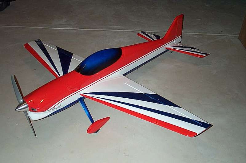

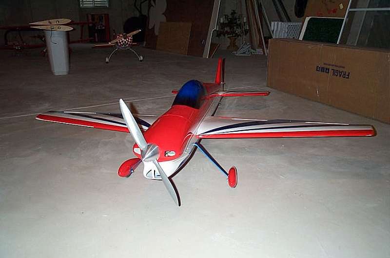

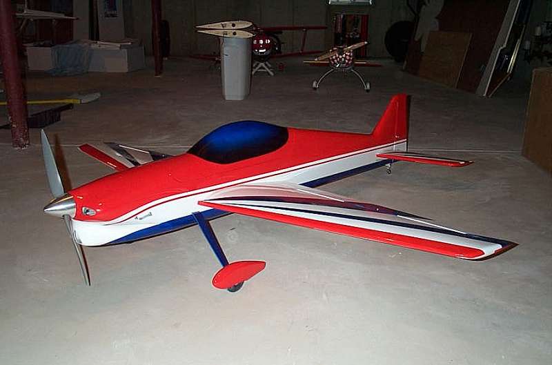

Steve, Thanks for all of the help on this thread. Just finished mine today. A little heavier than I hoped at 10lb 12oz, but I used the stock landing gear & wing and stab tubes. I moved the wing tube back 1/2" and stab 1/2" down. Set up with std pull-pull rudder and a single elevator servo. JR 8411 elevator and rudder 9411 on ailerons and 537 throttle. 5 cell 1450mah pack w/6v regulator.OS 140 and Bolly MF590. Monokote and PPG paint. Hope to fly this weekend. Thanks again

Well I snuck out and made 2 flights today. Already I can say this is an excellent flying plane. The OS140 is plenty of power, even running it very rich and using a Bolly MF590 muffler not a tuned pipe. For those thinking about buying one at $499 it's a great deal. I highly recommend the mods listed in this thread as far as moving the wing back 1/2" and stab down 1/2". You can definitely get the weight down too by going with the carbon wing tube and carbon landing gear. I have it balanced just aft of the repositioned wing tube, and it needs just a little down elev when inverted. Knife edge seems to be very true and no pitching to the top or belly. Loops and corners need just a touch of right rudder. I may just order another one next week.

I put on 3 more flights this weekend. Looks like the cg is a little forward. I have it at 6 5/8" from the leading edge measured at the root, and I need up elev trim for level flt (4 clicks). That also causes it to pull to canopy on vertical down lines. Question for Steve: Where are you flying your cg? Thanks

I am flying my CG between 1/4" behind the center of the wing tube (almost to the rear edge of the wing tube). My Eclipse is perfect on the down lines. Also you may want to check your wing and stab incidences relative to the thrust line.

Thanks. The pitch on downlines is pretty minor, so I'll raise the wing incidence first to get rid of the up trim before I start moving the battery around.

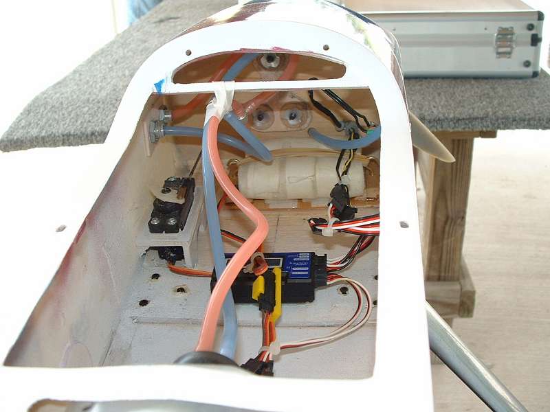

I finally finished my #2 Eclipse. The CG is 1/4" behind the center of the wing tube. The plane has dual JR DS3421 elevator servos. It came in a tad bit heavier at 10#-5oz. You can not tell any difference in the air. The plane flies every bit as good as my #1. These planes are well worth looking at. Here are a few pictures.
