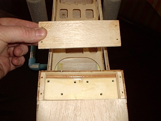

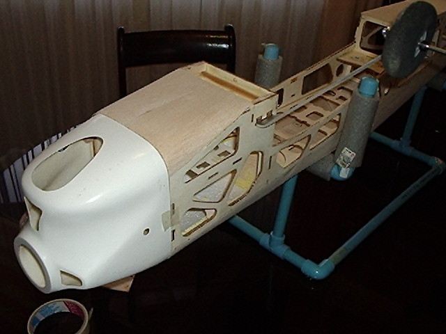

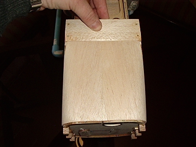

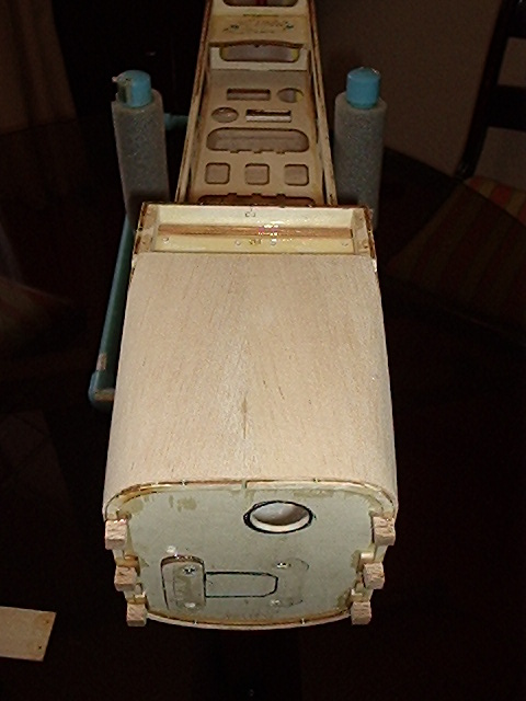

i finish my wing.
here more pictures of the landing gear position

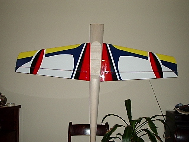

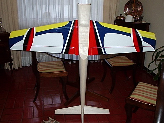

40 piece of monocote on up side.

Wow that is a great design on the wing.

How do you guys overlay all that monokote so nicely?

That looks very good El ****cano. What kind of screws or nuts did you use on the gear?

tph1
6 screw 1/8 with his nuts and the bigger washer a can used.
Sprink
the design is a copy of Partner model of PLPROD.
LVB
1.- draw the design on a paper 1:1 to the wing
2.- cut all the piece
3.- que alguien me traduzca " cuidado cuando monocotea de no dejar una union en contra de viento, siempre el que monta tiene que quedar a favor del viento.
4.- a lot of time

OK thanks Sergio

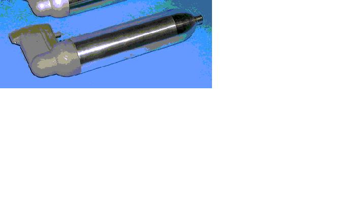

Hey EL ****CANO,
Can you say if the Performance Specialties Ultrathrust muffler which is 9 1/2 inches mounted on the OS .91FX would fit in the location for mufflers on the Epsilon? The whole length appears to be behind the exhaust stack! See picture: Thanks,

And that last lil blurb that Sergio asked to be translated is "make sure when you cover not to let the seams go against the wind, always have the seams going with the wind" (so that the edges won't lift)

GARYss
the g90 super tigre muffler have 6 ". more longer i think have problems with the landing gear suport. maybe 7 "[&:].
