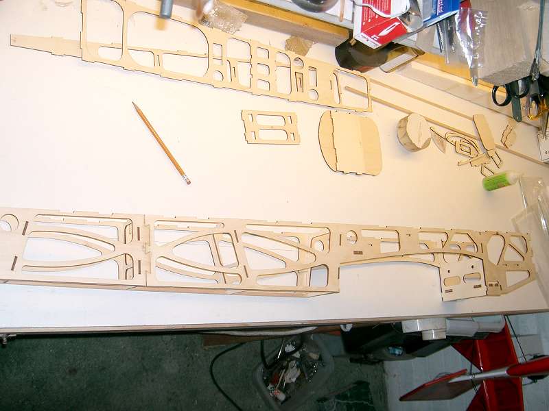

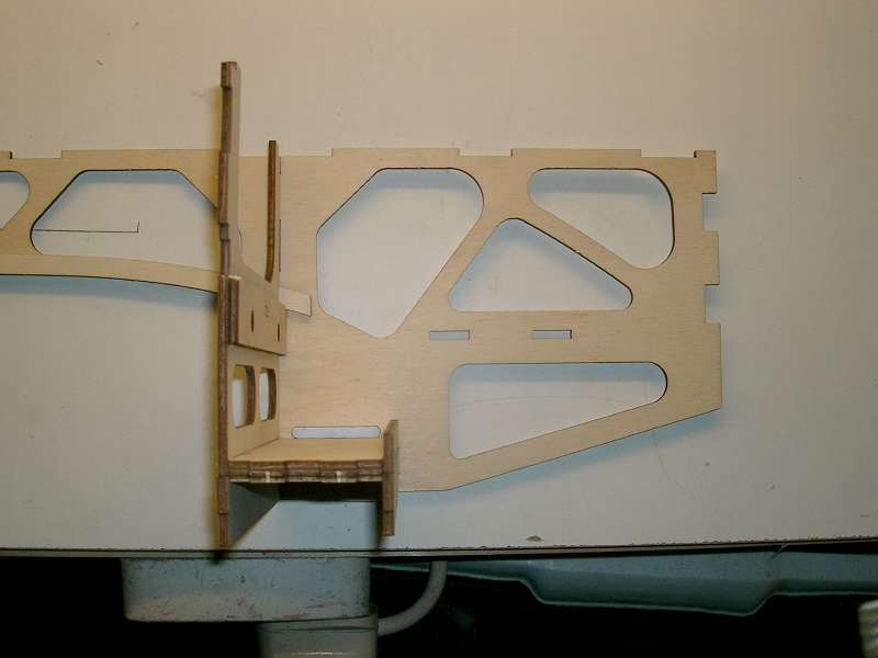

At last peeps I have had a chance to start building my Epsilon

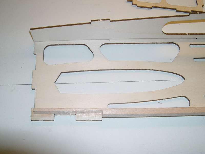

First off glue all double formers together.
Joined: Feb 2003
Posts: 150
From: rugby, UNITED KINGDOM

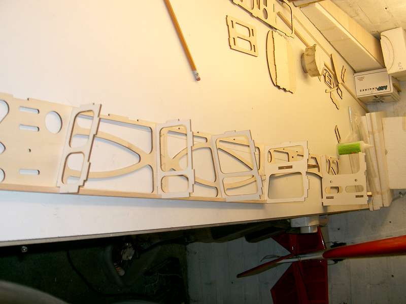

Then we join the sides together and put the 1/4 square along the bottom of the fus and put all the formers on.[img][/img]
We then need to make sure all is square and tight
[img][/img]

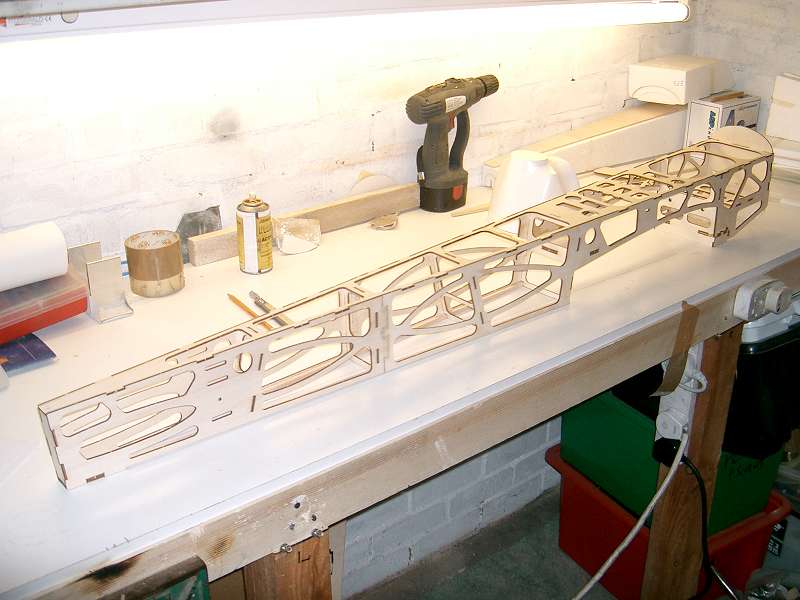

We need to make sure there is clearence for the double F9 tailwheel support. I trimmed the 1/4 balsa for a perfect mechanicle joint.[img][/img]
and just drop the other side on

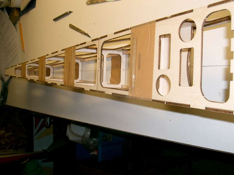

[img][/img]

Tip the fus over ( Trying not to let it all fall apart doh!) and place the top rear on followed by the top front and tape all together firmly. I then turned it back over and taped the bottem up tight so nothing could move
Place fus on line drawn on workbench an line up all the little marks in the bottom of the formers to ensure you have a perfectly sqare fus (Nice thinking CA models [8D] first time I have seen this idea and I have built between 30 and 40 models in my time!!)
And the fun bit begins squirt cyno everywhere wood touches wood and its all together![8D]
Then we stick F1 on with epoxy and the front turtle deck again with epoxy.....measure back and epoxy the rear turtle deck on....hey presto starting to look like a plane all ready!!

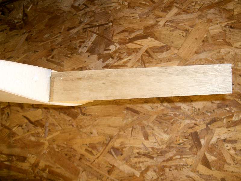

First off fit the leading edges to both panels and the wing tips when dry sand flush at the root
Next ensure the wing roots join perfectly with a 4mm diheadrel....all I did was to use a thin piece of spruce that was 4mm thick with the wing top down and sanded the root square.
Repeat on other wing. Take the ply diheadrel brace and ensure this fits tight and allows for the 4mm diheadrel. test measure test check look test look....right happy with that[8D]
Next is to glue the brace in one wing half and let it cure. then glue the two wing halfs together having marked where the aileron servo leads will emerge at the centre and leave to set weighed down so it cant move!
Come back the next day and Put the fibreglass tape on with epoxy and leave to cure....if you look closely you can see where have painted epoxy further out into the wing...this spreads the load at the joint next to the tape and strengthens the wing substantialy.[8D]

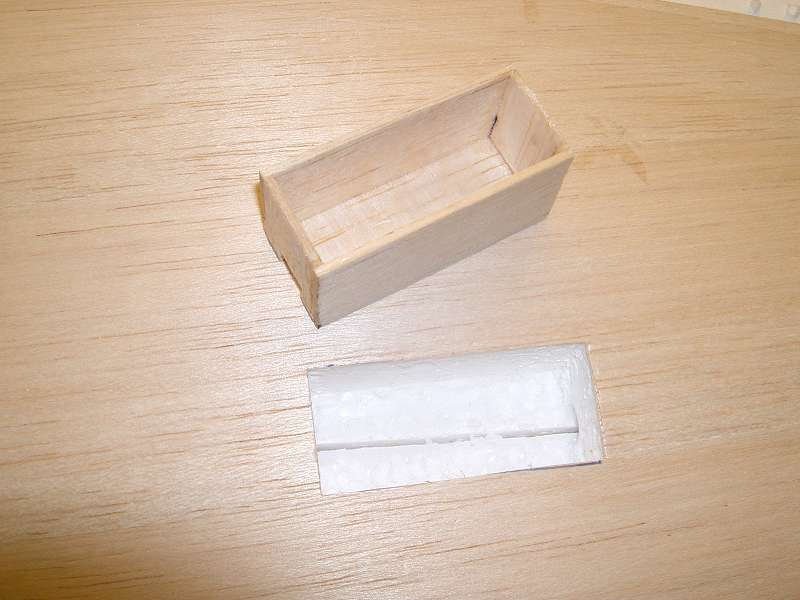

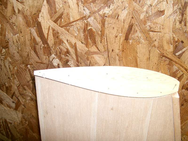

Mmmmm nearly got a wing now!! just make the aileron servo boxes and cut out
the ailerons face and tip all parts and presto a wing complete.
When facing the ailerons and the wing where you have cut out take care to
get the point of the balsa section central as this will affect both where
the aileron sits on the centre line as well as the way it hinges.

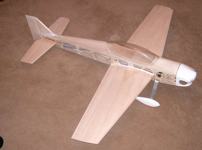

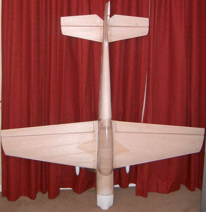

Haa haa got my camera back so heres some piccies...
Between the real flying opertunities this weekend
I managed to get some serious building done ..... and well it's finished!!
Just need to decide on a decent colour scheme now and it'll be flying .....
well probably a couple of weeks after the babies born anyway .... I somehow sense my priorities changing a little soon!![X(][:-][X(]

That looks superb. Looks like a good candidate for a cheap 80 quid ASP 91s, or a nice saito.....or the new RCV 91CD

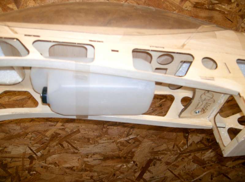

I have a Saito 100, which will need a new home. It is either the epsilon or the GP extra 300 60. Will decide in the summer. If I go for the epsilon, I'll probably try to get the 24% extra from CA as well.

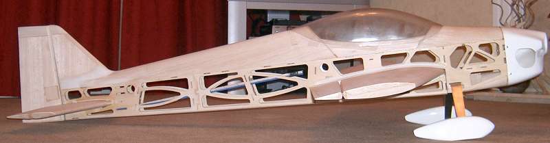

One question. Trying to determin from the photos whether there is room for the tank on the CoG. Any thoughts?

If weston start importing it'll be awsome for us brits as CA do do some amazing value models....if you work it out you can get a fantasy for between £400 to £500 pounds and that is alot of plane for you money
Sprink I can take picces of any part at you request as I wont have a chance to cover it for a while but as for room for a tank on CoG easy
I rekon you could get a 20oz tank in!!
If you look at the side on pic you will see that the base of the cockpit is built up giving you tons of space
Luke funny you mention the ASP that is exactly what I have gone for....I do have an OS as back up though IF the asp turns out pants[:@]
But looking at it I rekon it'll be spot on ..... I think I'll bench run it in soon so I'll let you all know

Right got piccies
First pic is of a 20oz dubro tank (thats for another project that I shall reveal all later![&:]) in the middle of the wing seat so with a bit of hacking you should get any tank in.[8D]
Second and third shot is of cowl mounting and you can just see how thin the cowl is about 0.5 mm as can be seen by the close ness of the frame to the edge of the plane you can also see where I have backed up with triangle on the thicker piece of ply.
