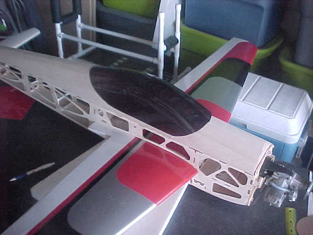

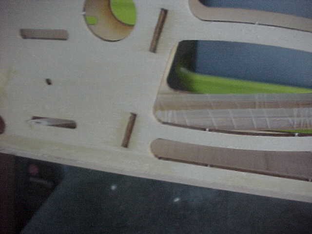

Default RE: New CA models Epsilon build (easy as pie)
Here are a couple of pics in the ARC stage. Also a pics of the DEPS
It is glued just inside there at the former

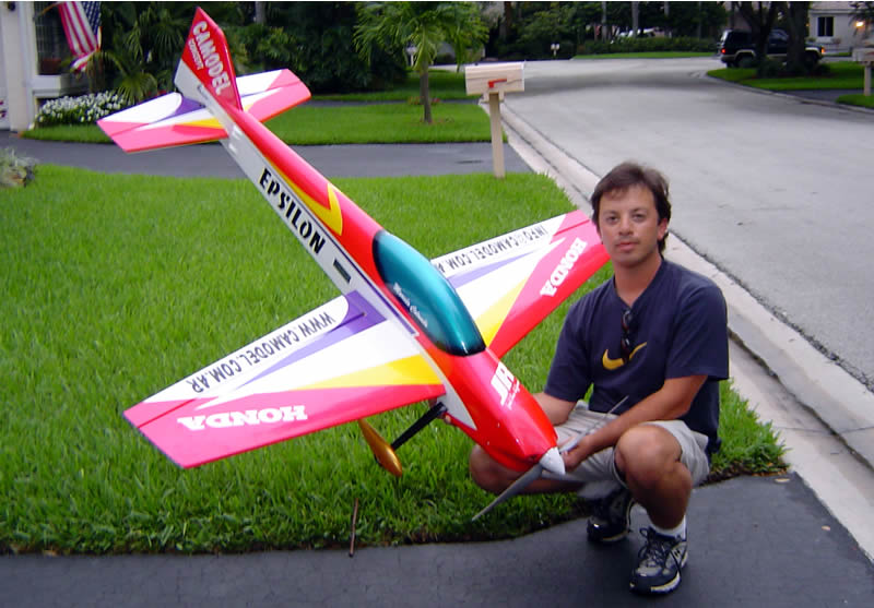

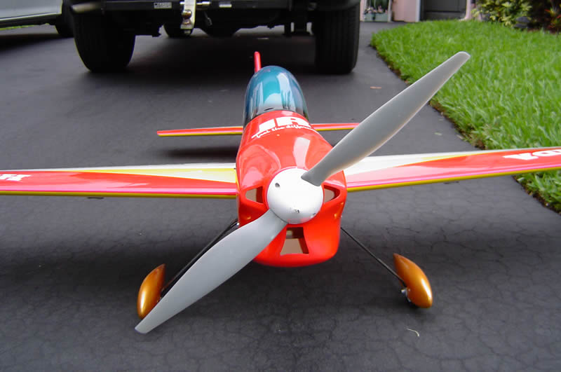

Hello Boys!
I've been following this forum and seen a lot of options for the Epsilon engine. Here I'm attaching a few pics of my new Electric Epsilon. This is the detailed setup:
- Hacker C50 12XL
- Controller Hacker Master 77 3Opto.
- APC-E 19x10
- Batteries 2 x TP 4S3P
I hope you enjoy the pictures!
Regards from Argentina!
Marcelo Colombo

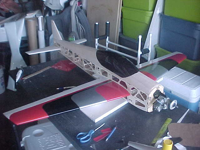

Finally got the wing covered and the cowl painted. Won't be long now. Wow my camera sux. That is missle red in the pic.
