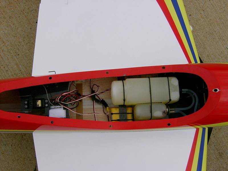

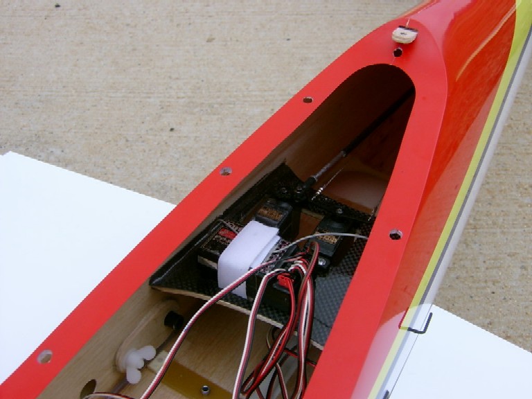

ORIGINAL: BillB
Hello Magne,
I had installed a rear former and a horizontal plate, just as is recommended in CARFs update on their website. I also had installed a bulkhead directly behind the canopy. From that bulkhead to the rear former I installed a 1" thick piece of foam horizontally. It was glued to the sides of the fuse and to the former . The break in the fuse was right at the former. The glue joint between the former and the foam stiffner had not broken all the way through. I had my elevator servo mounted between the wing. Except for using a bellcrank in the tail with pull pull cables back to the servo, and real Robart hinge points, the tail assembly was stock.

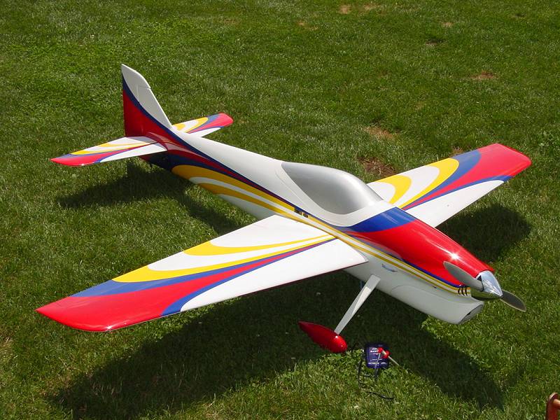

I currently have 50+ flights on my Impact without problem. I am impressed and will probably build another. Anyone who has seen my previous posts in this thread will know what extent I went to avoid the failures these models are suffering.
It is easily the best flying model I have ever owned. After a little tweaking and adjust from the intial flights I am happy to report that this model is very true with no trim or mixes. My final settings are somewhat different to their instructions.
DZ160 power is a perfect combo for this model if you plan to use IC. Electric is proven if you have deep pockets.
Make sure you make the changes as suggested in this thread. If you look at my suggestions you should be fine.
Here's a couple of pictures for those that are interested.
Peter

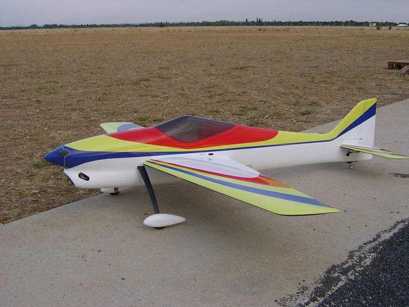

Hi Tmark65 and Tcsravros
I like forum to discuss about passion with other modelist of others country.
I visited Greece and Crete (Heraklion) when I was young. Very very beautifull countries.
I have a Cocaine and it fly great (Cocaine is similar Impact), dealer is Lorenz for Europe but
builder is Jaroslav Mach (Republic Tcheque).
The advantage of this plane is sleeves for carbon tubes are already fixed in the fuse, wings and stab so incidence and "triangulation" are perfect. Frame for support fixed gear is also fixed.
