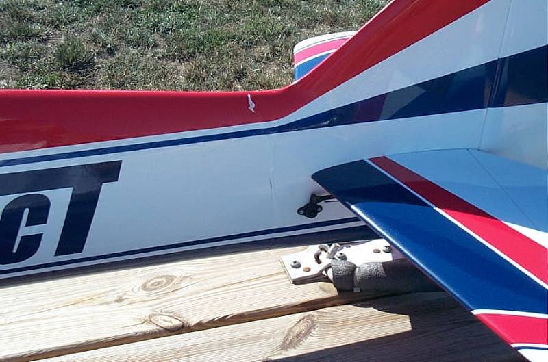

Here is a picture of a lightened IMPACT rudder that I snapped at the Nat's.

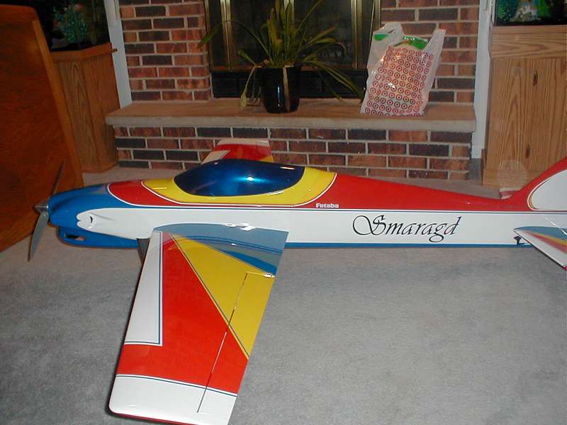

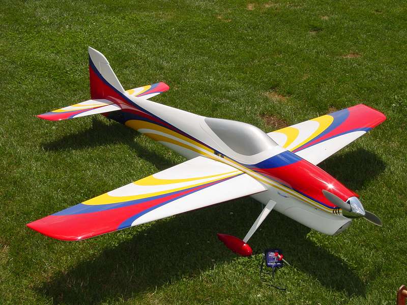

Then three pictures of George Asteris's latest IMPACT with a stock color scheme. Wish mine were that color.
I can see mine but not as well as his. Maybe I should replace them with these colors?
Eric.

You snapped the rudder at the Nats? (or the picture). Is the lightened rudder shown the original composite rudder with holes cut out or a balsa rudder you built? We will be putting one together this fall and I'm looking for all improvements.

Ahhh the power of the written word.
I wonder how many people (me included) read that to say He snapped the rudder, not the picture.
I been waitin' on the post showing the broken rudder

P.S. Using two bolts per wing makes a big difference to rigidity etc. and it was SNAPPED as in Photo.... You all got me that time....

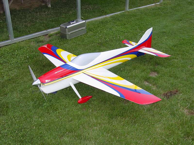

Dave's wings are the same airfoil as the Temptation and they have a different sweep on them. The sweep is the same as a Phenom which brings the wing tips forward about an inch. The foam is expertly cut by Mickey Losardo and Jim Hubbard and they are balsa sheeted. I have the exact wing on my Shmorphidite (modified Smaragd) which I'm flying this year. The wing gives the plane amazing stability in the air. It's as steady as a rock. We will more than likely be using this same wing on a different plane next year. It's gotten to the point with all the modifications that the fuse is just a device that holds the wings in place.
Here's a pic of the wing. You can get a better idea of the difference in the sweep from it.

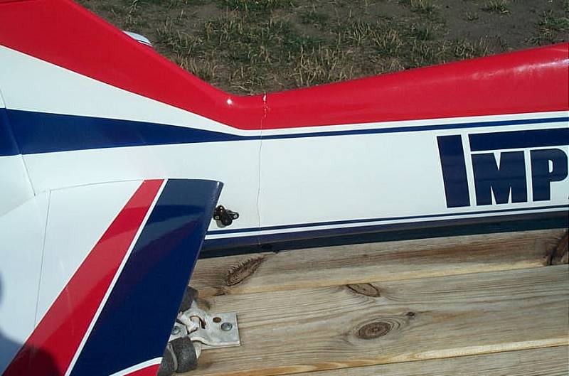

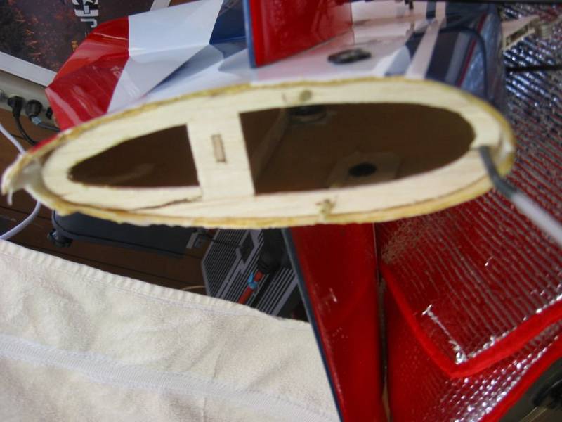

My Impact tail broke off yesterday at a pattern meet. I had installed the rear bulkhead and also had a piece of foam mounted horizontally in the tail from behind the canopy to the rear bulkhead. It broke right at the front edge of the rear bulkhead. The pull pull cables for the rudder and the elevator bellcrank and the seam tape at the top and bottom of the fuse where all that was holding the tail on. My last flight was somewhat bizarre, to say the least, not knowing what had gone wrong.
This is my second Composite-ARF to bite the dust. Last year I bought a Rev Pro and the tail boom broke off right behind the canopy on the maiden flight. Composite-ARF sold me the Impact at a considerably reduced flight with assurances that the problem was fixed. Bullfeathers. The only difference I see is that this one broke off right in front of the tail feathers rather than behind the canopy. I fly intermediate so there are no vilant maneuvers. I've never even tried to snap or spin it. For what it is worth, I did use the stock rudder.
I will never buy anything else from Composite-ARF. Even when they came out with a supposed fix for the Impact, they never made any effort to notify their customers.

With the increase use of stress skin fuselages in pattern aircraft today we need to change some old habits.
The method of holding the stab as we start and run up the motors is not a good idea.
This puts a great deal of stress on the fuselage. The uneven loads that are applied on the fuselage create stress concentrations on the sides of the fuselage head of the stabs.
Flight loads and starting loads. Make the affected area prone to failure.

Mark we put our plane holders in the front of the plane so the landing gear or front of the wing support it. I beleive that Billy B. had his that way. Bottom line is it seems that the only plane I've seen falling apart in the air is the Composite ARF pattern planes.
They have a great problem with credability that will take years to repair. I personally wouldn't touch one of these planes if they were giving them away for free. Mike

The OTOP has similar construction but they reinforce the back of the fuse with a diagonal former. I have snapped this airplane alot and it so far has shown no signs of this type of problem.

Mike is correct. I have never restrained my Impact from the stab. Always in front of the landing gear. Furthermore, I never snapped or even spun the model. I didn't take pictures of it, but last night while examining the stock rudder I noticed indents on both side in the front of the rudder that line up with the edges of the back of the fuse. It could be cause by the rudder hinges flexing. I used real Robart hinge pins and not the ones that come with the model. The indents could also be caused by the rudder hitting something while I was carrying it in and out of the basement. I also carry my planes rudder first.
Regardless of all this. I was extremely lucky to be able to successfully land the airplane with no damage to any of the internal components. I am not going to take the chance of repairing it and having a catastrophic failure. Anyone need wings or stabs?
