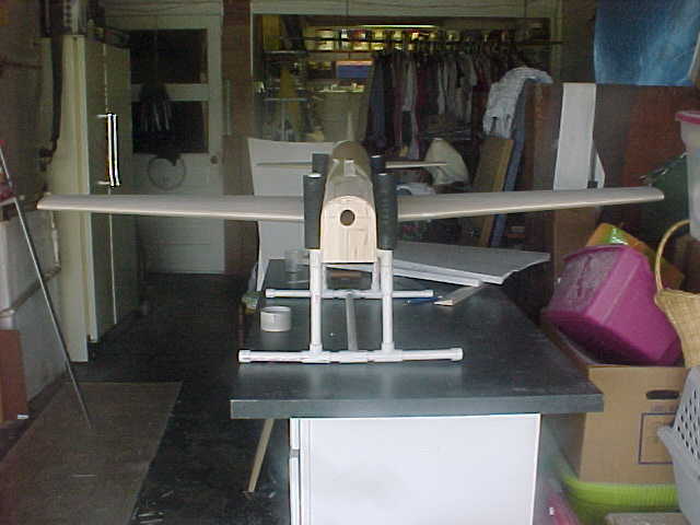

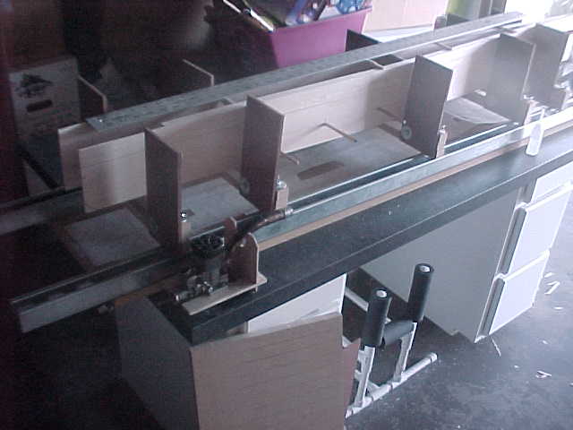

Well a couple of guys mentioned they wanted to see the Desire as it went together so here goes my first attempt at a build thread and a jig built balsa pattern ship. I've done a couple of things that are new to me with this plane. First the jig for the fuse, second the press for the wing and stab and last the urethane method of glueing the cores and skins.
OK, we're off. The jig is the one GW has on his sight that is designed by Keith Hoard. It is extremely sturdy and pretty easy to build. After I got my formers and bulkheads built and got some light balsa in put the sides together here's what it looked like. It is strait and light, the strait part may be a first for me.
ID:	130562   Click image for larger version

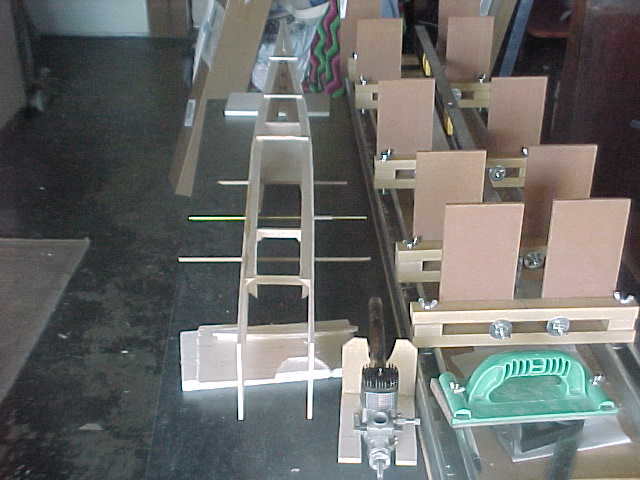

Pic out of jig, motor and mount for it. I'm widening out the nose a little bit from the original design.

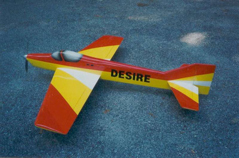

P.S. Here is a photo of a Desire I once saw that I was inspired by!!

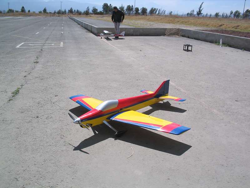

Here is my year old Desire 60, also with plug in wings, FG and an open pipe. OS91 FX on a Hatori small pipe, pipe pressure only. Wght. 7.5lbs. It flies really well for a small plane, snaps well and has good rudder authority. JR coreless 4131 servos on 6v and standard Dubro hardware. I really like this plane and for well under $1,000 it´s very affordable. The OS91 is powerful (13x10 or 14x8 gives 10,400 RPM) and very reliable.

that looks sweet Rodney. What kind of gear is that?
Tom
Old 05-11-2004 | 07:30 PM
MHester's Avatar
Posts: 2,707
From: Woodstock, GA
Default RE: Desire 60 build, first jig built balsa.
I'd guess bolly F3A standard. But I could be wrong....
-Mike
Old 05-12-2004 | 04:57 PM
rodney tanner's Avatar
Joined: Jan 2004
Posts: 390
From: La Herradura Edo. de Mexico, 53920 MEXICO
It´s home brewed aluminum swept back and the wheel spats are local CF. But yes, has the same specs as a Bolly F3A standard. We were trying to keep costs down. A Bolly FG and CF tube would save a few more grams, but we got to a pretty decent weight anyway.

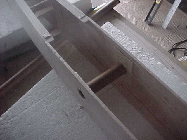

Well I got a little more done this week in the evenings. I got the fuse almost ready to finish. I'm just waiting on some CF pushrods to get here for the elevator before I do the bottom and turledeck. I got the wing tube in the fuse and tacked after about 30 times of measuring and remeasuring, it doesn't pay to try to get something exact when you're tired and sleepy.

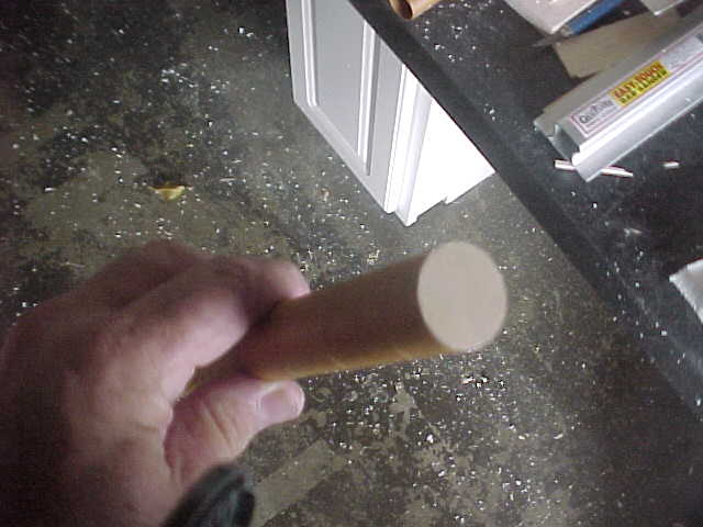

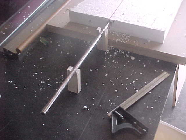

I also today got my wing tube holes cut finally. I ended up with a forstner bit and a golf shaft with some wooden block guides and about 3 million different levels, squares and other implements of destruction. It worked though and the tubes are tight and the cores line up well. Now to skin the wings with my modified press. Will post those pics as soon as I get started.

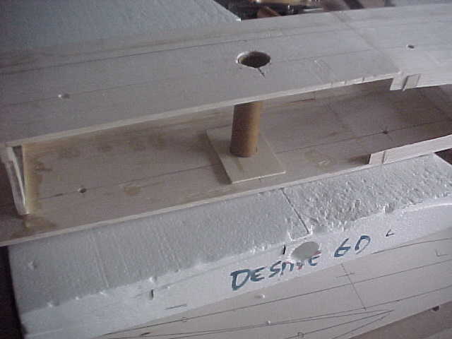

Old 05-15-2004 | 05:05 PM
My Feedback: (12)
Joined: Dec 2003
Posts: 1,025
From: Rockledge, FL
Well, got the wing tubes and false ribs in today. I took the tube and put 1/64" ply on the end and CA'd it to the tube then sanded it flush to keep the epoxy out, seemed like a good idea at the time, I guess it wil work. Then I took the skins and prepped them like Toymaker told me to do and put one side in the press. It looks strait soI'll know in the morning. I beefed up my press after the stabs because I saw the MDF board stating to bend using it end to end so I added two braces and turned them perpendicular to the cores and put 16 ga. channel under them also. Weighs about a ton now and is a real bear to put on the work table. But anyway here are 2 pics of the wing and the tube cover I made for it.
Tom

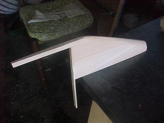

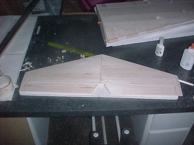

I got the hor. stab and elevators ready to hinge and finish and the wings sheeted and the leading and trailing edges on them with white glue. The control surfaces look very small to me but they are 1/8" deeper that shown on the plans, oh well. I really like the way the skins worked out with the urethane glue and taped seems instead of edge glueing everything. Going to star back on the nose of the fuse now until I get everything dry and sanded.

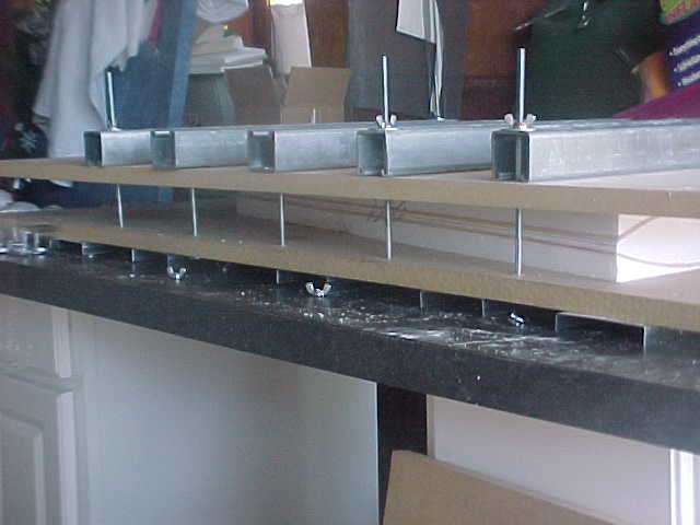

If I had it to do over, I would get 2 10' sticks of unistrut cut in 2' pieces and use it 5 on top and 5 on bottom instead of the channel on bottom and the strut on top. But it works well.
Old 05-18-2004 | 09:28 AM
My Feedback: (121)
Posts: 2,307
Received 40 Likes on 39 Posts
From: glen allen, VA,
Gee Tom,
I have to believe your press is lighter than the 2 pieces of pool table slate that I use for sheeting wings - about 90 lbs each. One on the bottom and one on top. Then I add more weight on top (about another 100lbs for wings.
How long does it take for the urethane glue to cure? I usually allow at least 24 hours of cure time using epoxy.
The Desire looks good so far!!
-Will B.
Old 05-18-2004 | 12:04 PM
My Feedback: (12)
Joined: Dec 2003
Posts: 1,025
From: Rockledge, FL
Yes the press is lighter but, I put 10, 1/4" bolts throught the 5 pieces of unistut and tighten them down equally, so I get plenty of downward force without having to use a zillion lbs. of weight. The directions on the glue says it cures in 4-6 hrs. but I have been leaving them in the press at least overnight 12-14 hrs average.

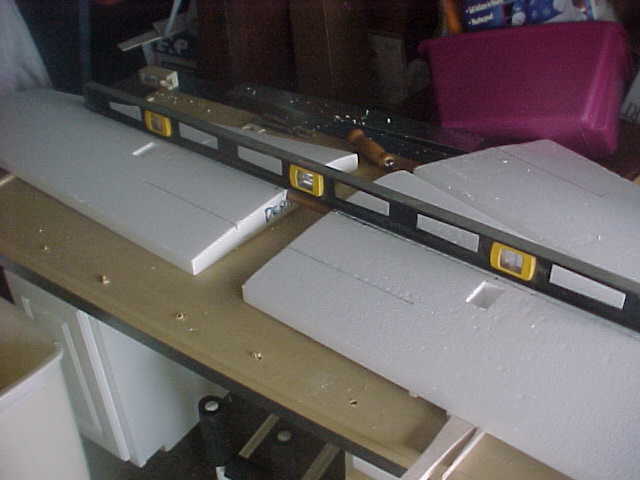

I got all the surfaces on and gues what, it's looking pretty darn strait, according to my measurements the levellility and perpendicularness are right on the money. I haven't checked the incidences yet but they look pretty good also. Here's a pic of it all stuck together, accept for the turtledeck I'll finish today or tomorrow.
