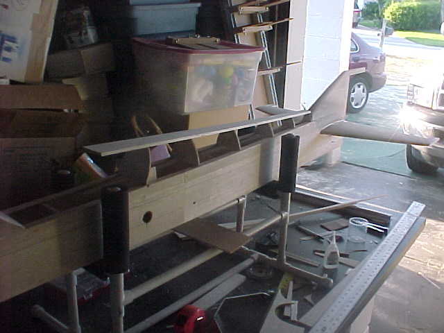

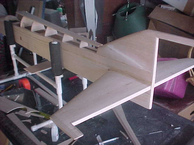

Cool Mike, I'll see ya there. Got a lot done this afternoon, got the hor. and vert stabs glued in. You can see my piece of 1/32" balsa I had to add for the stab not being wide enough. Also got my formers ready to do the turtledeck tonight and finish the canopy.

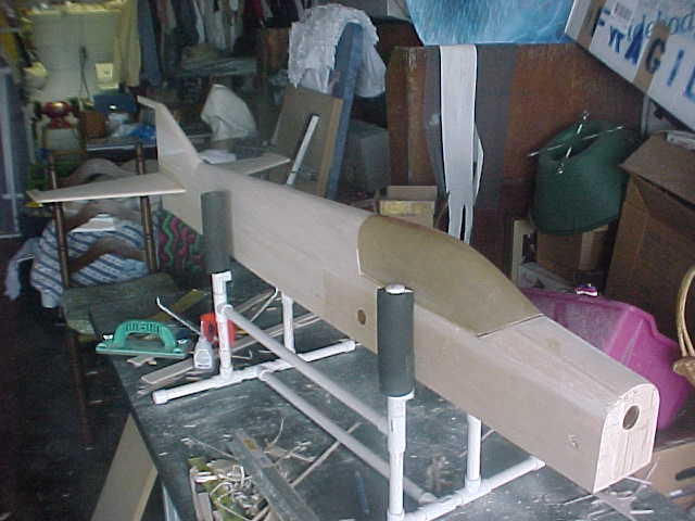

Got the deck done and rough sanded, canopy almost done and almost to shape. Now I really have to do some shaping of the nose, mount the landing gear and start putting the guts in.
I learned that I'm not going to use 1/8" and 1/4" balsa for the decks anymore, too much sanding and trimming, I'll go to thinner and more pliable stuff like SigK and Mhester do theirs. This way is sturdy but on the bigger planes it would weigh about 25lbs.
