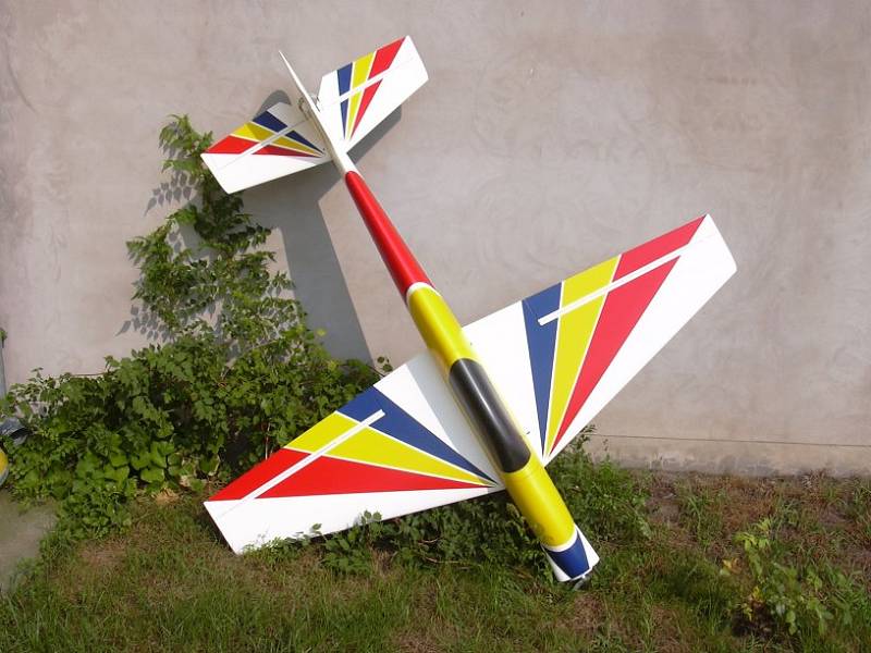

Old 07-31-2006 | 05:45 AM
  #404
ata
Joined: Oct 2003
Posts: 42
From: Kecskeme\'t, HUNGARY
Default RE: Typhoon 2000 (TEMPEST) modifications thread
Hi,
here is my new (modified) version. Less sweept-back, one elevator servo in the cockpit. Maybe this is the last one before a new design.

Old 08-04-2006 | 10:30 PM
  #405
MHester's Avatar
Posts: 2,707
From: Woodstock, GA
That really looks good!
That was a good plane for it's time, too bad you couldn't get a cowl and canopy to save your life. But, there are other options now
