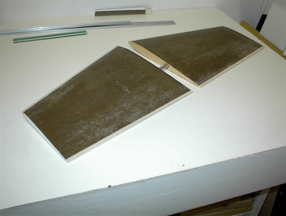

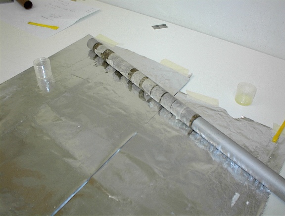

Unfortunatelly these parts are different from the original Typhoon parts, they won't fit!
And here are the final products:

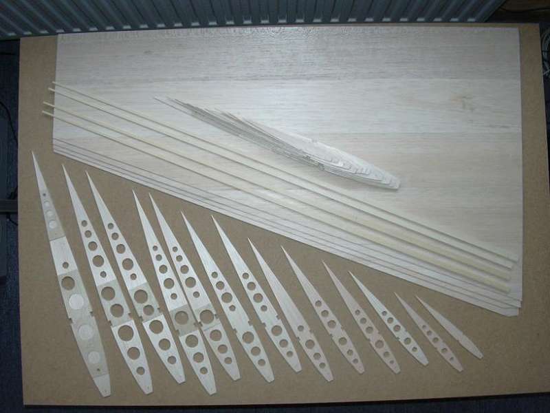

I build an all wood version with some material change. I use double tapered pine spars (for wing 5x10 mm -> 2x4 mm) and longerons (for fuse 5x5 -> 3x3). It adds only a little weight but a lot of strength. Here are all manual cut parts:

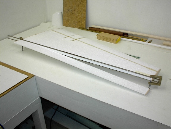

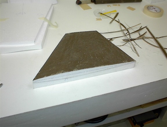

I built the wing structure and glued the sheeting on (one side). I'm using rubber bands to hold the sheeting in place. It works good if you put weight on flat surfaces (near TE). I'm using a wood template to support TE in correct position.

for everybody who would like composite parts: like Troy mentioned, this parts not compatible with original Typhoon parts (actually they not Typhoon parts) and they are prototypes. I don't know if they long lasting or are they too heavy or not so be patient. I have not planned to sell them, but maybe one day in the future ...
Other news: my wings are ready to accept wing adjusters and upside sheeting.

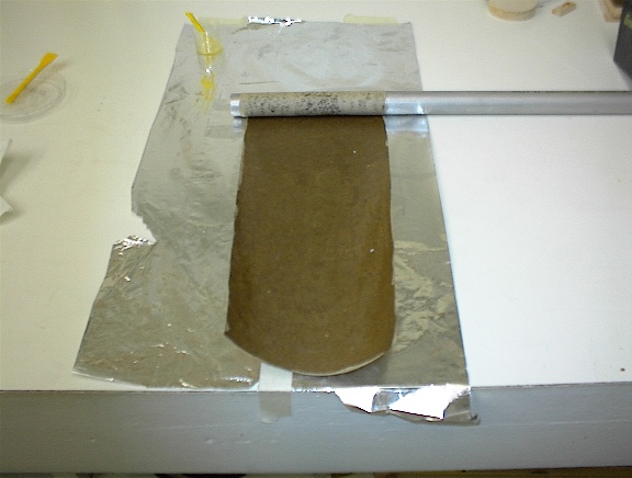

The fin/rudder and stab has been sheeted with 135gr m2 paper and I like the result. It certainly is strong enough, just need to be careful with the razor plane when working on the leading and trailing edges not to accidentally cut into the thin sheeting.

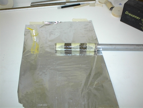

For the sockets I used the same paper. Six layers seems to be the right thickness.

No Roberto, it's not as stiff as balsa and glass but it's much lighter. What I especially like is to use paper and a thin glass cloth together. Usually I have used obechi veneer or koto for sheeting foam wings but the paper is only 1/3 of the weight.
My only concern is because the paper is so thin, there is a danger of the trailing edge warping. But thin strip of glass cloth and a little wider balsa trailing edge might take care of that, I hope.
Yes you are right it is cheap, one 50 meter roll of paper cost me the same as 3 sheets of 1,5 balsa. 50 meters of paper is enough for 12 sets of wings so it's almost a joke. A 2 meter wing costs me no more than a new fuel tank so it is affordable if I want to try many different wings. Sure it is the most cost effective and the quickest way to build wings. I'm using Bob Smith Industries Finish-Cure epoxy and that gives me a very nice semi hard finish.

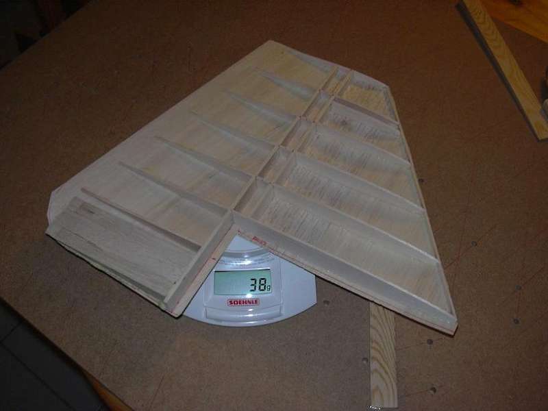

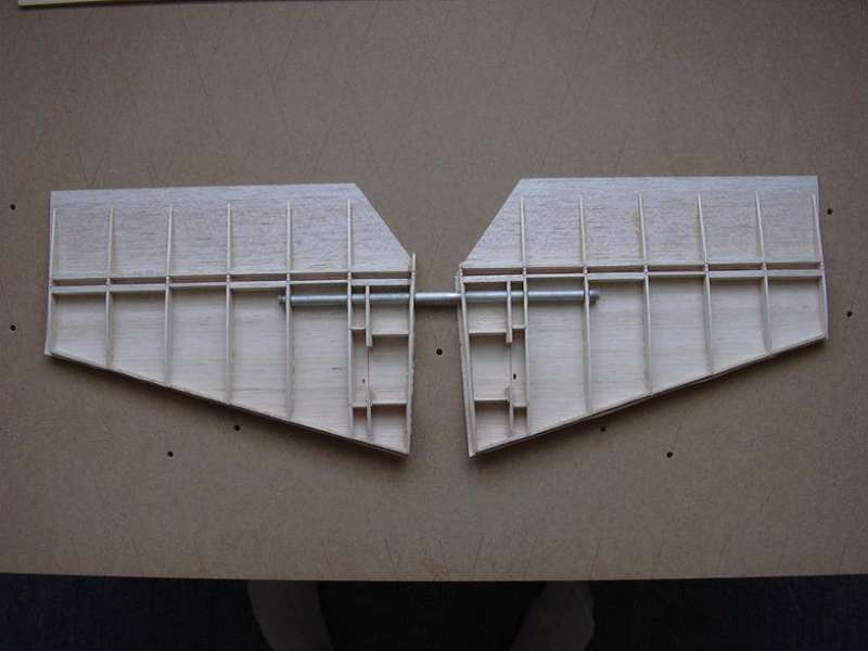

the elevator halves almost ready for the second sheeting. But after making the servo places I'm sure I don't know should I use one servo with pushrods or two servos in the elevator... Maybe I will decide later.

Atilla, the plane is designed to have 2 servos in the tail. If you use one servo with a pushrod, you may have to add some tail weight. To my thinking, that's just more dead weight. But it's been done both ways.
Just oen note: DO NOT use an MK bellcrank on this plane. For some reason, the failure rate is extremely high with this airplane. I know of far too many cases first hand.
Hope that helps,

I thinked about putting both rudder and elevator servos back to the tail. In this way the weight doesn't missing. I won't use MK bellcrank, I would choose something low cost, homemade solution. I think that a stiff T pushrod is a good solution (I saw one on Bob Pastorello's web site, but I can't find anymore). But right now I prefer the original 2 servos in the stab version again (this plane will be my prototype, so I shouldn't change a lot of thing).
How do you mount the "Hyde mount" to the firewall? How do you adjust it sideway?
The fin are almost ready to glue on LE:
