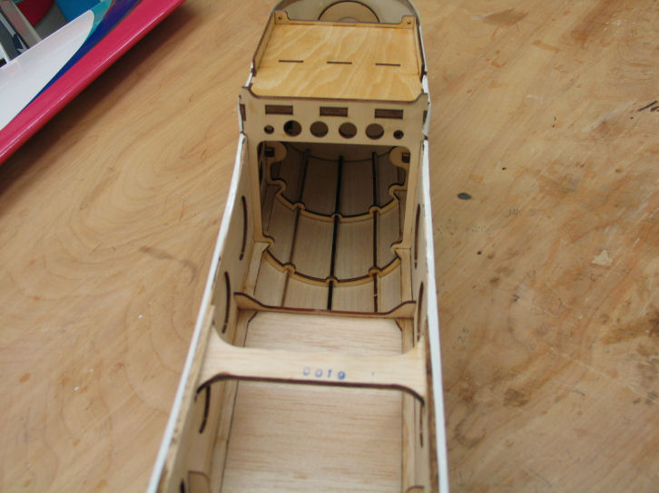

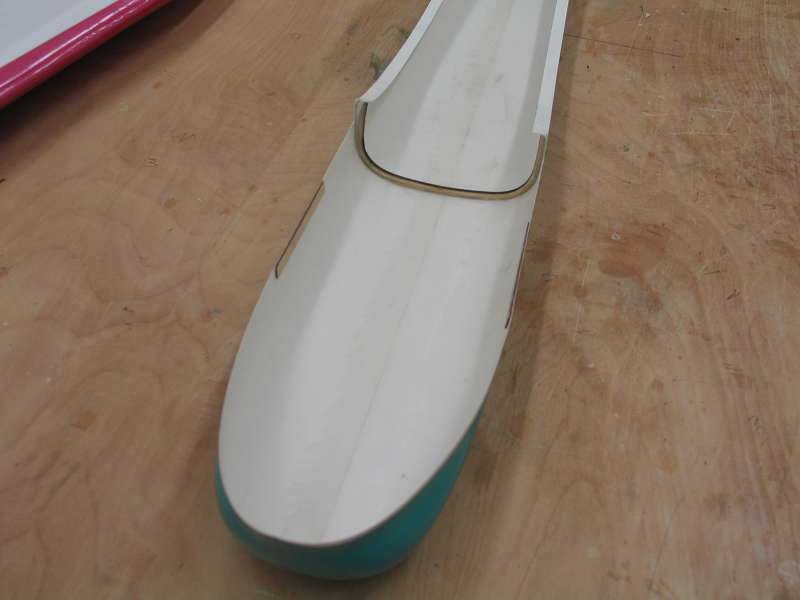

Got mine today. Here are weights out of the box for those interested:
Fuse with rudder and canopy: 26.2 oz.
Wing: 22.2 oz.
Stab: 6.2 oz.
Wheelpants: 1.0 oz.
All included hardware including tank: 14.8 oz. (tank alone 3.2 oz.)
This plane is a marvel of engineering. The only part I feel could be made lighter is the rudder and stab. They are balsa covered foam. If built up, would be half the weight.
The wing is built up and fully sheeted.
The fuse is mostly balsa with ply only where required. The fuse sides are not light ply as I expected.
The belly pan, integrated cowl and the wheelpants are extremely light fiberglass.
It appear in my opinion, this plane was designed for electric from the outset.
I plan to electrify and with all the radio, motor, 8s2p Tanics and speed control, this thing only weighs 7.73 lbs.
I will post pictures in a while.
Jeff
Old 12-29-2004 | 10:00 PM
  #60
My Feedback: (10)
Joined: Jun 2002
Posts: 406
From: Tulsa, OK
Default RE: new.. fliton infinity 90
Here are pictures.

Sorry, last bunch didn't show. Here, we will try again.

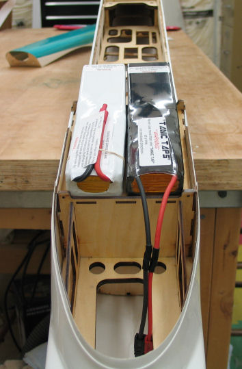

The batteries shown are 8s2p. I am just glad they fit well within the belly pan and won't require taking the wing off to change or charge.
Jeff
