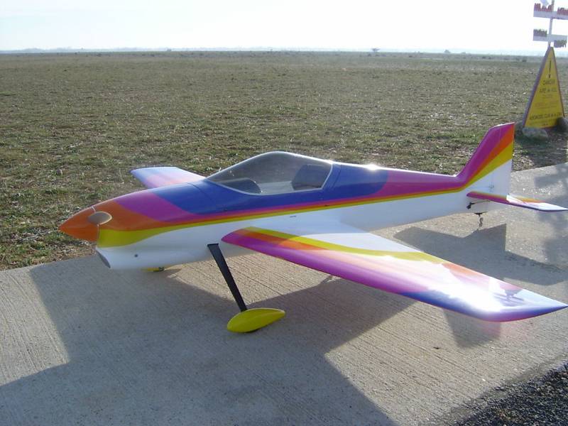

Hi Mister Mach.
I'm very happy to read you. I have a Rhapsody and a Cocaine equiped with motor Yamada YS160 Dingo.
I live in France and I bought them to Wolfgang Lorenz.
I'll do french championship 2006 with Rhapsody because a friend wants to buy ma Cocaine
after he tested it. He tells me it's the better plane he ever pilots.
Congratulation for your excellent manufacturing of theses kit.
Have you some others projets of F3A planes after ABBRA ?
pics of my plane :
pics of my plane :
