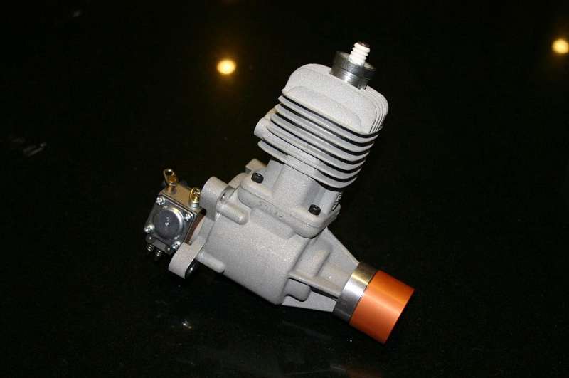

Old 11-08-2004 | 02:27 PM
  #37
schroedm's Avatar
Posts: 5,193
From: SevenoaksKent, UNITED KINGDOM
Default RE: ZDZ 40RE Powered Impact
Well,
My ZDZ40 turned up today along with the rubber anti-vibration mounts, header 'kit' and prop drill guide....
More pics etc at www.composite-arf.co.uk (click on build threads)
Rgds,
Mark
