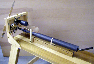

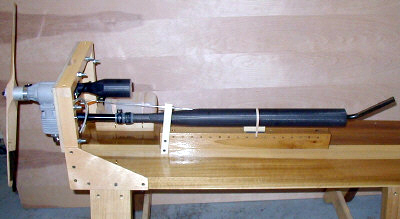

thanks Flyintexan, here is engine setup for best performance - cf intake muffler does not change throttle response or engine performance but cuts noise in half!

Hi Pizza,
I'm going to be ordering that pipe from Ed very soon - does he sell the cf intake muffler too??
Rgds,
Mark
Old 12-04-2004 | 10:20 AM
  #62
pizza's Avatar
My Feedback: (24)
Posts: 380
From: salt lake city, UT,
Default RE: ZDZ 40RE Powered Impact
Yes, ed will be selling those cf intake mufflers

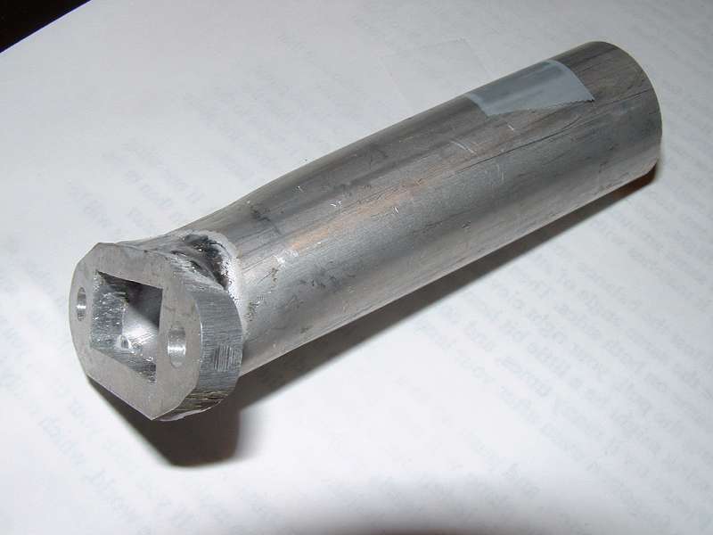

since nobody in the world makes a very light aluminum header for zdz40re pattern plane applications, I made my own. it has the right amount of drop and thrust offset for my Impact. since I will be using the rubber wellnut engine mount system it will be neccessary to use flex tubbing or 2 soft breaks one near flange the other at pipe hookup to keep header from breaking from vibration. now I will find or make a very light aluminum flex tube or bend some 7/8" alum tubing to finish the header. if rc was easy girls would be doing it.

Someone was saying the Webra 1.60/1.45 header would bolt up to the ZDZ....I think.
Old 12-10-2004 | 11:46 AM
  #66
Posts: 668
From: NETHERLANDS
ORIGINAL: pizza
since nobody ...
http://www.topmodel.fr/product_detai...e70d8a&id=4113
http://www.topmodel.fr/pics/goods/170/170541_2.jpg
Old 12-10-2004 | 12:43 PM
  #67
Posts: 172
From: lancaster, CA,
Hey Pizza,
I bolted a Webra MACS header to my ZDZ 40RE. All I did was increase the size of the current hole diamters of the header mounting flange and it was a perfect fit. Also, Karl Mueller, now has the dimensions and I believe, is considering making some ZDZ headers.
Thanks for the updates,
Jim W.
Old 12-10-2004 | 03:05 PM
  #68
pizza's Avatar
My Feedback: (24)
Posts: 380
thanks for info, that one looks good, is it holding up to vibration?
Old 12-10-2004 | 06:22 PM
  #69
Bob Pastorello's Avatar
My Feedback: (198)
Posts: 6,707
From: El Reno, OK
I had this motor, and the Webra 1.45/1.60 rear exhaust header. Perfect fit, except for bolt holes on ZDZ are 5mm dia., if I recall. Plenty long, light, easy to 'tweak' as needed for thrust offsets.
Old 12-11-2004 | 12:00 AM
  #70
pizza's Avatar
My Feedback: (24)
Posts: 380
Hi bob, was your zdz40 hardmounted, was your header flexible or solid? how many flights, did it break? thanks
