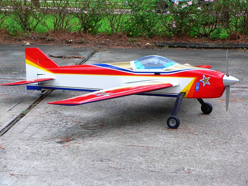

Here are the pictures of the www.GraphTechRC.com carbon gear on my Excelleron 90. This is #1203 for the Hangar 9 Funtana X100. I dry fitted them and took some pictures for you. The wheels are simply propped up and the chin cowl taped on, but you can get an idea of how they look, knowing that it'll rise an inch once I install the wheels. With a 15" prop, the clearance when parallel is 3-7/8" which is about the average height of the grass during the Houston summers. That should reduce my clean-up time by about 10 minutes, allowing me to get another flight in before going to work. That translates into 25% more practice time (5 flights instead of 4)!
I like the fact that it has more clearance than the bolly gear, but it is much wider than the fuse than I anticipated, exaggerated by the gentle bend vs the sharp bend in the stock gear. I'm not sure if I like them being so wide.
What do you think? Should I a) keep them or b) return them and find gear that's narrower?
Alan
Alan

I have read on many other forus that folks are cutting the gear doen the middle to accomadate the width, that might be your option here.
Looking at your photo's, no doubt it will be stable and other than the looks, they look good.
The shot from the front is the one I think looks a little strange, from the side they look OK.
that's MHO.
Probably like you I would have reservations about cutting them. then again that may be the way to go.
How is the spread on these compared to the old ones? considerably wider? Just a little?
How much would you need to cut, if you do want to make them look like they were made for it?
thanks
Mike R

From a physics standpoint, does cutting the gear in the middle reduce their strength?
For a hard landing only on one side...
- It seems that it would be more likely to pull out a cut gear.
- If only one side were to break away, then you may end up with wing damage on that same side.
- If we had a solid gear and a one sided hard landing, it would take twice the force to rip it out and if it did, at least the plane would drop equally on both sides.
For a hard landing on both wheels...
- It seems that it probably wouldn't make a difference if cut or solid because you'd have half the force for half the screws.
Having said all this, I guess I could epoxy the two sides together after cutting and have some of that combined strength back. Not as strong as solid CF, but decent.
What do you think?

Why not just use the gear designed for the Ultra Stick 1.20? It's width at the fuse is much closer match to the Excelleron than the one designed for the Funtana (I have the GraphTec funtana gear on my funtana).
Check out the dimensions http://www.graphtechrc.com/Secure/images/126.jpg
The width is about 1.5" less at the fuse than the funtana gear and is the same height.
