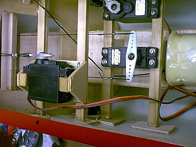

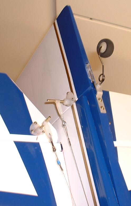

Bob does the Excelleron have dual elevators?
If it does would you please show how they are rigged to the servo and evelator. I have never rigged up pull pull elevators.
Old 11-21-2004 | 03:36 PM
Bob Pastorello's Avatar
My Feedback: (198)
Posts: 6,707
From: El Reno, OK
Default RE: Excelleron 90
The Excelleron has all the guide tubes for the steel cables already installed. Very detailed instructions on how to make it work. Essentially, each elevator half is hooked up just like a normal rudder pull/pull setup works. Each elevator half has a top and bottom cable that goes to the same hole on the servo arm. Just like a rudder, setup with relatively-matched tension on the cables, with control takeoffs the same distance from hinge line.
Pic attached of what the servo end looks like (although not an Excelleron, it's the same idea.

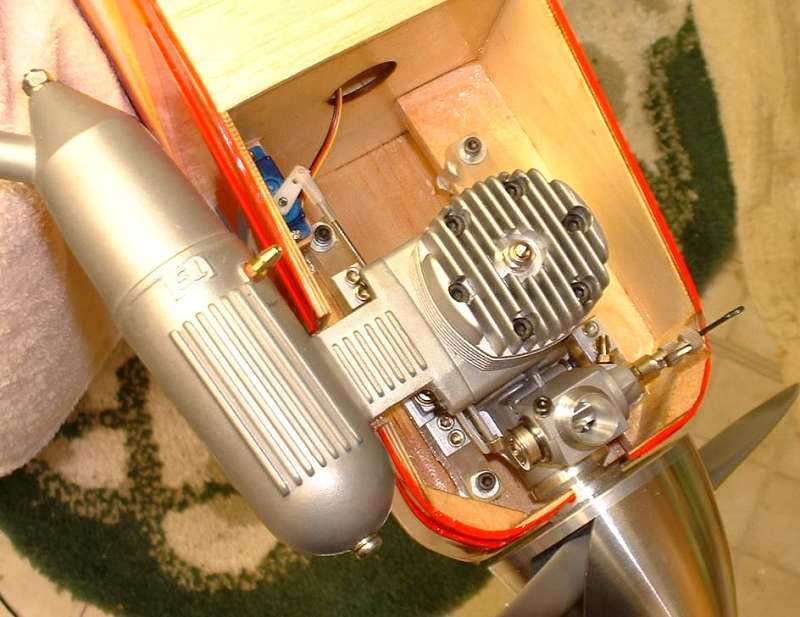

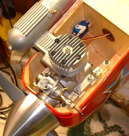

Progress....ready to run the Tiger Shark 91.....pics here [link=http://www.rcaerobats.net/Excelleron/ExcelleronMain.htm]Excelleron[/link]
Did my "throttle servo in the engine bay" deal - again - it's working so well on the bigger birds, it must work here, too....
WX permitting, Saturday should maiden.

Bob,
I'm curious about that motor mount - how did it work out for you? How exactly does it work?
Scott.
Old 12-03-2004 | 09:56 AM
My Feedback: (198)
Posts: 6,707
From: El Reno, OK
Haven't run it yet, but the design is VERY similar to the MK. Been around for years. Basically, two firm rubber isolators, a front and rear, on each side, are bolted on THEIR ends to spacers to keep the engine beams off the fuselage mounting parts. This permits the engine to "rock" side-to-side, but not up and down, or fore-aft, so it holds alignment. I've found them to work pretty well in the past, although not very long lived, as the rubber isolators wear QUICKLY.
I'll post findings on the motor and mount after some break in runs this weekend.

Only with MAJOR whittling. The engine bearers are solid hardwood, 3/8" thick that glue about 2" behind the firewall, all the way to the nose plate. You COULD remove them, but it would be major roto-zip tool kinda work, and would take some patience. However, it would take a lot of nose weight out, meaning that whatever mount you went back with would probably not appreciably affect the overall balance.
Question is - What mount? The firewall is a bit narrow, and short for a Hyde-type (I think, although I don't know their mounting dimension on the 90 size)
Gator would work, maybe, but it's pretty wide. You could remove some stock by cutting it in half vertically and removing some of the backplate mounting material, but how much would be based on the engine you choose.
