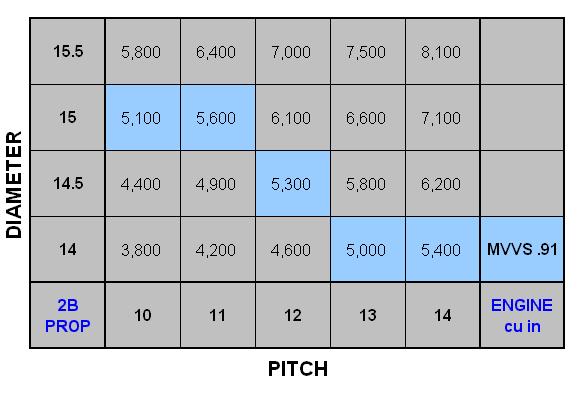

If you use the MVVS tuned pipe for the .91:
APC 15x10 @ 8200 rpm
APC 15x11 @ 8000 rpm
_________
Schpankme

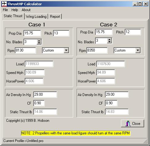

Old 11-15-2004 | 10:21 PM
Schpankme's Avatar
Joined: Jun 2004
Posts: 267
Default RE: prop for tai-ji 60
Scoubi,
Utilizing a "known" value (prop load & rpm) for an engine rpm and prop combo, you can use ThurstHp to evaluate different prop sizes by adjusting the RPM until the HP equals the Prop being compared. - see example
_________
Schpankme
