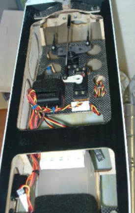

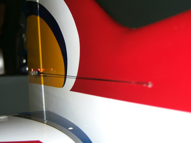

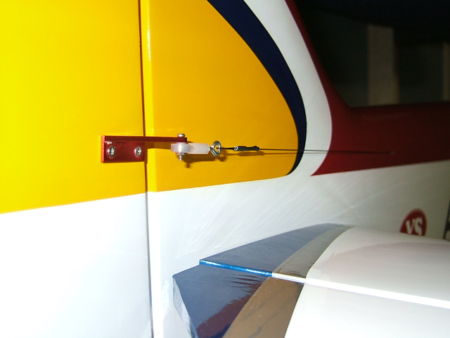

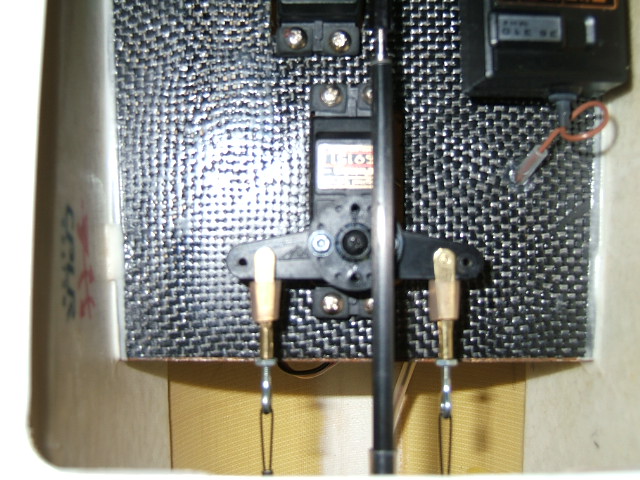

Hi David,
I have attached some pictures of my setup which I think works well for me. My cables are always taunt no matter were my rudder is including extreme deflections. Firstly the rudder horn must allow the pull pull cables to terminate over the hinge line. I also use the MK rudder horn attached to a standard horn on the servo which offsets the cable terminations slightly. The distance between cables on the servo end as well as the rudder horn end must be identical. I use the MK ball bearing fittings at least on one end to reduce friction and allow surface to centre exactly. Ensure that cables are parallel and straight. Any kink will result in excess cable guide wear which in turn will result in loose cables that require periodic re-tensioning. This sounds like a bit of work but the results are worth it.

Have you found it necessary to offset the cable terminations on the servo in order to maintain tension at large deflections?
I'm asking out of curiosity since I do not do that, unless there is a need to compensate for rudder control horns that terminate behind the hinge line (which should be avoided if at all possible)
In principle the set up you are using will increase the wire tension slightly as the ruddder is deflected. I prefer setups that leave the tension of the wires constant, independent of the deflection or systems that have the highest wire tension at the centered position.
/Red B.

Looks to me like his control horn is right on the hinge lines . Actually most people have a
tendency to run their wires too tight anyway. They should not pull hard on the servo as

Note the servo arm end...it has the takeoff points slightly aft of the centerline of the output shaft, thus introducing the Ackerman needed....(great thread recently on this topic on the NSRCA mailing list)

Your setup looks very nice but I agree with Red that having the servo horns offset behind the wheel and the rudder control horn exactly over the hinge line will cause increased tension in the cable opposite the side that is pulling. In other words, if you input right rudder as the surface deflects to the right the left cable will increase in tension over the right. This is very undesirable and if the offset is too much it *will* cause a flutter situation at high speeds when the cables begin fighting each other as one side deflects and the other side gets tighter thus pulling to the opposite side. I have a friend that snapped his stab twice when flutter occurred due to the control horns being in front of the hinge line (same effect as having the servo control arm behind the servo center line).
Your offset looks very minor so you may not experience any flutter, but I thought I'd warn you.
As to the distance between the control horns and the servo arm being the same, I've heard this too but believe it's a misnomer. I've experimented with this and I believe that different distances between the two will simply result in the end with the least distance separating the right and left having to move further, but I don't think there is any other adverse effect. Where this was useful for me was in the case of the elevator. It's better if our servos operate at near 100% throw between full up and full down so we have the max precision. My last elevator pull-pull setup only had the servo moving about 30%-50%. To increase this I used a smaller space between the cables at the servo and a larger one at the elevator. This meant that the servo had to move further to accomplish less throw at the elevator. As far as I can tell the the geometry works out because the distance one side moves is equal to the opposite side even if the other *end* is moving a different amount.
