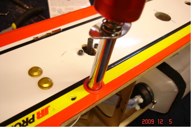

the part i'm trying to fabricate is the where you attach your glow driver to . the remote that on the side of the fuse. any tips?

This set-up comes with the Sullivan head lock. The outside red piece is from an epoxy bottle, cut open, the black piece which covers this unit, is a black flex plastic from something I had in the shop, it just slides right in, friction holds it.
