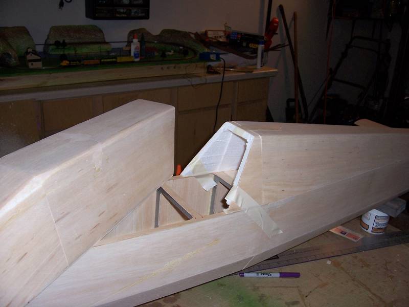

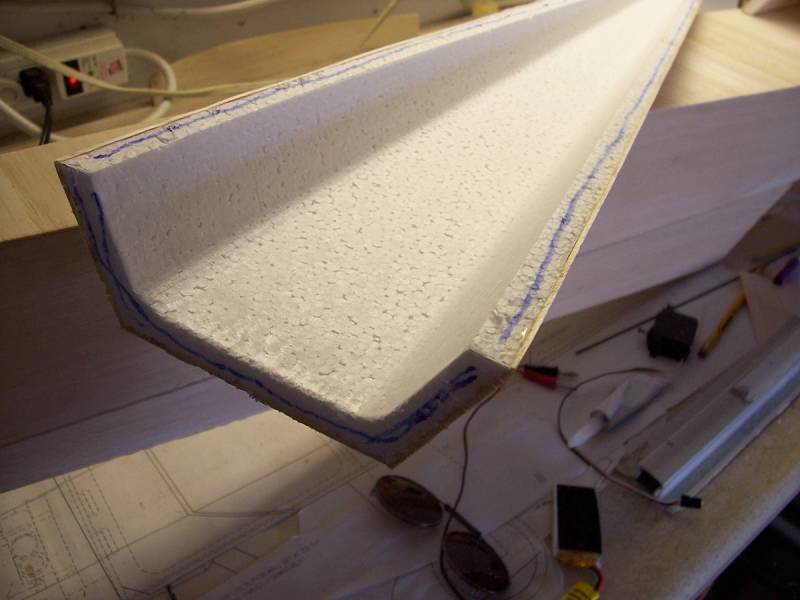

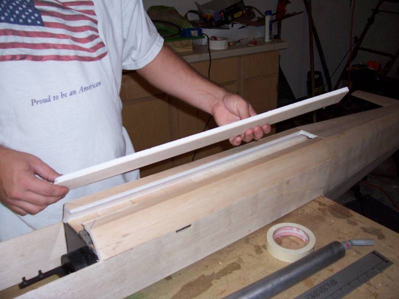

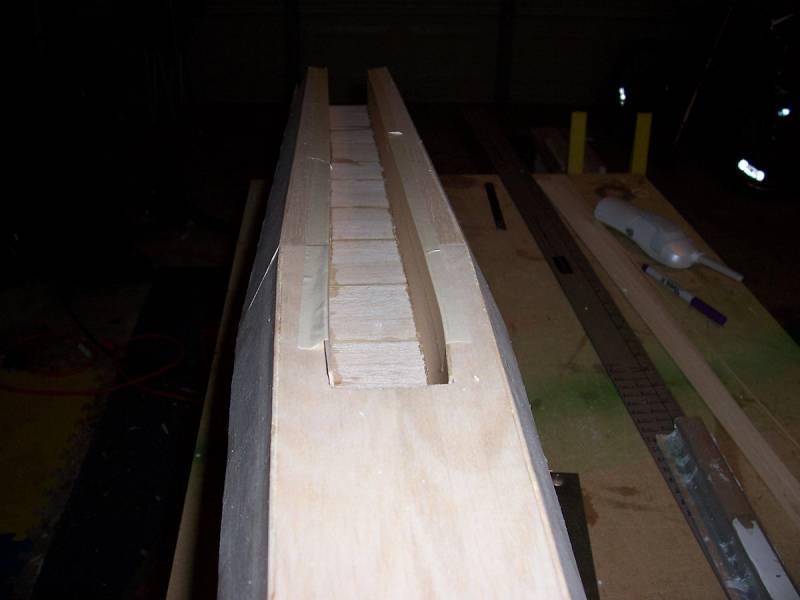

I recieved the deps and installed it without much trouble at all. I sheeted in the bottom of the fusebox and sanded the edges flush with the fuse sides.
I marked the foam of the rear bottom turtle deck and sanded the balsa sheeting flush with the foam. After a trial fit, I glued the bottom rear deck in place with lots of tape. I used the same steps to fit and glue the forward bottom deck in place. I will cut clearance in the bottom deck tunnel later for the pipe and sheet the inside walls to finish off the pipe tunnel.
The canopy has been trial fitted, but nothing else yet.

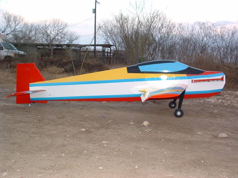

Painted the pipe tunnel and engine compartment. I used lustrecote.. nice and black. Then.. Mark and a few others recommended using the finishing epoxy.
Mark gave me a hint of using the heat gun and letting the epoxy flow. What a great idea.... i could easily move the epoxy where i wanted and got a nice shiny good solid even coverage with it.
Hopefully i might have it fully assembled and ready to weigh in by Sunday night, then i just gotta find a scale.
More to come..
Chuckles

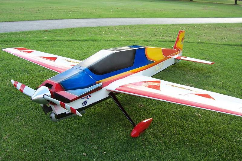

it is done....
9 lbs 14 oz!!!!!!!
next to the skunkworks.
Chuck

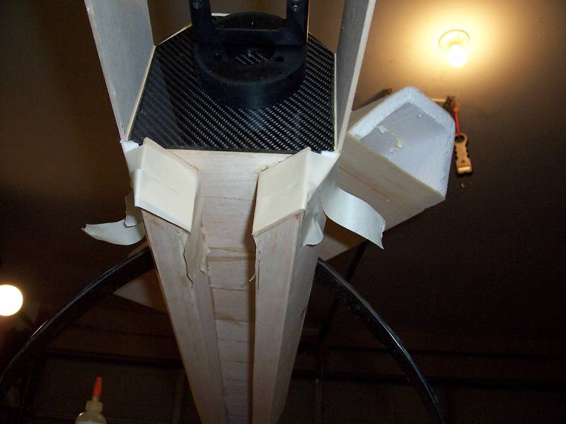

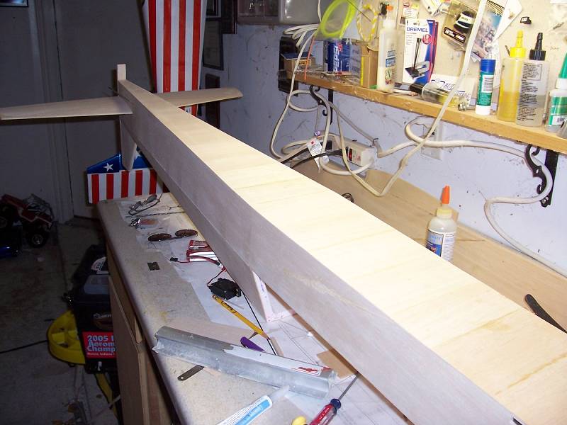

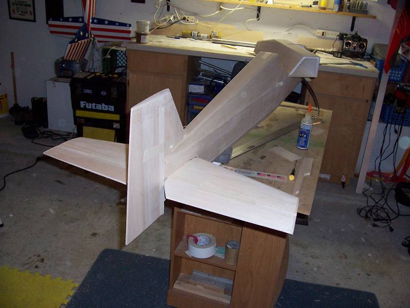

Finally got around to working on the plane a little bit....
-cut the canopy at the front and back
-glued the cutaway pieces to the fuse
-capped the pieces on the fuse
-capped the front entry area of the pipe tunnel
-taped the elevators and rudder to drool a bit....

ID:	389914   Click image for larger version

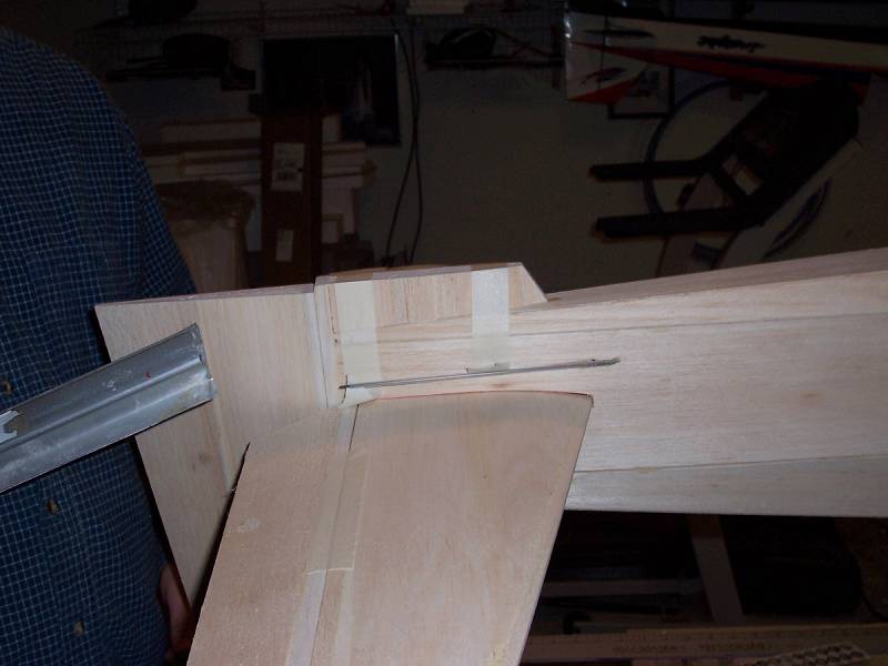

progress report:
-slight change of powerplant plans...will be using standard OS muffler...yes, the standard muffler....btw, we are looking for one and will give a fair price
-the standard muffler with bolts and adapter plate is heavy (10.9oz.)...However, the original plan included a greve pipe, pipe mount, silicone coupler with clamps to a short header extension (helped mid range), header extension, silicone coupler with clamps to a wrap around header, the header, and header bolts.......all this weighed in at a hefty 12.5oz. I have included a pic of my Insight with this setup.....power is not an issue, noise is not an issue (still need to get a good db reading) and simplicity gets high marks.
back to the build:
-mounted rear canopy with carbon pins
-still working on front canopy facings....will use a hatch latch here
-closed up the pipe tunnel cutout (see above..)
-reset motor mount position and made a small cutout for OS head clearance
