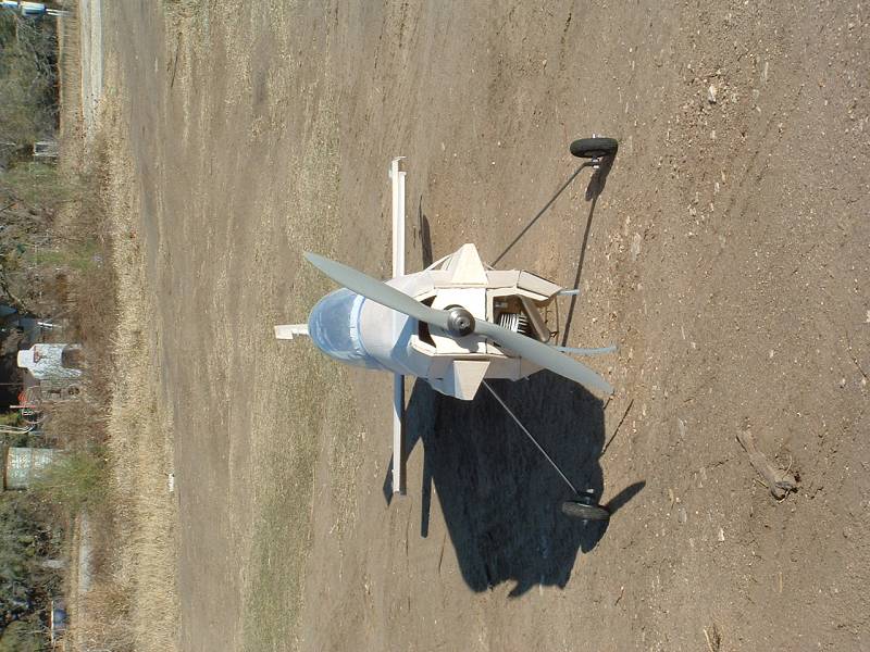

it was just too dog gone gorgeous out for me not to take her outside as i tried to balance for the wing tube and get a couple of shots.. mark i hope you like it...
enjoy everyone... still tons of sanding to do!!!
chuck

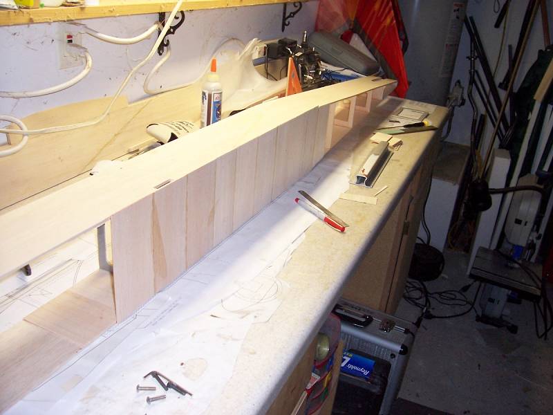

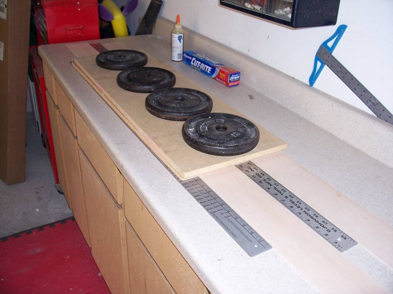

I finally got some sanding done....this is just a rough sanding of all the balsa caps on the wings and tail. After sanding the wings and ailerons I weighed them and both read 8.8oz. I was surprised at how similar the weights are.....this will put me on target for 15oz. or less for each wing panel ready to fly.
Also laid out the splice for the fuse sides using a couple of steel rulers and some wax paper. I applied glue, then another sheet of wax paper, then carefully placed two sheets of particle board and some weights........I knew those would come in handy someday.

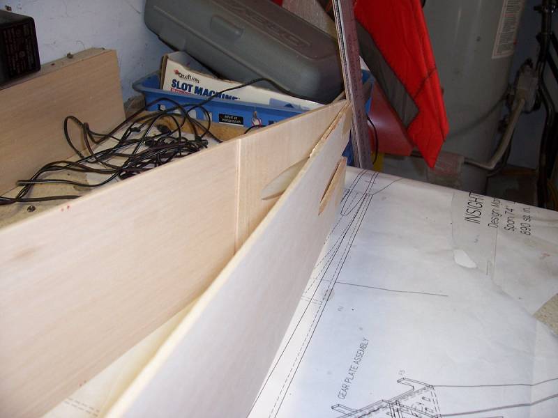

Well. What can i say... its wierd.. i only added 1 inch in the fuse sides and Mark had added 3/4" in the lower belly pans to help hide the pipe (which is installed in the pics). I am amazed at how much it "beefs" the plane up like it is on steroids.
More to come.. I got the wing tube donuts in and will be glueing the tube in tomorrow.. this monring. what time is it.. hehe

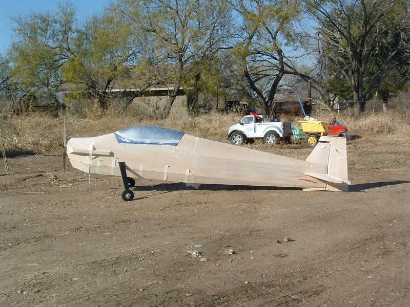

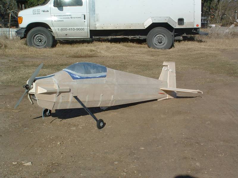

Well, i have reached the point of no return.. Stab in, wing tube in... now it just details eh? The tube i was really anxious about and it when in so easy i was amazed, probably because i built it up so much in my mind.
More capping today.. finishing off the elevators getting ready to setup the wing adjusters and retaining screws.
Merry Christmas to all.. and happy landings in 2006. (wheels down).
Chuck

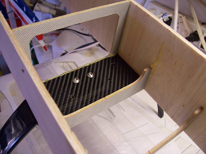

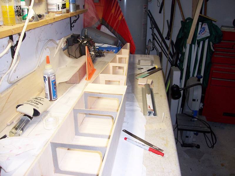

Got the fuse sides squared up and marked for former locations.....I am trying something different concerning the fuse doublers....I polyurethane glued vertical grain 1/16" balsa sheeting solid in the original 1/16" ply location. It seems quite strong and as I add formers the fuse sides will stiffen up a great deal. If it feels too flimsy after getting the fusebox framed, I can add horizontal stiffeners about half-way up on the inside of the fuse sides......at this point, I don't think I will need to. I have the gear plate and main formers now in place and the fusebox is shaping up well.
middle pic shows the 1/16" balsa doubler in the stab area.
the fusebox is taped together at the tail post right now........I will add the rest of the formers and firewall later.......soon I hope.
