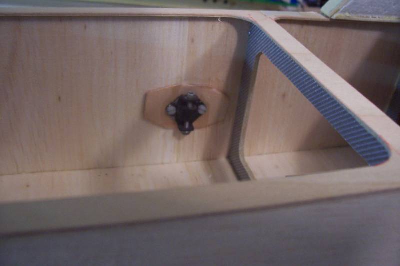

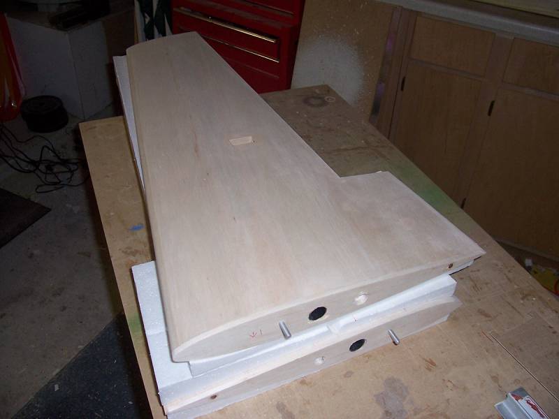

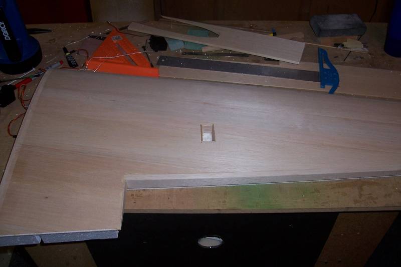

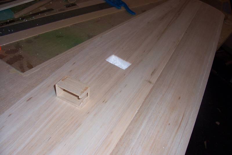

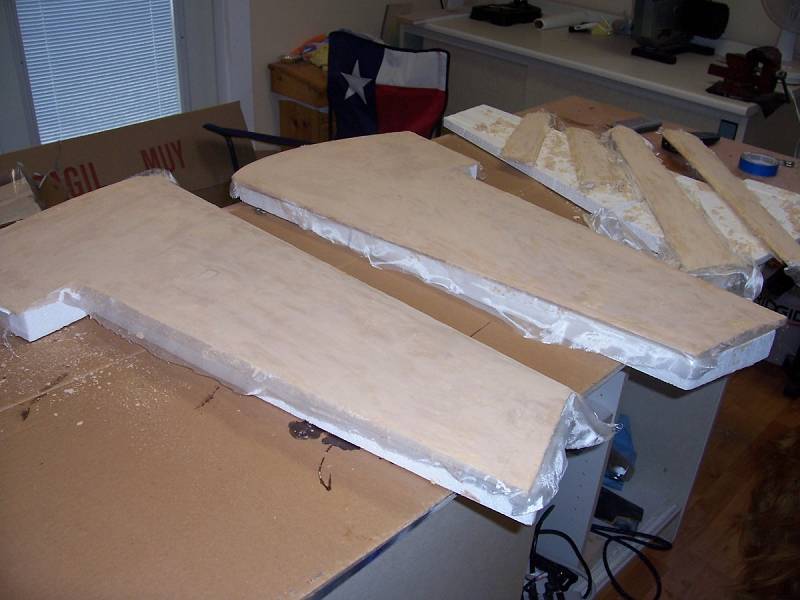

Continued to work on the wings as they will be the first to get into the finishing stage (monokote or paint) while I continue to finish up the fuse and prepare it for glassing and paint.
- sanded the wing roots flush to wing skins
- laid out the location for the wing adjusters (near trailing edge)
- inserted adjuster socket into the wing root
- transferred this location to the side of the fuse - to do this I referenced from the flat canopy deck down the sides of the fuse on a piece of tape at the trailing edge and leading edge of the wing. This gave me a good starting point for the adjuster slots
- used 1/16" ply to attach adjusters to the inside of the fuse
- 1/16" ply washers mounted to inside of fuse at the wing stud locations
- laid out the ail. servo locations on the wing panel.....also double checked the wing depth at this location using a pin, just to make sure the servo would'nt bottom out against the wing's top skin
- drilled the ail. servo lead holes using my v-block wing tube guide (sorry, no pics...but look further back in this thread for my wing tube drilling setup)
- built balsa boxes around each servo
- cut through the wing skin using the servo box as a guide and removed foam.....luckily, I found the ail. servo lead holes right where they were suppossed to be.
- double checked fit and glued in servo box using polyurethane glue.

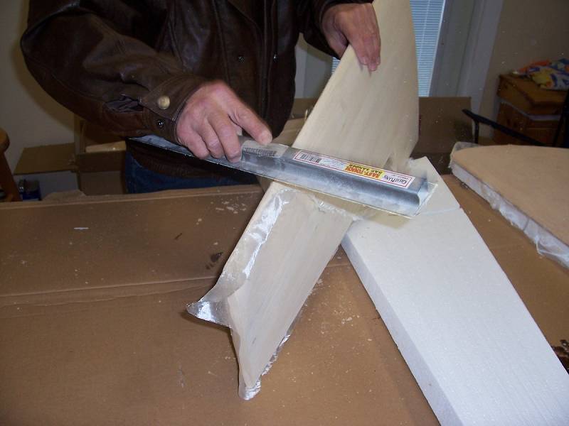

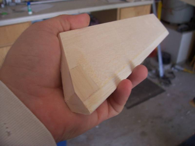

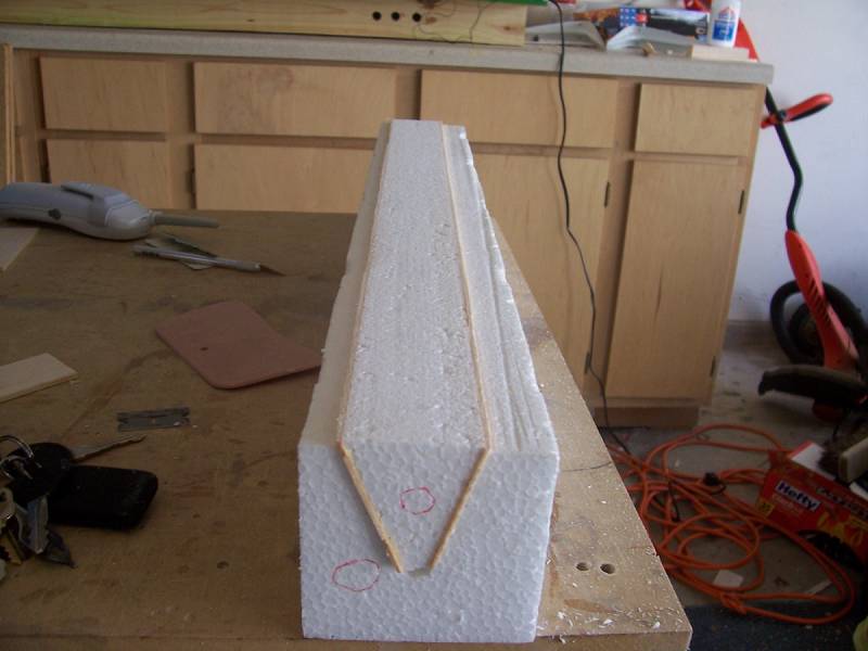

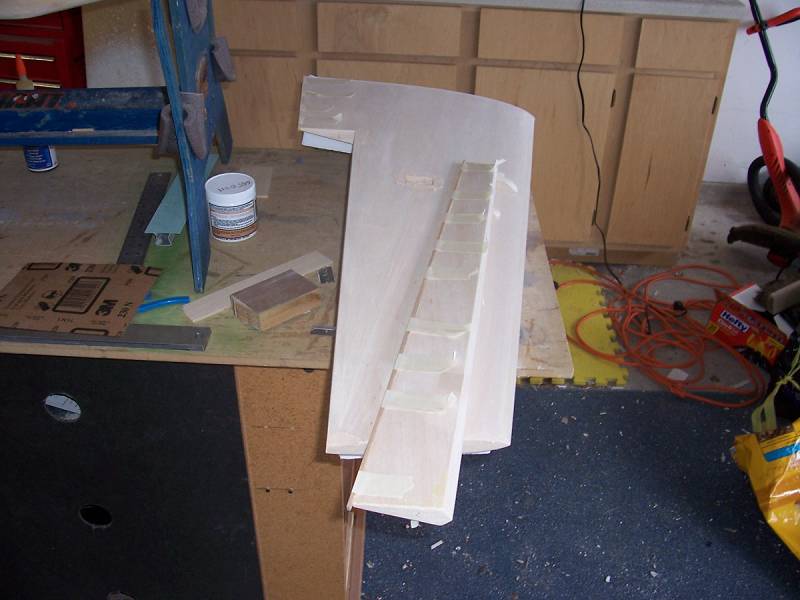

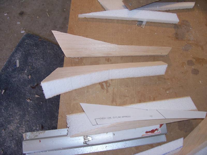

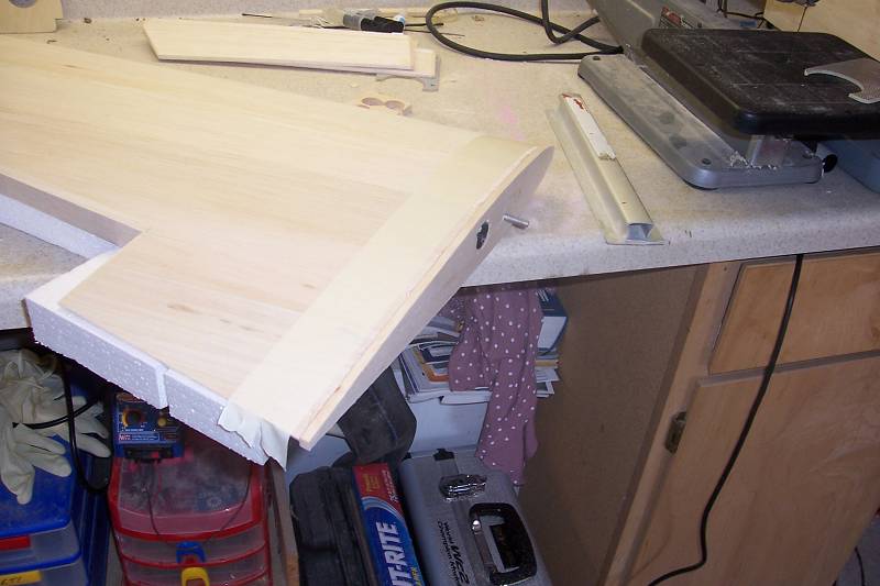

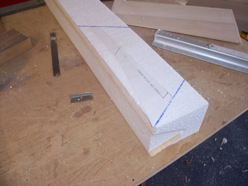

Progress:
Glued in 1/16" ply plates for use as hardpoints on ailerons and elevators....will do the same on the rudder
Sanding on wings and fuse....a bit of filler and will do some more sanding....the surface must be good prior to glassing and paint...
Added an 1/8" hard balsa strip to the trailing edge of the wing for a stronger, cleaner T.E.....will sand flush tomorrow.
Laid out cheek template on the sheeted core in its shuck....ran the whole assembly through the 9" bandsaw. Will cap the ends and hollow out one for the head of the OS before gluing to the fuse sides...

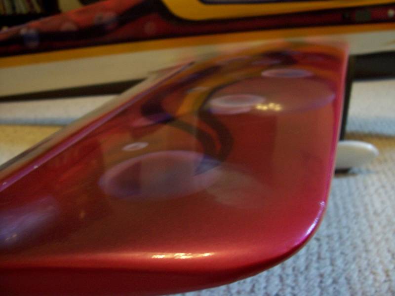

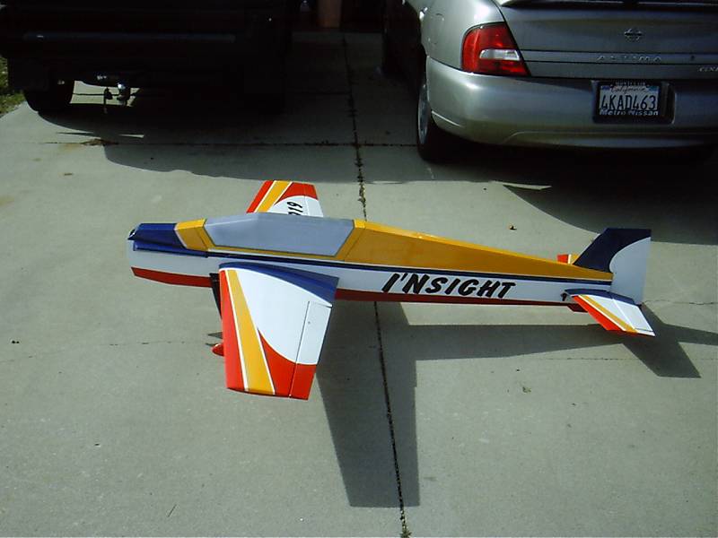

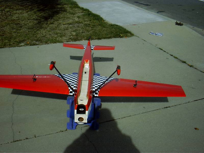

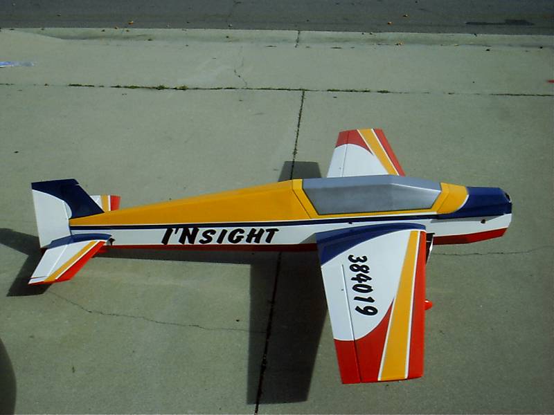

Hey Mark!
Finally done! Just finishing up the final touches.
Will give flight report later this week.
Got to get ready for the pattern contest in Lancaster, ha!!!
Hope I did her some justice.
Love to fly pattern
JJ

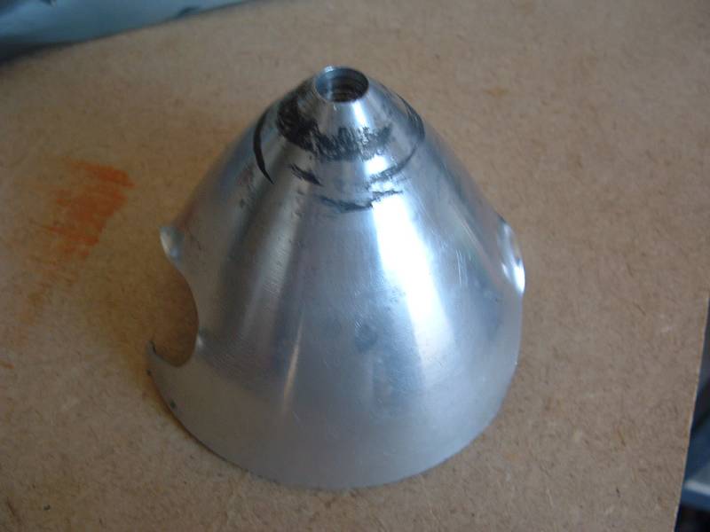

Flew mine again yesterday, just getting used to her and love it, had the engine running stron, then things went sour.. then i realized how lucky a guy can be.
My prop had started to come loose and was cutting itself on the spinner, almost sheared the blades off. I will take pics tonight and share my luck. If i had lost a blade i am sure i would have shook her to pieces.

Jarvis,
Your Insight looks great! I really like the way you softened the cheeks with the dark blue and I see you rounded the wing tips a bit. Hope it flys well for you.
Really Nice Job.
-mark

here are the pics of the close call....
always check the prop.. i will learn from this.

OK, Jarvis.. I gotta ask. is there a story behind the I'Nsight on the fuse?
just curious.
Chuck
Old 02-07-2006 | 02:00 AM
  #265
My Feedback: (15)
Joined: Jun 2003
Posts: 556
From: chino, CA
Default RE: Insight build...another wood roach.
This is what happen's , when you send the WIFE to do a Pattern flyer's Job
If that's an APC prop, the hub is very hard---often a good idea to cyano a disc of 80-100 grade wet-and dry sandpaper to it and/or the spinner backplate---they can slip even if done up tight ,even directly against a knurled alloy prop driver. Same thing with a carbon prop.

Thanks for the tip! I will probably do this just for added safety.. i would have been devastated to loose this plane or any plane on the 4th flight!

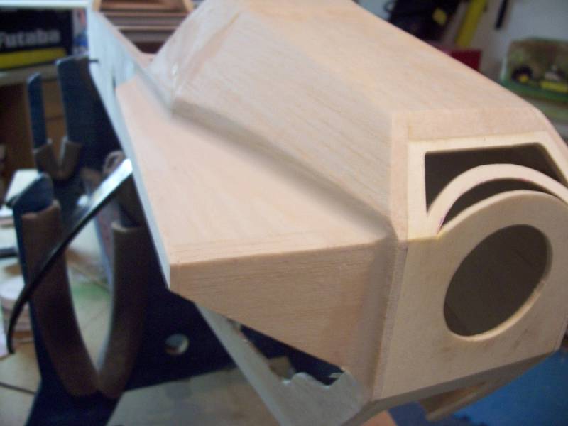

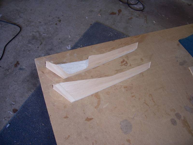

After a very long week at work I finally got back to John's Insight.......phew.
I have the wing panels finally ready to for finishing. These panels will be sent to Jim S. today for glassing and paint (yes, the wings will be painted).
The cheeks have been rough sanded after capping each end. I also cutout the right cheek to allow clearance for the OS. After some measuring and such, I marked where I wanted the cheek placement. I used polyurethane (very sparingly) and taped them in place. When cured I will cap the outside edges and start sanding and filling all necessary areas on the fuse.

Please-----may I ask-----Why quite so many bolts for the landing gear plate?
I've never had a problem with the bolts holding, it has always been the landing gear rotating aft from the drag of landing and taking off from grass. (Assuming I'm using a split gear arrangement)
Not sure how many pics I will get of the finishing process, but I did stop by today and visit.... The glassing is underway on the wings, ailerons and elevators. Jim does beautiful (see finish pic of his latest work), yet very light finishing work using a very straightforward process. This process will be documented (briefly) in an upcoming K-factor.
p.s. - third pic is Jim's R/C workshop supervisor.
