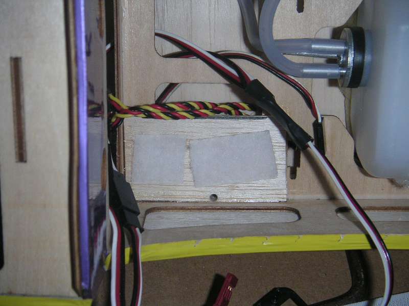

Old 05-25-2005 | 03:27 PM
  #37
Joined: Sep 2003
Posts: 1,828
Default RE: Flair/Jamara Leo Build...
I have fitted foam underneath the tank,
the velcro is very strong.
I have also fitted the RX and servos:
I have covered one of the holes wiht 2/32" balsa,
but a small whole on it, stuck some velcro (self sticky)
on the RX and Blasa, and used a cable tie for
safety.

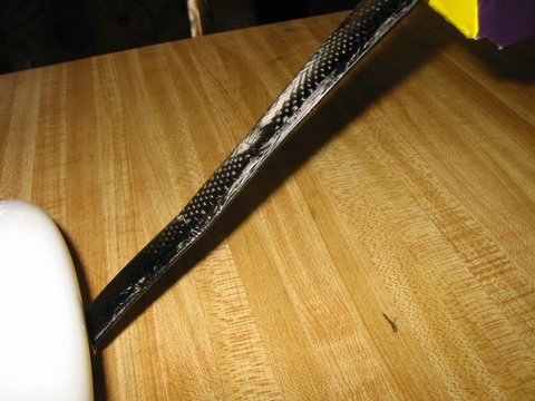

Old 06-02-2005 | 08:15 PM
  #49
Posts: 176
From: Palm Bay, FL
It is nice to see someone else has taken a chance on the Leo.
The latest problem that I have encountered is a junk port landing gear strut. The plane spent its entire life in a building cradle untill last weekend. What a surprise. The left wing tip rested on the ground.
Does anyone have a left strut that they don't need?
If I can figure out how to post pictures I will do so.
AW

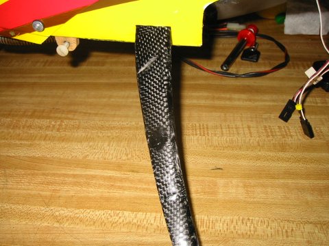

Old 06-02-2005 | 08:18 PM
  #50
Posts: 176
From: Palm Bay, FL
More:
Lets see what happened!
AW
