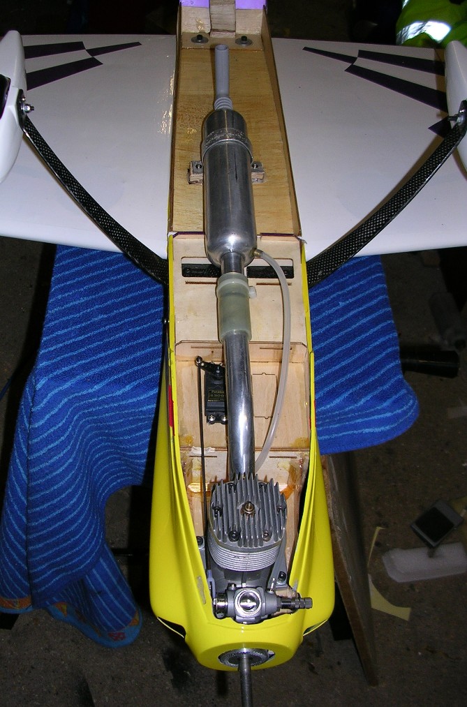

Got the business end all sorted. Cowling/belly pan needed slight trimming to allow carb and needle to fit. I have had to make my own pipe mount, and I've also install another belly pan screw to help keep it secure.
Only problem i've found is that the spinner i've bought will not close together around the 14" APC prop because the prop's too thick. Any ideas?
Dave
ps. anyone flying one of these at the moment? would like to hear what it's like to fly, any inflight shots would be good to see.

The TT120RP should give you all the vertical you want, please keep us informed how the engine perform.
Is it the only 120 2-stroke rear exhaust engine in the market ?
What prop size are you using 14x10 14x12 ?
Thick propellers and small spinners can be a problem.
Why not try a 15 or 16 prop, 14 seems to be a little small for that power plant.

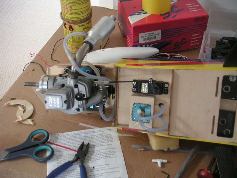

Here is the latest with mine:
Engine fitted, with all tubing, servo, and
iron bay fuel regulator, which I made a mount for
from 10mm ply
Old 07-05-2005 | 02:53 PM
  #72
Joined: Sep 2003
Posts: 1,828
Default RE: Flair/Jamara Leo Build...
As you can see from that photo dave,
the front bit of my mount also fell off.

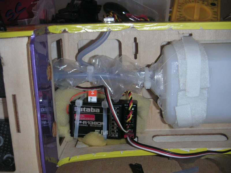

I wrapped my fuel tank, and lines in cling film
Then CAed a plastic bag around it!
Need to also re-fix my RX

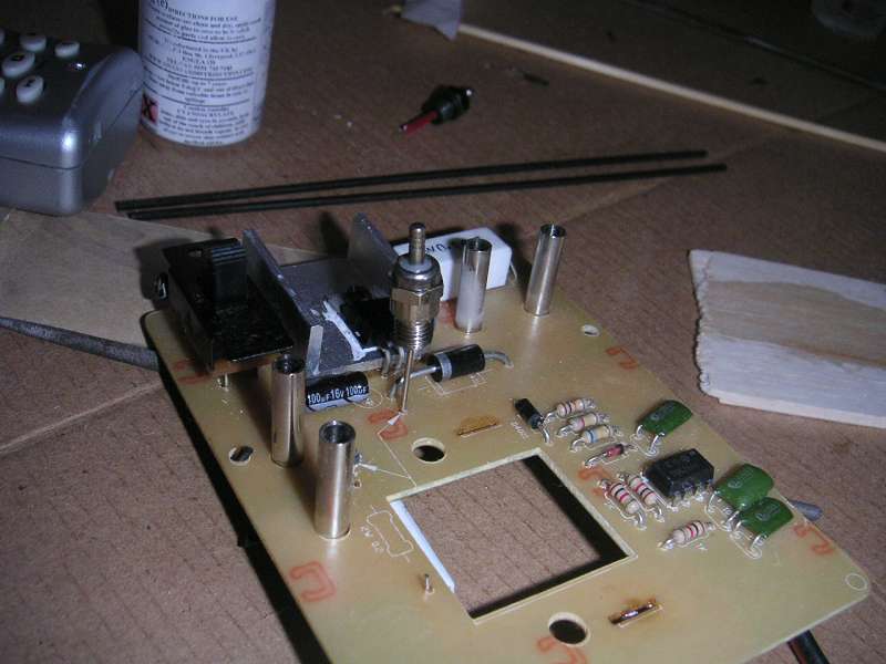

now i built myself a remote glow from an old pump panel.
Dony call me cheap
ID:	293967   Click image for larger version
ID:	293968   Click image for larger version

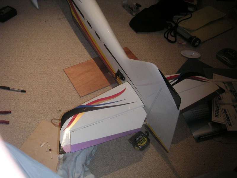

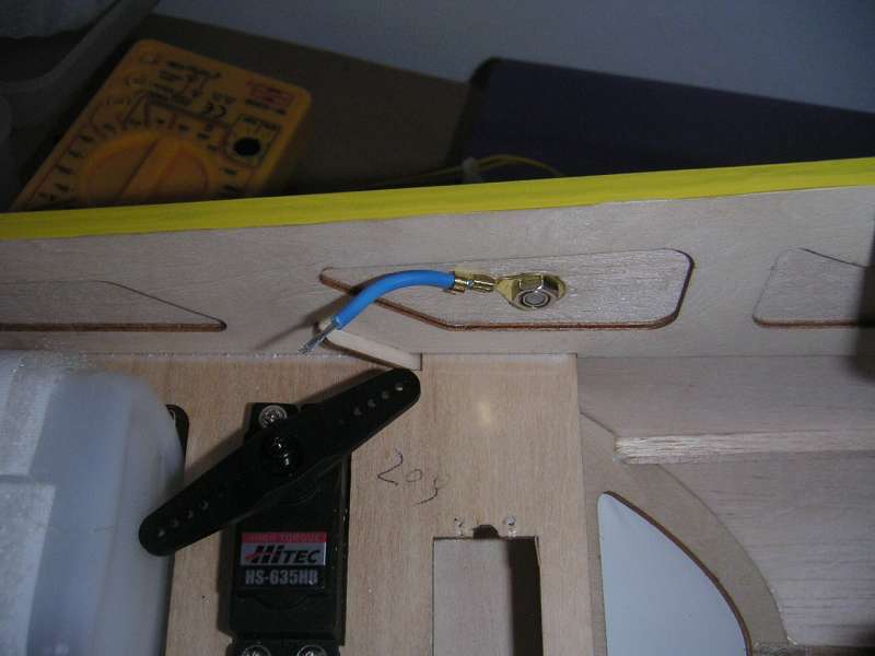

Ive had alot of trobule with interferance.....
We think its sorted now....
Here are the latest pics....
note modified ele servos.
