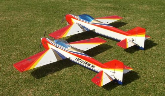

First off, it is exactly the same design and high quality finish as its larger sibling. Here are some shots of the 50 sized compared to my mates 90 sized version.

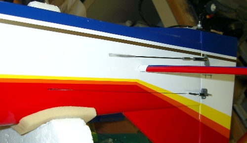

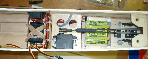

First to the insides and control linkages. It comes with 'standard' small model approach of a single servo tray with the two servos side by side and pushrod with 'V' split at the back for the elevators. Much as it probably doesnt make a huge difference on a smaller model, I happened to have a DEPS setup out of a 2m model that met an untimely end that was easily cut down to size. So I set about separating the rudder and elevator servos and putting them on separate trays so the linkages were centred. Given the location of the stringers and construction of the fuz this was easier than I thought.
The battery pack between them is just for receiver/servos. It needs to be back here as the motor batteries sit right up in the cowl for easy access. Given it is a one piece wing I wanted the motor batteries easily accessible without having to take off the wing.
Here are the insides and the control linkage exits.

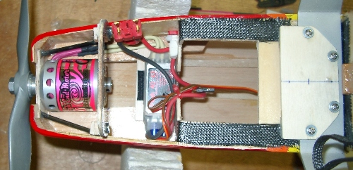

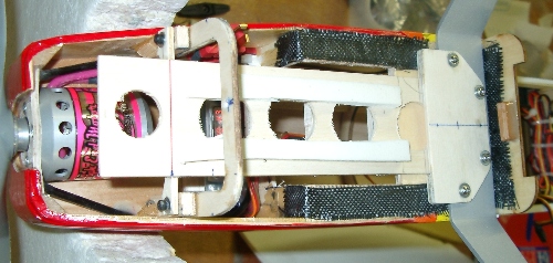

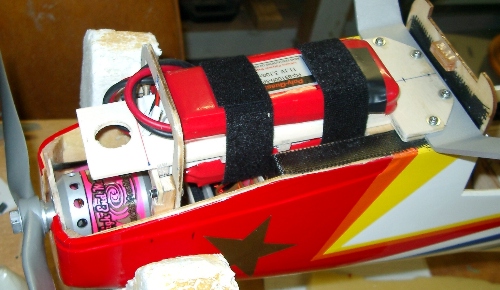

As a starting point I went for the Electronic Model Twister 60 outrunner and 40 Amp speed controller. On paper this should put a 13 x 6 at close to 10,000 rpm on 6s1p 3,100 cells -- ample for a 50 sized model.
As with others, to run a 13 inch prop and fly off grass, I dremeled out the wheel spats and put in 2.75" wheels, and mounted them as far down the gear legs as possible.
Up the front I did some reinforcing of the nose plate and the motor bolted in neatly. After experimenting with balance points I built a frame below the motor to hold the 2 x 3s 3,100 packs. This all came together neatly and fitted well within the cowl.

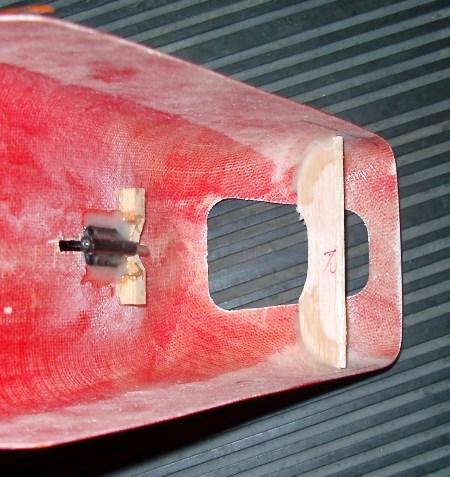

At which stage the torque became a bit much for the engine mounting plate and any idea of test flying was postponed while repairs were made.

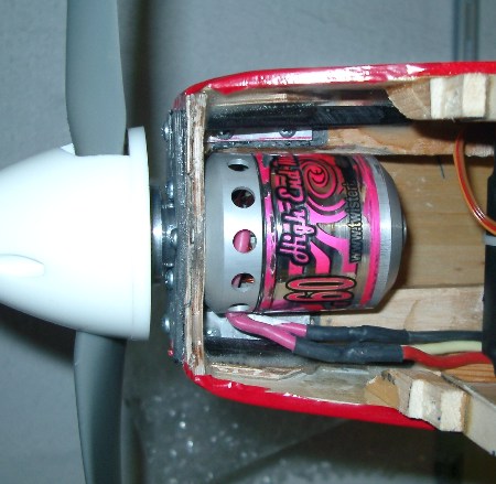

I struggled with the motor mount for a while (meaning I replaced it and it came straight out again, then did it again so it didn't come out, and it delaminated the ply plate it was screwed to!)

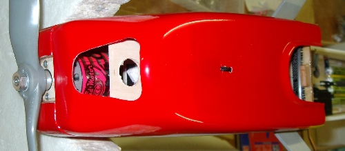

The final install has aluminium brackets running through the nose plate, and screwed firmly to the motor mount bearers, and a 2mm carbon fibre plate in front ensuring nothing can move, along with additional screws and lots of focus on a good epoxy joint all round. You can see the changes in the photos below compared to the earlier one.
I also opened up the opening in the front of the cowl and put in a baffle to split an air stream to aim straight at the motor while leaving the balance to flow over the batteries and out (both through the bottom of the cowl, but also out through the fairing under the wing).
