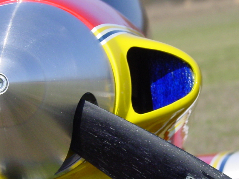

I of the guys over here has revolutionized (pun intended) his typical OS bearing problem fix.
Fed up of having to replace bearing after bearing, he's placed a small air intake on top of the cowl, directly above the crank/ brearing.
Goodbye bearing problem... hello hundreds of flights.
It was that simple.
It was that simple.

Hello bla bla,
could you explain more in detail where you put the air intake? Have you tried this on other engines (this would be a GREAT solution!)?
Thank you for sharing your ideas.
Cooling the crankcase area and as such the bearings is a good idea. In 2-c's and all the YS's except the DZ you also get a better charge going to the piston. You can get more power by cooling the bottom of the crankcase. A lightened backplate spinner with big prop cut -outs helps. Air-dams/diverters seem to be the most effective.
As a datapoint, my engines run at around 78F in the lower crankcase area now that they are cooled.
Some sample pictures. Quest-2 with side and top cutouts. Temptation and Impact with side diverters. Used 1/16" balsa that clears the engne movement on the hydemount.
Regards,
Eric.
Regards,
Eric.

My above post should read from the first sentence, "One of the guys... " just to set the record or my bad typing straight!
Yes well, no real Voodoo science here. Air intake directly above the crank/bearing casting... starting, say from 1cm back from the spinner.
Forces the air over the hot spot, down around the cylinder and out the pipe tunnel. The biggy is that it's position's on top! Side intakes do basically nothing to assist cooling unless the engine is mounted horizontally... which isn't the case with our's. They're more like drag inducing inlets than cooling inlets.
I'm doing the mod' to a new airplane at the moment. Found an old glass wheel pant, cut of a suitably curved part... cut a nice hole in the cowl area above the crank, stick on the part, blend it in and spray it up. Sounds horrible? It's isn't anywhere near as big as you'd imagine by reading the discription!
Thing is, it all makes a lot of sense. We're burying these high performance, inverted engines, deep inside a streamlined cowl and behind a giant spinner! Sure they're going to get warm. The fact the many folks are gaining sucess by adding some head shins to lower the compression, thus reduced the heat... just enforces the point.
We've been burning out the bearing!
