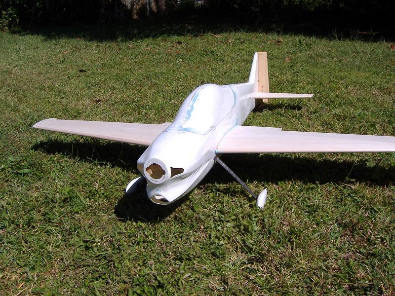

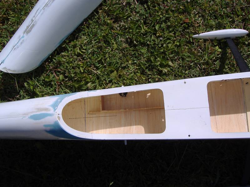

ID:	545878   Click image for larger version
ID:	545879   Click image for larger version

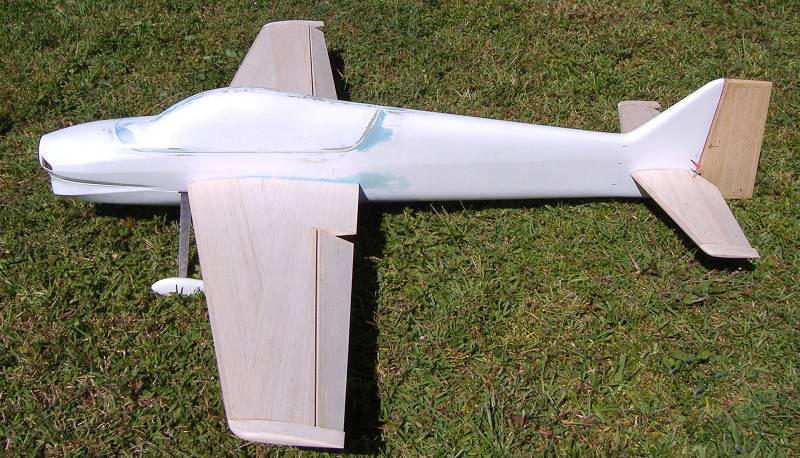

Kit build photos, 2/2.
ID:	545882   Click image for larger version
ID:	545883   Click image for larger version

Grotto2,
What landing gear used on the Genesis in the pictures?
Mark
Old 10-22-2006 | 07:20 PM
  #221
grotto2's Avatar
Joined: Feb 2003
Posts: 1,046
From: Palm Bay, FL
Default RE: Genesis ARF build, its here.
ESD Carbon Fiber Fixed Landing Gear A #ESDLG $69.80
from Central Hobbies. They're almost a dead-on match, slightly taller and wider than the originals.
-Ron
Old 10-23-2006 | 05:35 AM
  #222
Joined: Apr 2005
Posts: 18
From: Port of Spain, TRINIDAD AND TOBAGO
Thanks Ron,
Did you have to cut the chin cowl to accommodate the gussets on the ES gear?
Mark
Old 10-23-2006 | 07:18 AM
  #223
grotto2's Avatar
Joined: Feb 2003
Posts: 1,046
From: Palm Bay, FL
Nope. I cut the gear in half and they fit just fine!
-Ron
