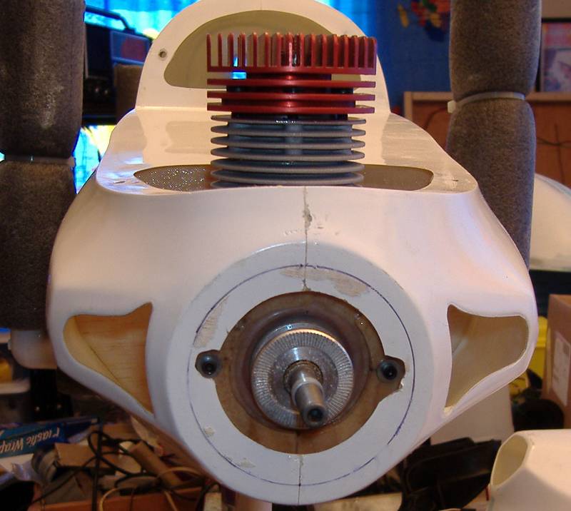

Hi guys! I am building my Genesis ARF and have one quick question. The firwall is made of balsa laminated with glass. I know that ply will have to be installed for the blind nuts to hols to. But do I have to install hardwood dowelsall the way through the the firewall so the balsa will not be crushed or is the firewall stone enough as it is so all I have to install are plywood plates for the locknuts? Mike, what did you do with yours? Thanks a lot.

I made a hardwood ring out of 3/32 ply and lightened it up pretty good. I think there is a pic of it earlier in the thread... . I just epoxied it to the backside of the firewall when I finally installed it and snugged up the socket head bolts in the blind nuts.. I used a lockwasher in the hyde mount and I didnt over tighten, just good and snug. I didnt at all get the sense that the firewall was crushed even a little.... I used a T handle socket head wrench to tighten them and it has worked out well through approximately 30 flights. I wouldnt think it would hurt to install a few dowels the thinkness of the balsa around the perimeter of where the shim will ride on the firewall, but I really dont think its necessary if you dont overtighten the motor mount bolts.

I didnt save mine. It was pretty easy to make. I just cut a circle and then bored the hold for the nosering. Then I just used my belt sander to whittle away at the top and bottom until I had a perfect fit. Once you get the fit you want then you can trim away the excess on the sides so that it doesnt show in the cheeks. Once I had it built I painted mine black, you cant even see it in there.
It has held up perfectly to the 1.60DZ's lope really well so far..
There are some pictures of the general shape at the beginning of this thread.

Your answer actually tells me a lot, Mike.
I made a removeable section shaped roughly like a Central Hobbies or Dave Brown nose ring and I was working on a template for the fixed portion. The problem is that if you put the fixed portion far enough forward to not show in the air intakes you will need some standoffs or something to reach the removeable section. The whole thing wouldn't be sturdy enough IMHO.
I'll take the shape in your photo and see if I can cut clearance for my Webra's carb. I usually make a balsa mock-up before cutting out real wood.
#196
Oh, probably stating the obvious here but I had the motor mount and motor installed and the actual central hobbies nosering mount screwed to the nose ring frame while I shaped it. I also had everything installed when I glued it in so I could get perfect centering.
My nosering sits about 1/4" back from the inside of the nose, there are 1/4 balsa spacers at 2 points at the top and bottom that align the nosering properly against the front of the fuse and set the distance back. I used a mixture of 20 minute epoxy and microballoons to secure it in there. Its not coming out, ever. And it came out light. [8D]
Once it was all done I could not get the Central Hobbies nose ring in and out since its width is a little greater than the hole on the fuse and 1/4 wasnt enough to tilt it to slide it out,,,, so I just dremeled out on each side just enough to give it a clean exit.

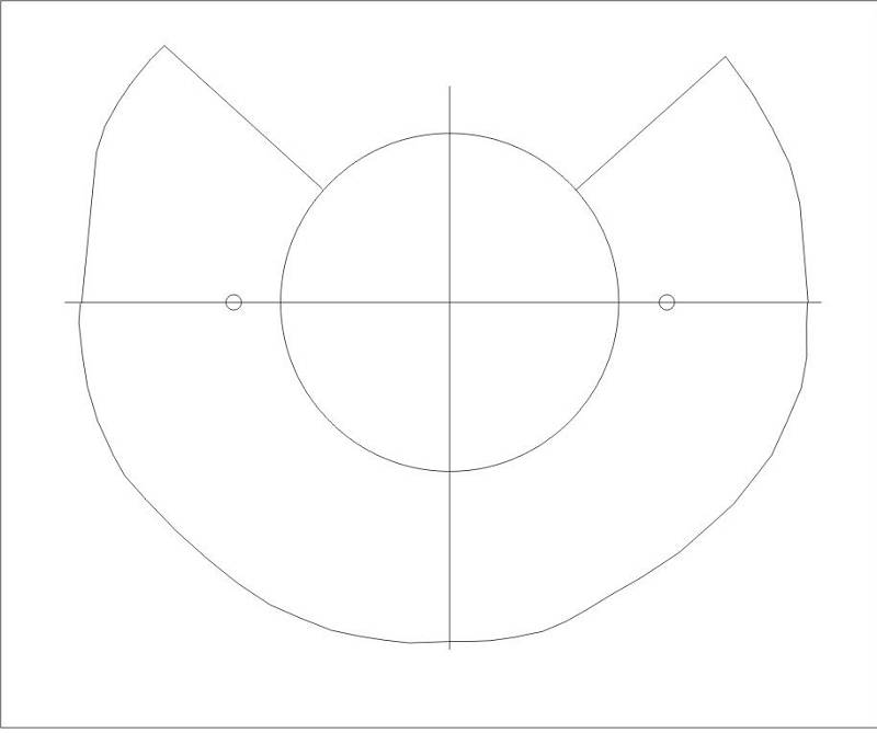

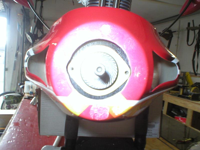

After going through a couple of evenings of hell, I came up with my own nose ring. Since I was dealing with a 2-stroke, I had my own set of problems and the nose ring for a 4-stroke wouldn't fit. Anyway, here are the results.
The two pieces are made from 1/8" fiberglass-covered end-grain balsa, but plywood would work just fine. The bumper is made from a 113mm of medium fuel tubing split lengthwise.
The front of the holder is pushed right up against the front of the air intake hole on the left side. On the right side, it's back 1/8" and the gap is filled with scrap. After smoothing down with a Dremel and some sandpaper, it really doesn't look too bad.
If anyone has scaling problems with the drawings, the nose ring is 2.75x2.1 inches and the holder is 3.8 inches wide.
Excuse the hacked out holes for the screw access. I didn't have a chance to clean it up before I took the picture!
-Ron
