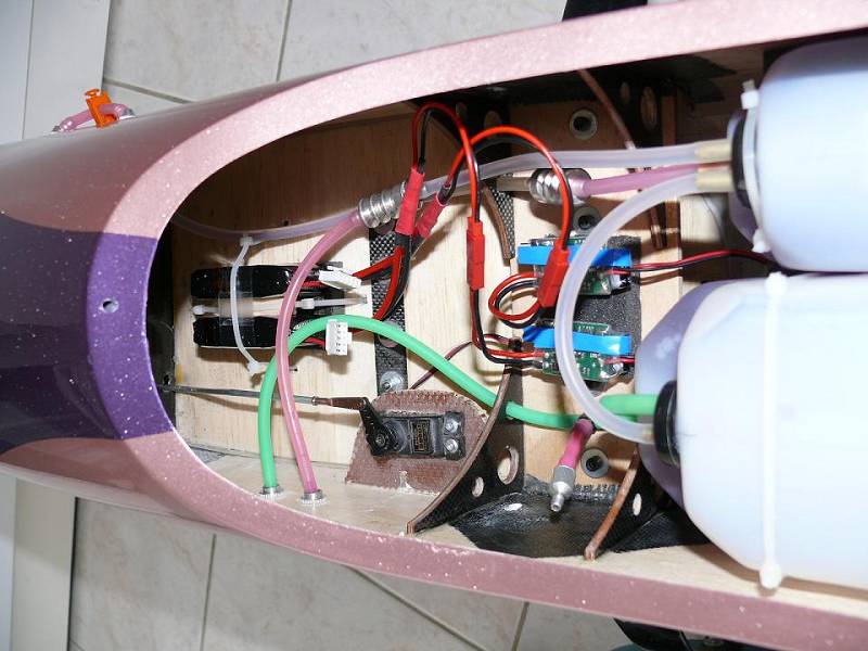

Hello
Nose ring is this piece we see on this pic.

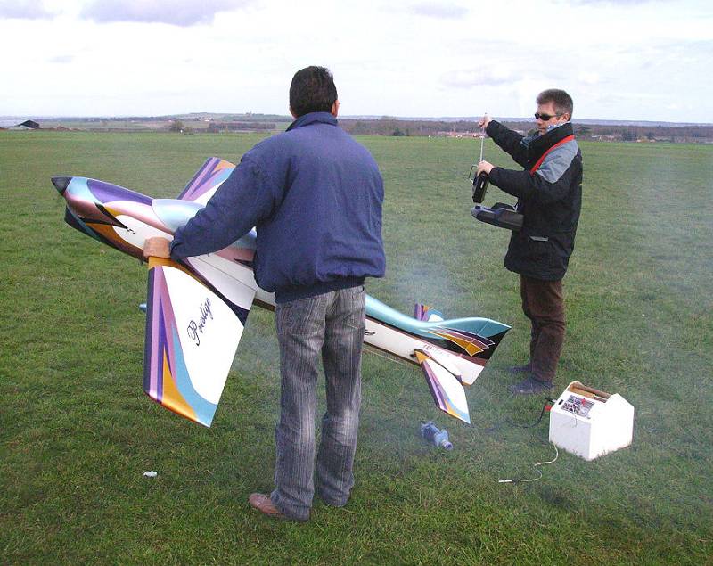

Hello
Laurent Matysiak did first flights of Prestige on saturday.
He told me that it was awesome. Prestige is equiped with Yamada 160 DZ, propeller APC 16x12 and Cool Power 30 %.
No mix rudder /aileron , just a little mix rudder / elevator (4 % Futaba transmitter) for knife edge. He put inverse differential on ailerons 14 mm up and 16 mm down
as Wistmodel (Prestige builder) adviced him.
Incidence stab = 0, incidence wings = 0.5 deg.
Laurent is the guy with black glasses and his friend Dominique is carrying the plane.
